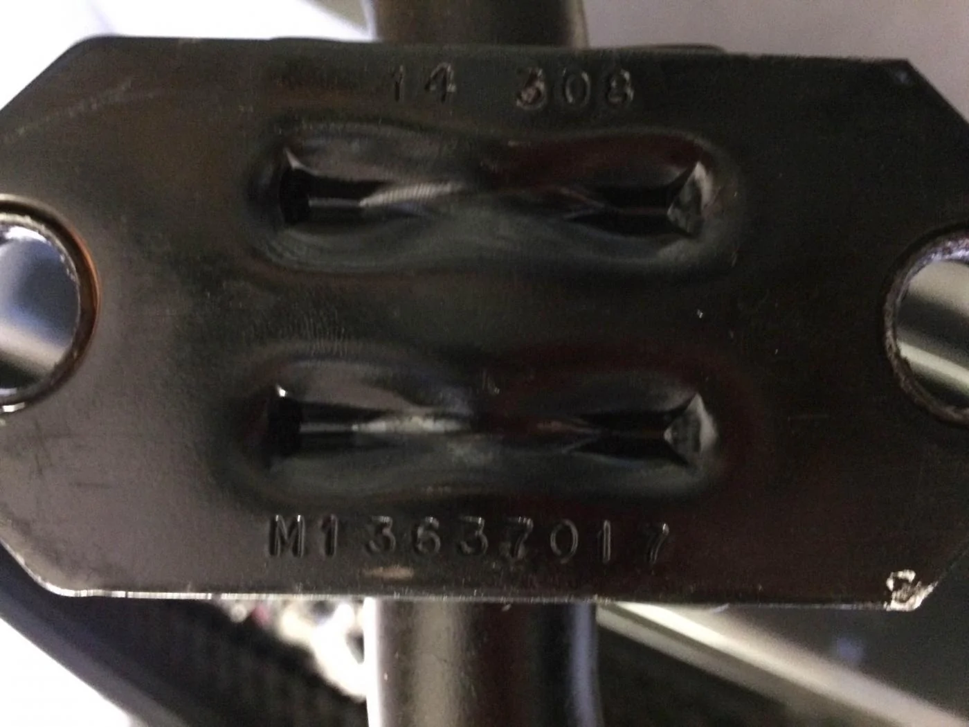

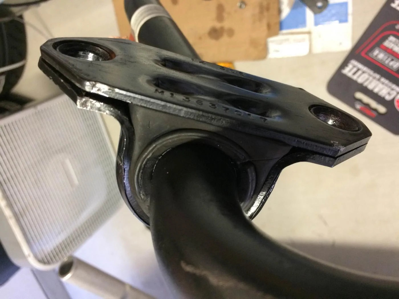

Pics of the finished project:

So what is the point of putting a hole in the sway bar further towards the front of the car if you are going to relocated the endlinks even closer to the new hole you just made?
So that they stay vertical to the bar and the bar stays horizontal to the pivot point. In the rear if you use an adjustable bar (like most aftermarket ones) you might need an adjustable end link to keep the bar horizontal depending on the hole you select.
Moving the hole in the bar increases the roll stiffness. Moving the end link on the strut makes sure it acts completely in the vertical direction as it does in the stock location.

I struggled with trying to drill the holess while the bar was still mounted on the car. I found a few long extensions allowed the anti sway bar mounts to be loosened from the top.
I removed r/s wheel and found bar removal quite easy with a bit of fiddling. I used professional quality drill bits in drill press and it still took quite a bit of effort. I have added the BMR end links. I have the rear Eibach bar in center position. Car feels great. Good turn in, less roll, controlled oversteer when exiting corner under power.

So going back to the guy who couldn't rotate his bar to drill it, I found the same problem. I notice he has a PP car and some others are non-PP cars. Are the front sway bar bushings on the PP cars different? I took my bar out and the front bushings appear to be presssed in, I tried for a little while and couldn't not get the damn things to move at all, even after lube!!
