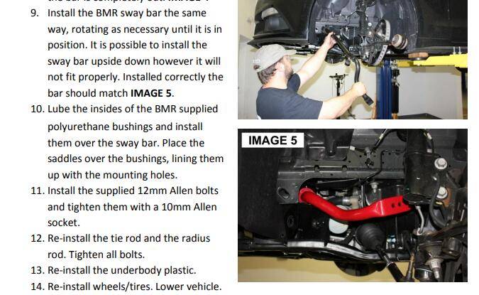

I've recently installed BMR Front sway bar SB044 on my '21 mustang gt pp. I'm posting because I'm genuinely confused as to how this sway bar should be positioned. Everywhere I see online, all sway bars are installed with their ends pointing up. However, looking at the instructions for this one, their photo shows them pointing down.
I'm having fitment issues with the end links touching the struts because of this, and some clunking as well. Because I track this car, I'd really like everything to be installed correctly.
This is what their instructions say:
As you can see, they're pointing down, and that's how my sway bar is currently installed. I e-mailed them to check and they said it should be pointing down:

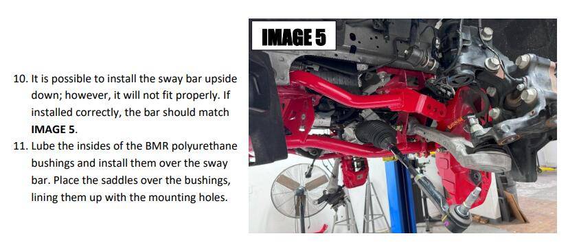

However, another instructional PDF with the same sway bar model shows them pointing up here:
It looks like they revised the sway bars when the 2018 facelift came out, however it's effectively the same bar and same model number.

The BMR instructions say pretty clearly that the bar should match the photo. Does yours?
regardless of how the end of the bar points up or down, they all bend upwards at that first elbow. - old style BMR, new style BMR and Steeda. Yeah the new style BMR bends down after that, but that's fine if BMR says its fine.
They aren't some retailer who doesn't know the product, they designed it, they know what they're doing.
