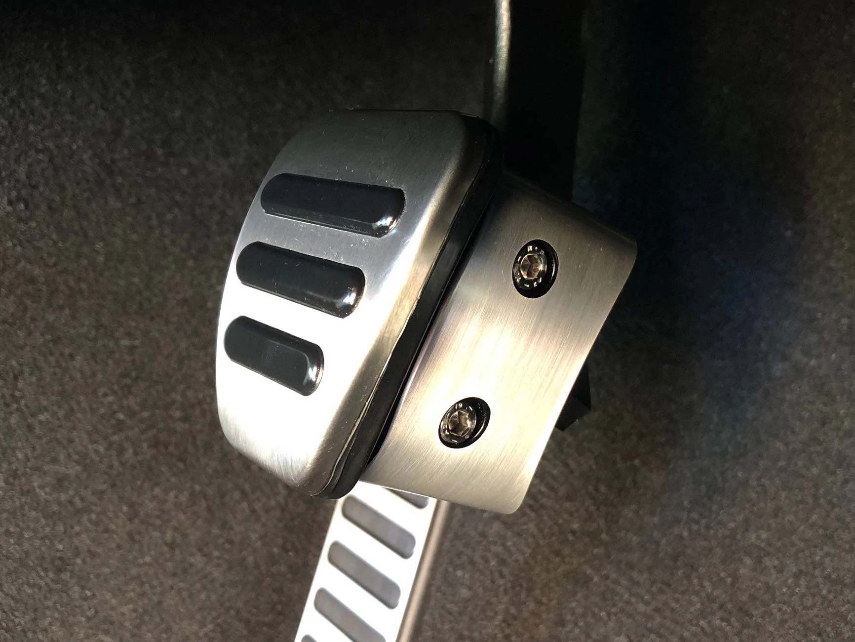

Okay.. I seem to have an issue replacing my clutch pedal cover with the original after taking off the clutch pedal extender. What’s the trick? this stupid ….is beyond irritating.
I hate stuff that should be simple, that isn’t.

Yep, heat the F out of it! It was a PITA for me.

Great idea with the hot water. I expounded on it as I looked over at my heat gun. Voila. I trimmed the pedal molding because there were some inconsistencies, added some pool lube and ran a tiny screwdriver around the edge. Finally..Thanks guys. :thumbsup:Crazy.

I used a pick to pull the rubber to fit on the pedal.
Definitely a PITA.

Hot water and profanities worked well for me - and a towel over the rocker to make it more comfy :like:

Thanks..,forgot the towel..great idea! . I paid for the lack thereof.……
