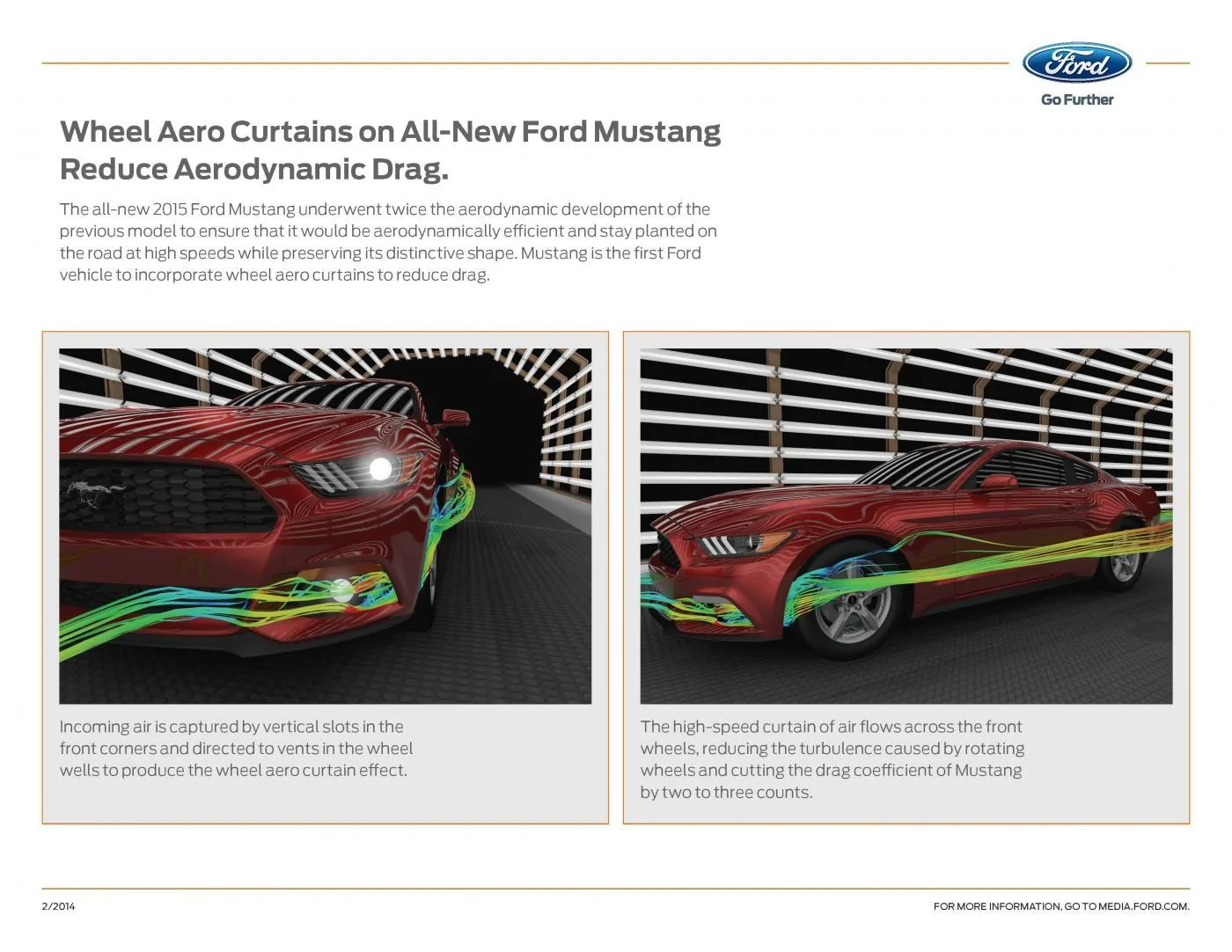

So as the title says, I'm kinda freaking out. This morning while I was driving past the Mustang (since I still use the GTi as my DD) I noticed something weird.
At the bottom of the front bumper, just between the fog lights and the edge of the bumper, there's a gap. It's on both sides of the front. Is this a panel alignment problem? Or these are vents to cool the brakes? Someone confirm please if you have these on your cars.

Aero vents. All is well.
(edit: they're designed to carry air from that area out past the wheels to reduce drag.)

Thanks! I'm a bit of a noob when it comes to performance cars, and even though I thought they looked like functional vents, I was still freaking out since I wasn't sure.
BTW I found this diagram published by Ford explaining the Aero Curtains and how they work.

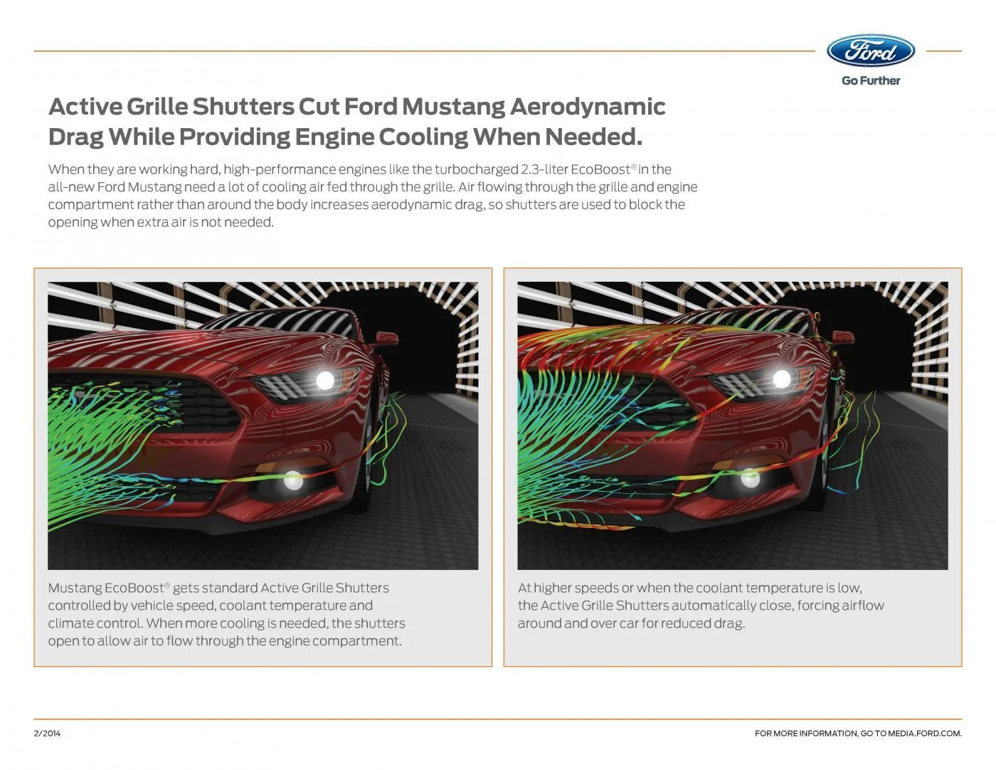

I keep meaning to strap a go pro to the front grill (facing inward) so I can see the active shutters open and close. Maybe this weekend......
