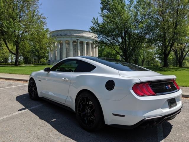

Looks like I had a typo...meant to type: FR3 instead of FP3. You have the right link. You can actually buy the kit in different stages, I bought the entry stage so just the shocks/struts/springs...you can add Ford's sway bars to the kit also, but I wanted the Steeda rear drag sway, and haven't yet seen the need to swap out the base front sway bar because my set up is mostly for 1/4 mile drag racing and cruising around town on the weekend. Starting with a soft base suspension and going the direction I took was a big jump, the car is night and day now...but starting from PP level I cannot comment on as a driver, only from ride's in friends PP cars over time. You might wanna look at all Steeda parts if you wanna go above and beyond what Ford offers. Or BMR stuff...both are the best in suspension stuff if you ask me. I stuck with Ford for the struts/shocks and springs because I wanted a certain ride height....lowered, but only a bit, not as much as most people want or like. The y springs I used dropped the front 1.25" and the rear .75" and gave my car a tiny bit of front to back rake (rear just a bit higher) that I wanted.
