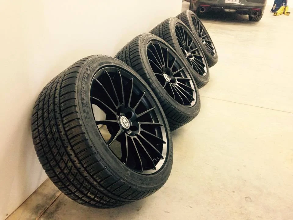

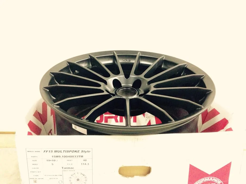

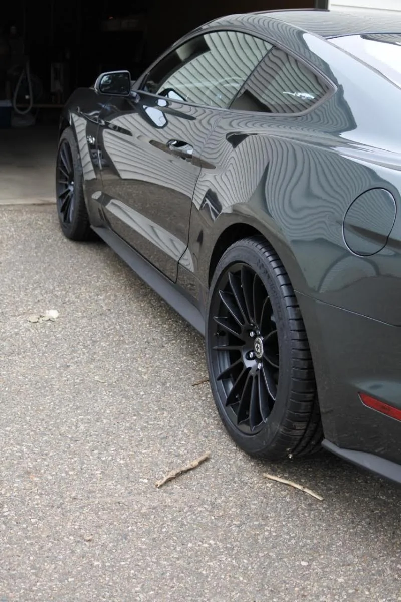

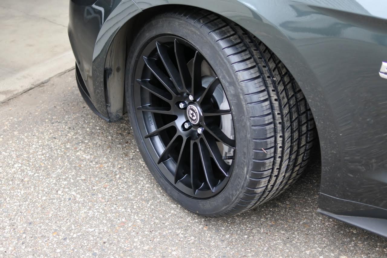

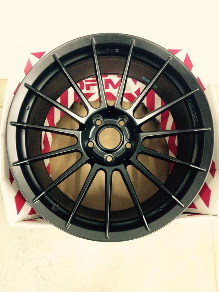

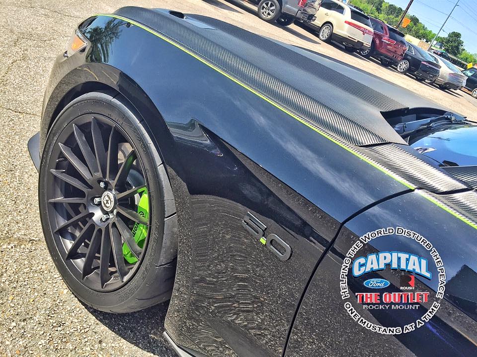

Another good option is the HRE FF15's which run as a square 19x10 setup or you can run staggered at 19x10 front and 19x11 rears. Fitment is spot on as well. Tire sizes for that I would run 285/35 and 305/35 (at a minimum). We've ran 275/35 and 325/30 Nitto Invos with good success as well.
Any questions at all on HRE's just give us a shout:)

the staggered is the way I would like to go. 19X11 on the rear would be meaty... I love it. do you have a link to look at different rims for that setup?

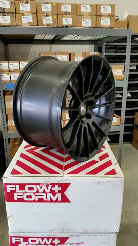

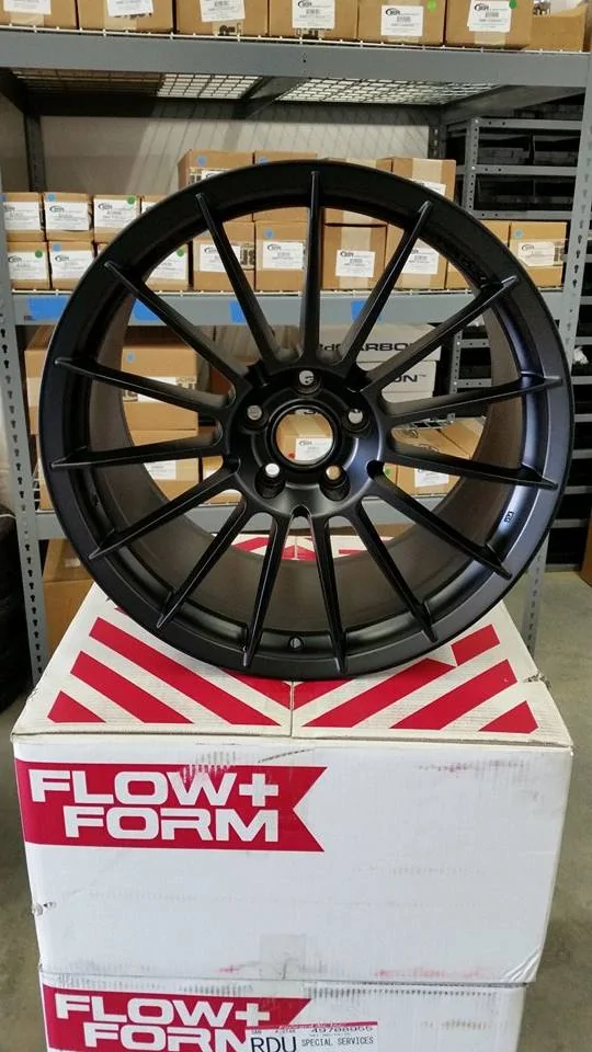

I would recommend the MRR M350 wheels rotory forged light weight 19"
19x10
19x11
easily fit a 275/305 tire combination on there no rubbing with the drop and they come in gloss black standard finish !
