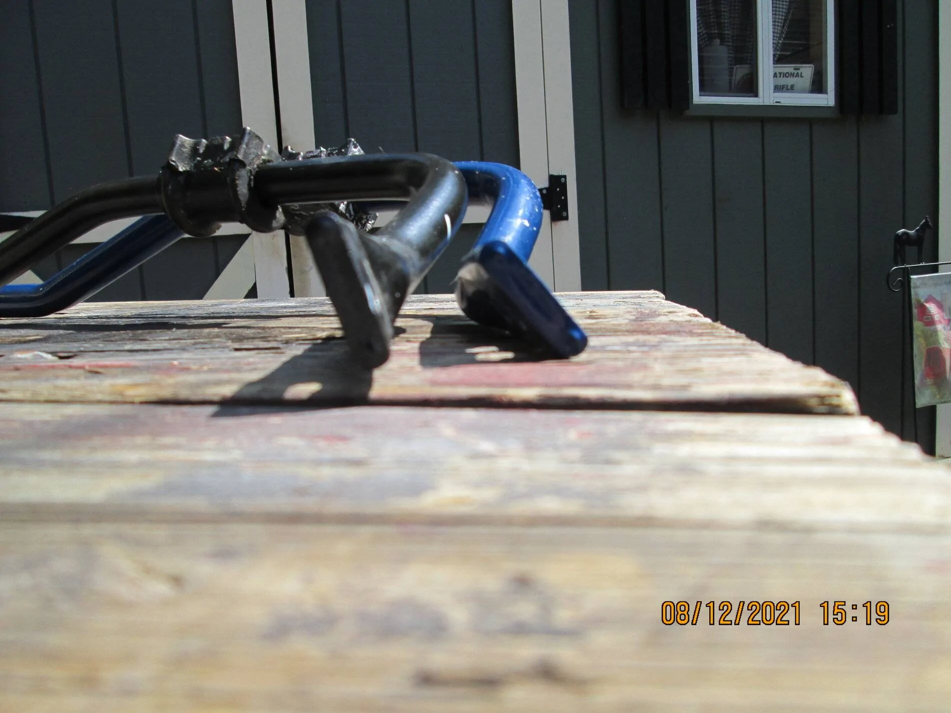

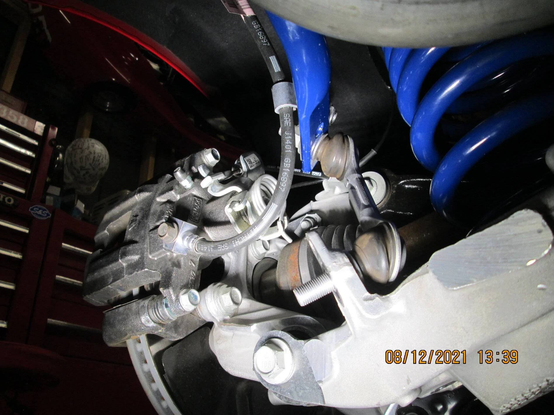

This does not feel or look right. The angle of the end links is maxxed out. The angle of the "ears" on the sway is way different then my stock PP1 rear sway. Stock is closer to vertical. I'm talkin' there is no swivel left period on the links. Pretty disappointed. Unless you guys say otherwise, the stock PP1 bar is going back in.

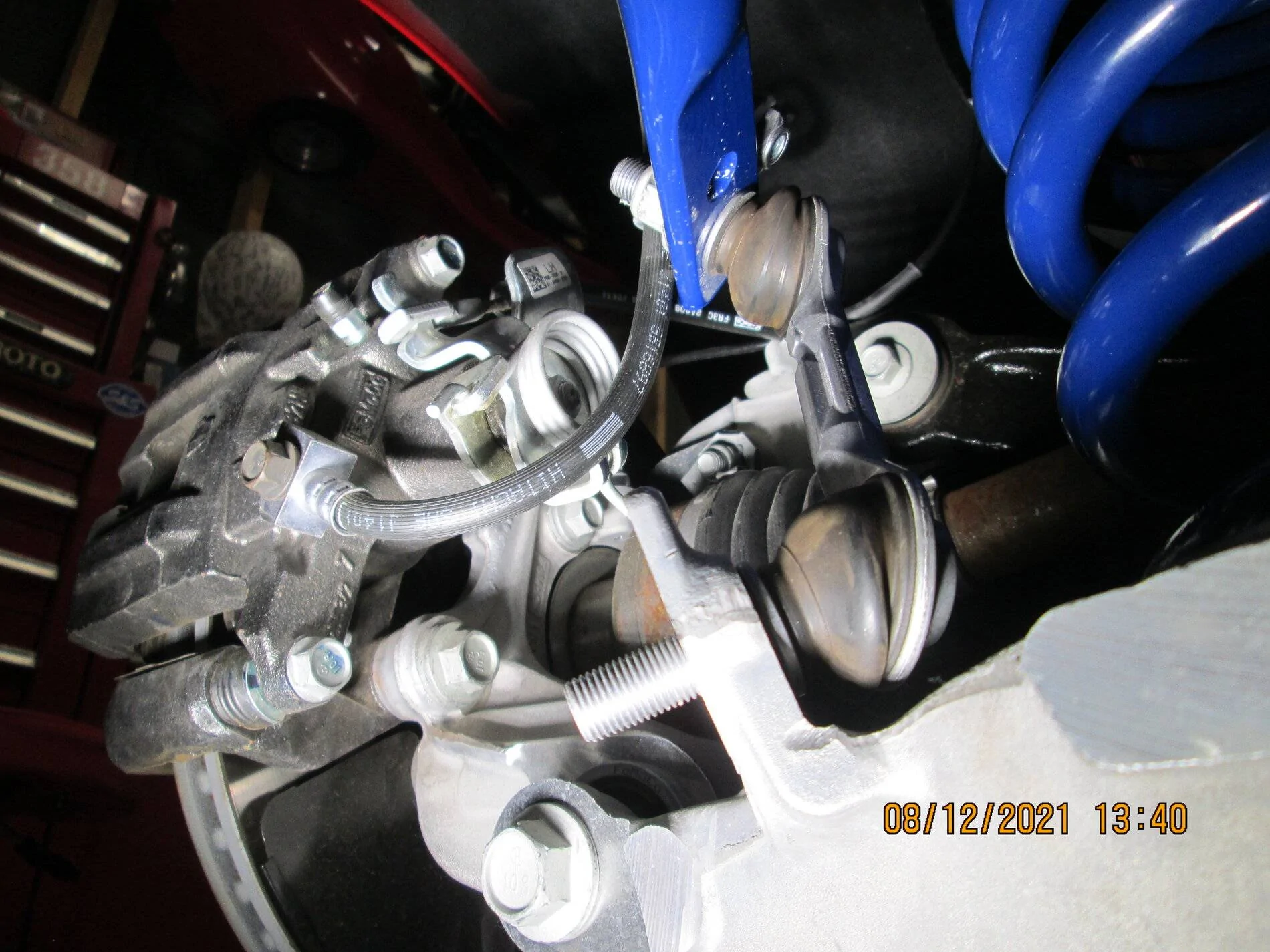

Another shot. Not even close. One of the main reasons I went for the Ford package was for exact fitment. What a joke.

I'm old enough to know about some of the poor fitment and quality of aftermarket parts. Can't understand how this could happen with genuine Ford products. Funny how all the BMR stuff I put on fit perfect. Can somebody chime in here?

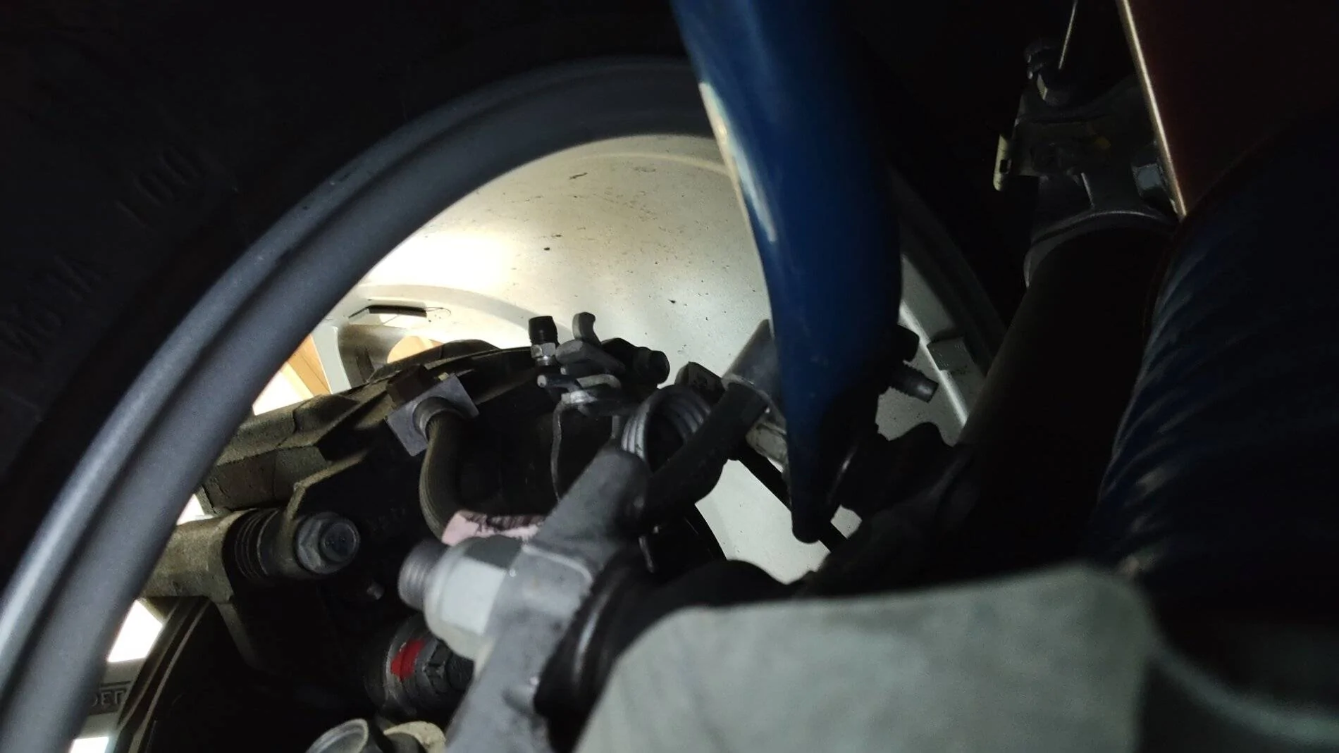

Saw your PM, mine was installed by a professional installer that works on Porsche s, Ferrari's and other highend cars. Here is the best photo I could come up with as the car isn't on a lift.

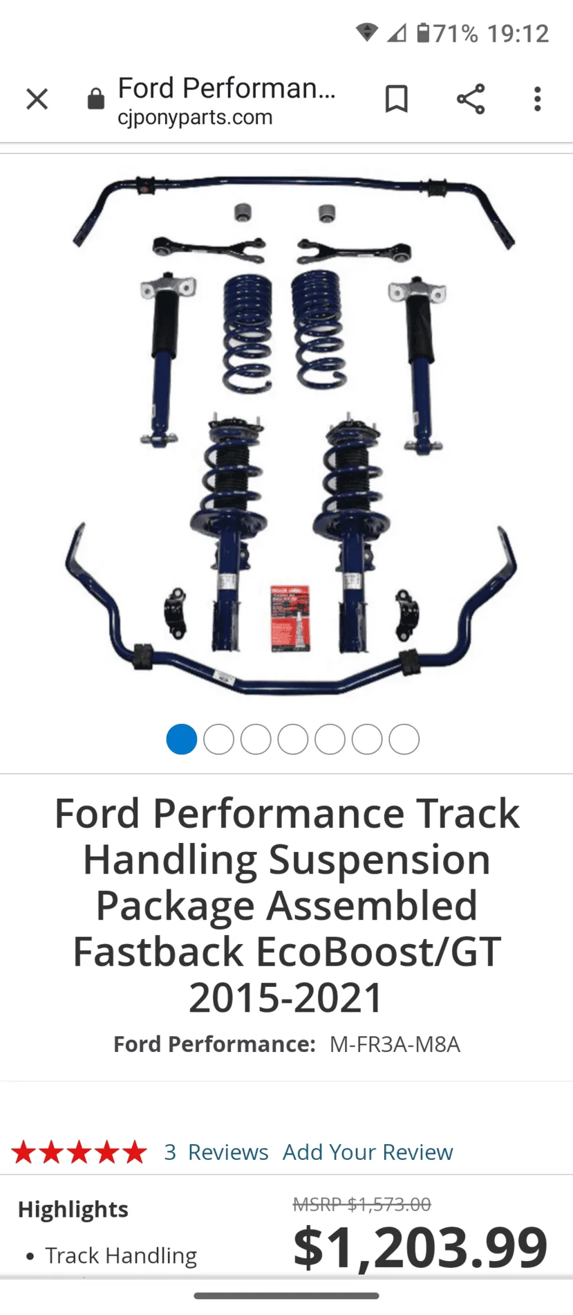

What is the Ford Performance part # on that kit?

Unless it goes in opposite of the stock bar than no, it's not upside down. As you can see in the pic on the bench, orientated the same way the bend is off quite a bit. Also, same kit # as above.

Yes. Exact same problem. Now what?

Ditch the POS OEM end links and get some Steeda adjustable end links.
