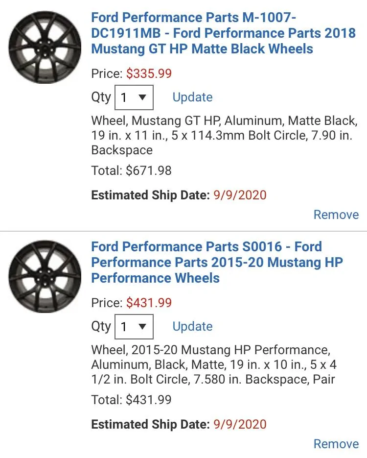

Does anyone know what the difference is on these wheels? Obviously the sizing and offset but the part#’s are way different. I want to go 19x10” up front and 19x11” in the back and this is the closest I’ve gone since SVE is no longer producing at the moment.
To run these 19x10 front you will need 15-20mm spacers.
19x9.5 need no spacers
