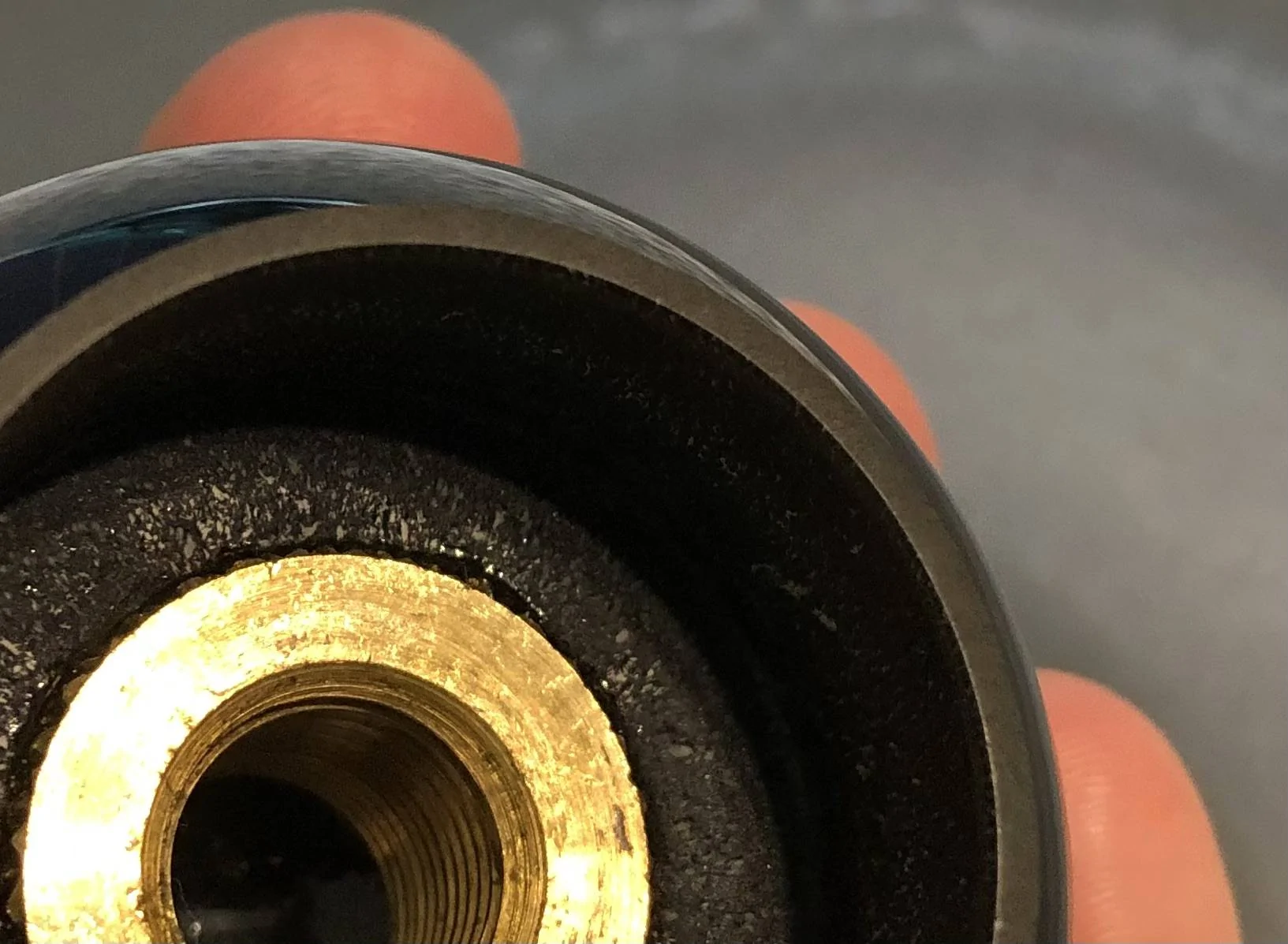

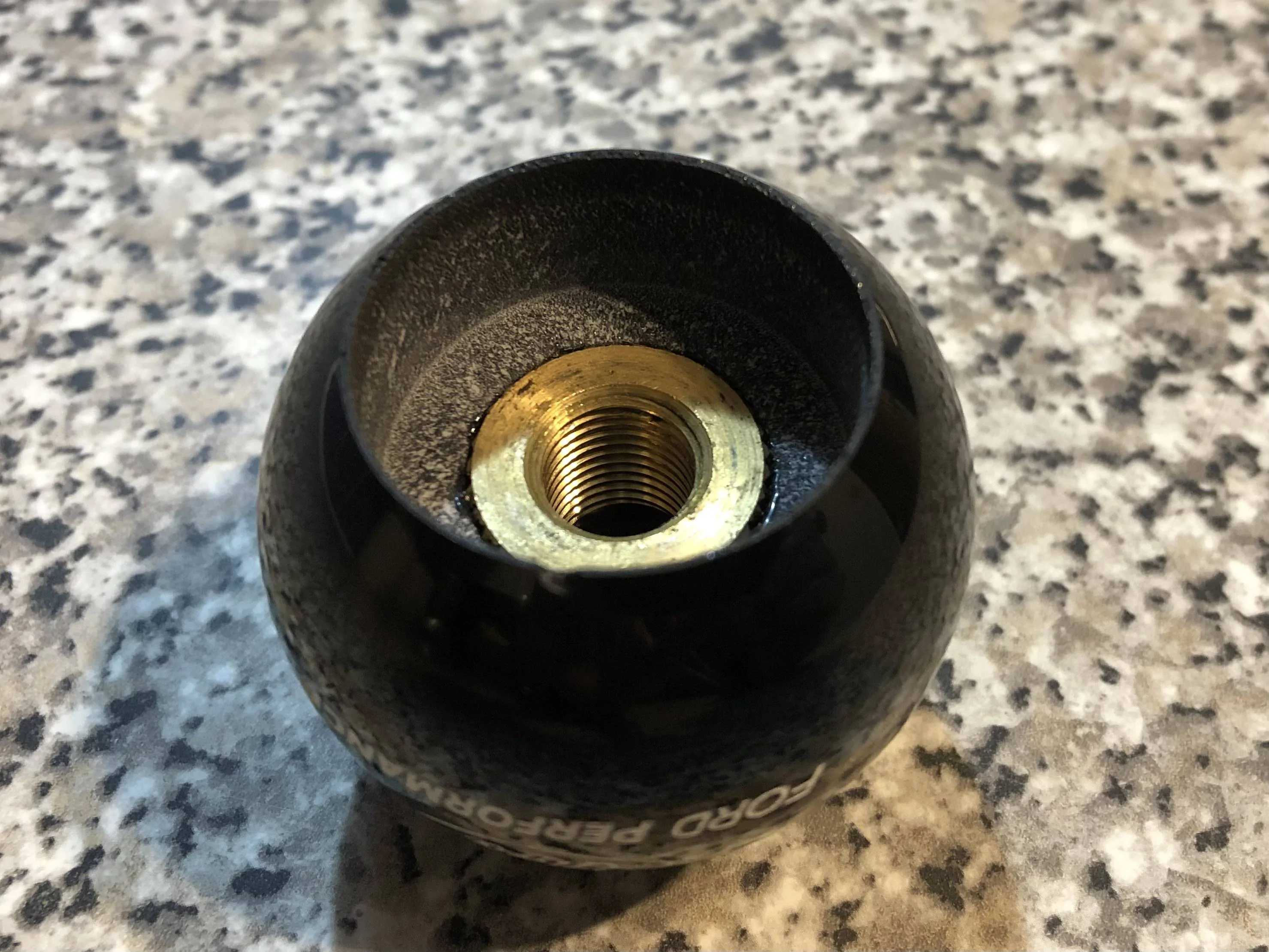

I know you shouldn’t have too, but the rough underside is a very easy fix.
I’m not sure how you would fix your other issues though … :frown:

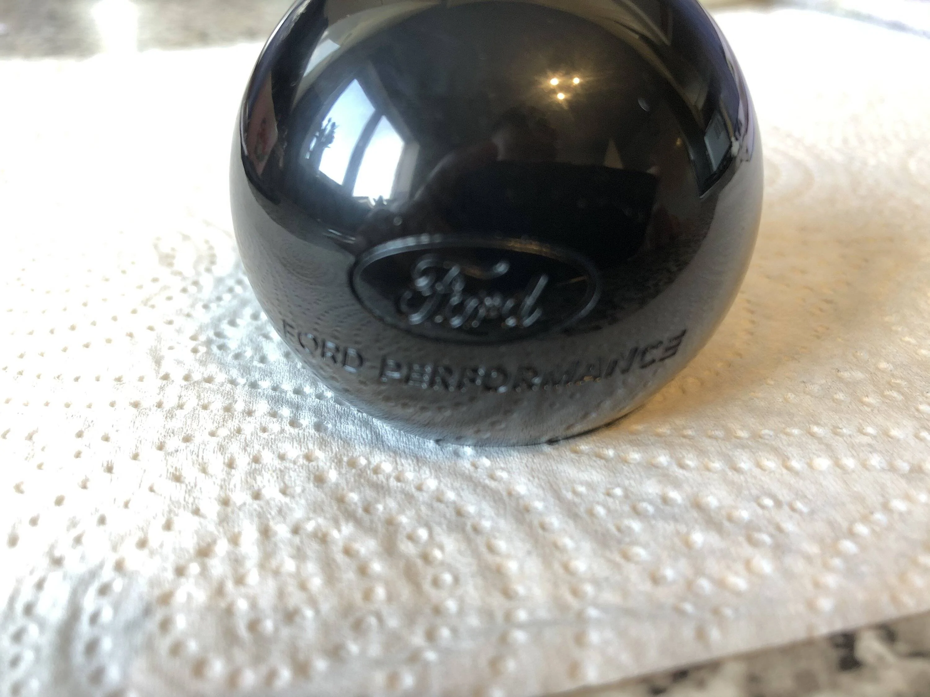

I didn’t photo it, but my Ford Performance knob had the base issue and had an all overall ā€˜unpolished’ almost ā€˜used’ appearance straight out of the OE box from Ford.
I wasn’t particularly concerned as I was colour coding it, but you can see the dull finish here :
Look at the reflection of the ceiling lights and the swirls :
The swirls clean up really well and very easily by hand using Meguiars scratch x.
The base issue is sorted by placing a piece of wet n dry (I used 1500’s) on a flat worktop and just rubbing the knob on it with even strokes.
When it’s all done :

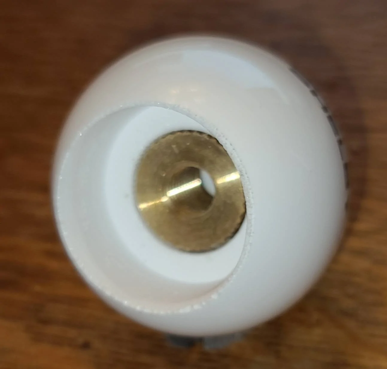

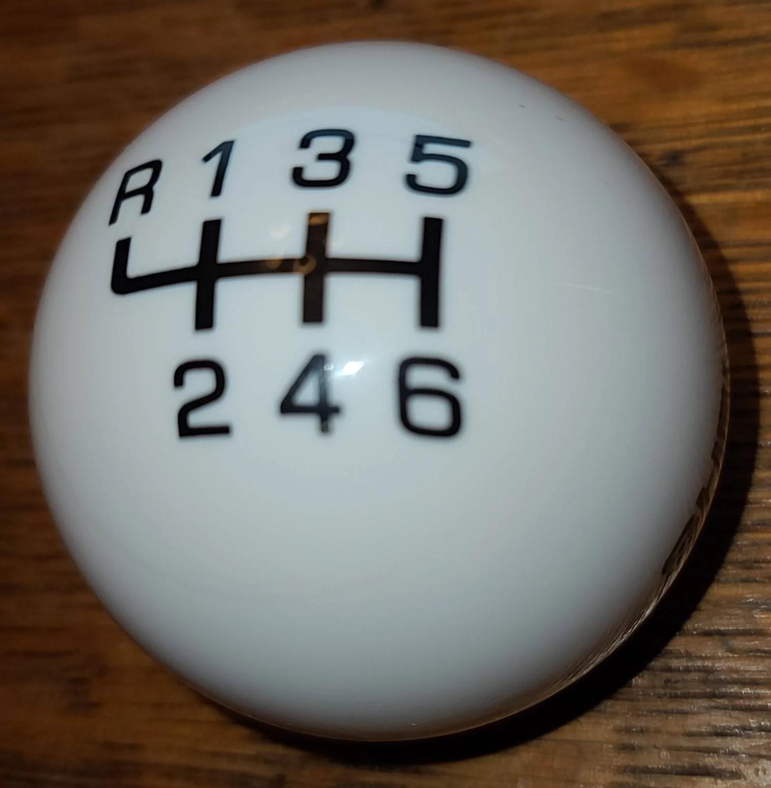

So I’ve decided to enhance my knob polishing skills … :giggle:
I’ve picked up a bit of a winter project, but I figured the first step might come in useful here :like:

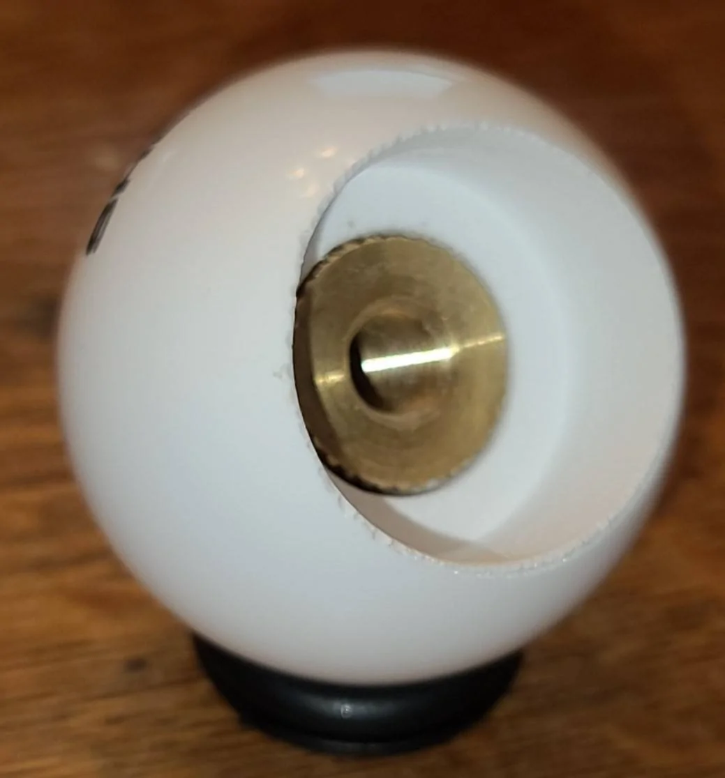

My new to me / second hand off the forum knob came with an additional chip :
And the typical poor finish around the base (although this one is better than I remember mine being) :
After a quick rub on some wet n dry :
I measured before and after and I had to take 0.95mm off to remove the chip - if it was just the rough finish, I guess about 0.25mm would have easily done it :like:
I’m aware that it could make hiding the top of the reverse collar a bit more tricky, but I think the knobs probably have larger tolerances that might affect that fit (like the depth of the relief and the start position of the thread on the insert compared to the one on the shaft etc).
My recollection of the first knob I did though is that it ended up with a bigger flat - but that one still fits my car / covers the reverse collar perfectly.
The size of the flat won’t really matter for this project anyway though :like:
