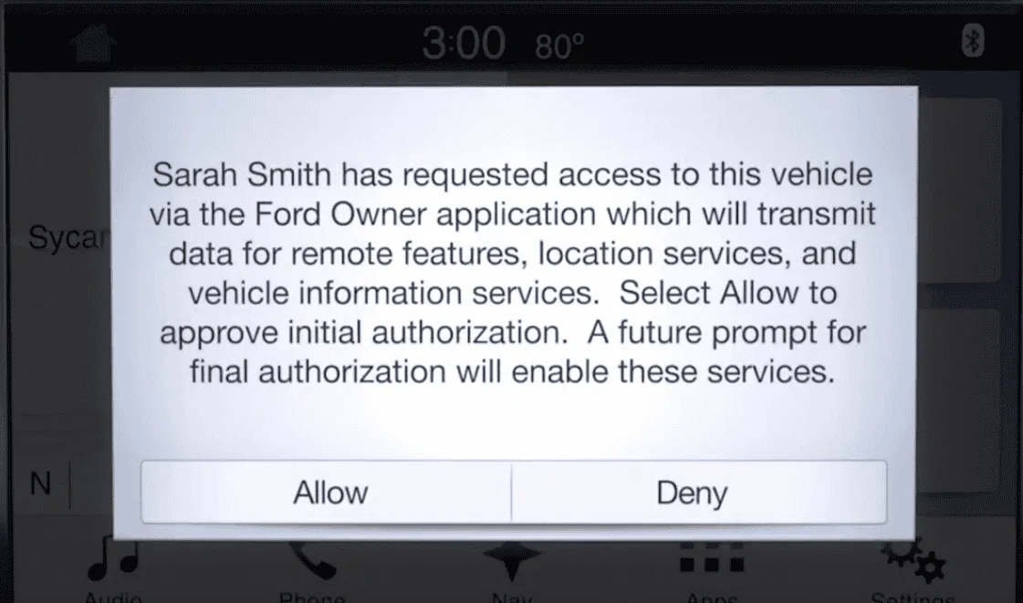

On my 2018 Mustang GT Premium I tried activating the Ford MyPass on my IPhone but for over 1/2 hour all I get is activation pending on my phone and nothing on the sync touch screen. Am I missing something or doing it wrong.

Im pretty sure you mean the second verification.. that will come on the screen after 24 hours

Technically, all 401A and 201A Premium 2018 Mustangs (with digital dash) have the Sync Connect modem standard. Some of the early window stickers did not show it. The new 2018 models will give you the authorization screen only once to activate it. If you have the Sync Connect feature and the 'activation pending' remains on the app screen, you may have to delete the vehicle and re-add it to the app. Or perform a master reset in the vehicle and try again.
