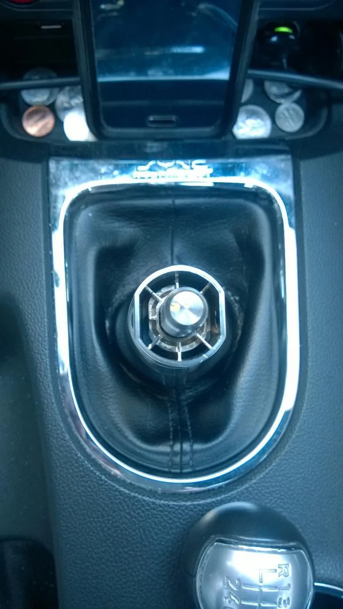

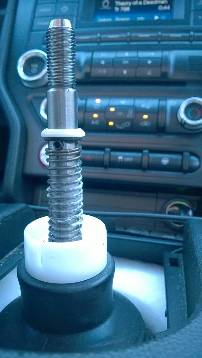

Maybe I'm dumber than I realize, but I can't find a solution anywhere... Hell, maybe it's "normal noise" for the car, I'm just too new to know it. :p
Agent,
Is there any known 'fix' for reverse gear lockout vibration/noise?
Under heavy acceleration from low RPM, or just at high RPMs, something makes an annoying rattle/grind kind of noise and lifting the reverse gear lockout is the only fix I have found.
Seen a few people start threads regarding it, but they never got responses.
Agent,
Probably missing the neoprene washer or it's not seated correctly on the shift lever. I'd be curious to see what the locket mechanism looked like after taking the shifter ball off. It's probably something extremely simple.
I've had it at the Dealer a couple times and they say it's nothing worrying, so I've just kinda accepted it. However, if it's potentially something stupidly easy, I'm all about that. :p
Just this view?
Thanks, Agent
