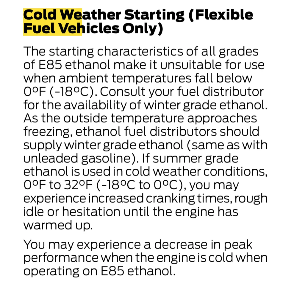

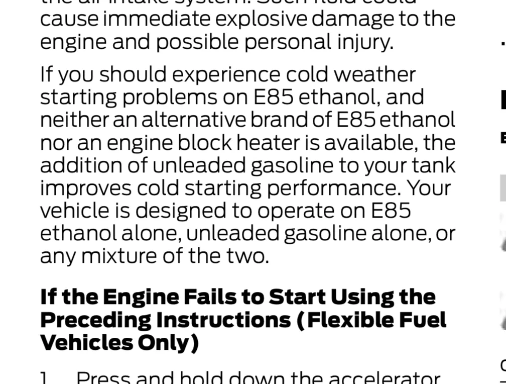

What's your definition of "cold weather"? The F150 owners manual has things about e85 and cold weather in some years of the manuals

Its only a hard crank on the flex tune, with the R tune it starts right up.
The tables required to "fix" the cold starting on a flex tune aren't available in the most popular tuning software, unfortunately.
As was explained to me its the flex tune being conservative with initial timing on a 12:1 compression engine.
I see now that the voodoo OS doesn't have the logic to change borderline timing as a function of ethanol content, so I stand corrected on that. On a Gen3+ you can get as aggressive as you want when it learns ethanol rather than relying just on knock advance to get the extra timing in. The flex logic in the voodoo basically just applies to the fuel delivery. On other OSIDs it can change all sorts of stuff like even load limits, fuel pressure, egt, etc.
Im going to venture a guess there's a few differences between an F150 coyote and a mustang coyote in regards to base timing and compression especially with the 5.2 that the requires a softer touch in regards to unknown ethanol content.
The F150 is also 12/1, but like I said, the entire borderline timing map can elevate as much as you want but only once it learns ethanol. The Gen3+ mustang OSID has all the same logic as the F150 available; its just turned off and uncalibrated. Unfortunately its just a shortcoming of the GT350 logic.
