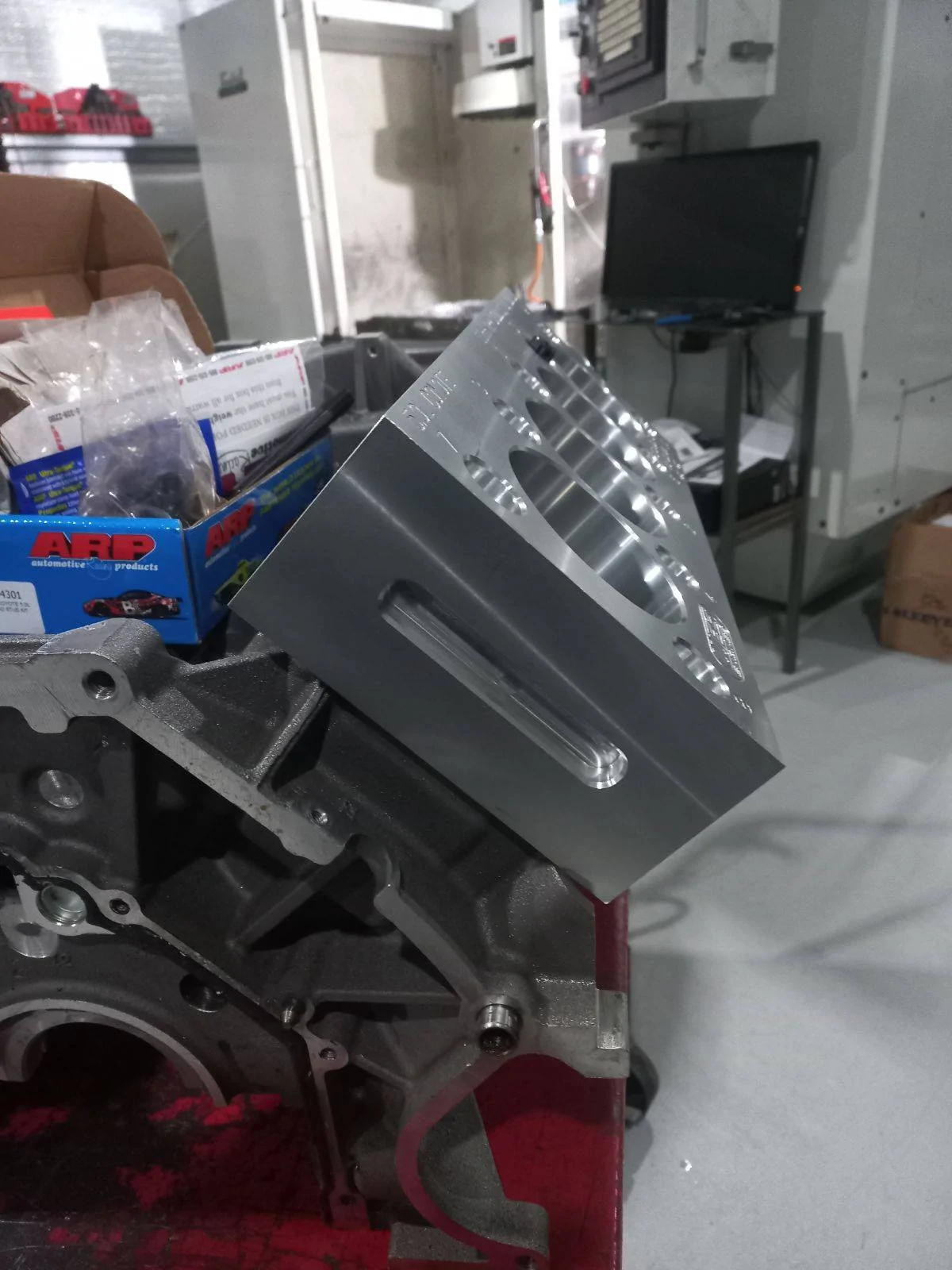

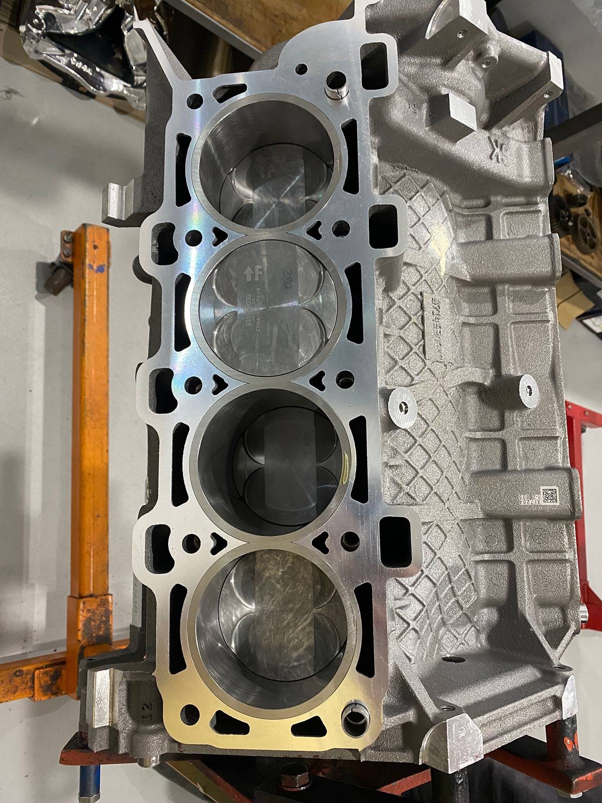

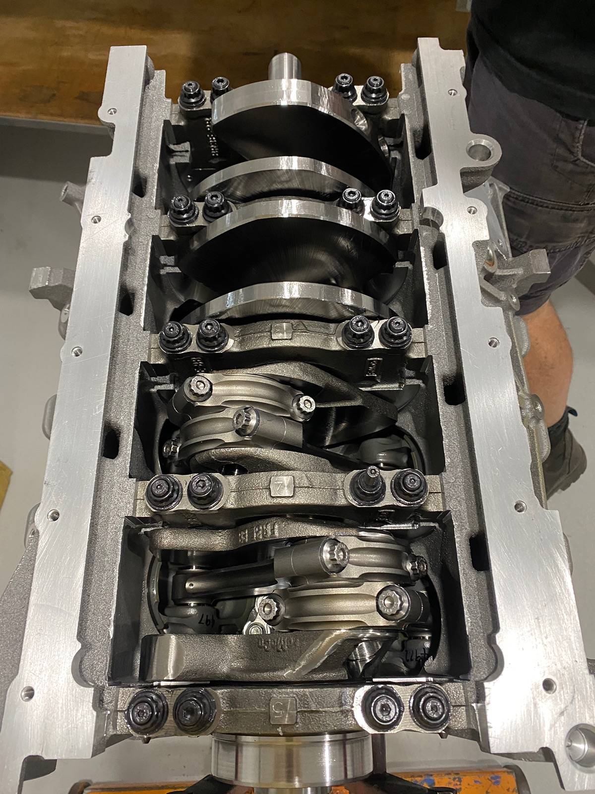

I’m embarking on this journey at the moment. i have a gen2 motor that I just picked up yesterday. Darton sleeved and built…Callie’s rods , m142P Mahle pistons , kept oil squirters ( which I wanted to do)
I left the engine short block build up to a pro , I’m mechanically minded but i felt clearances etc was out of my league.
He also made up a nice torque plate for final honing to get it perfect.
for me… doing it this way I ended up with a short block very similar to a TKM sleeved block , for less than half the price. I’m in australia and shipping , exchange rate and tax a TKM would cost me $25000 aud ($16000 USD)
my total “all parts“ and machining and assembly is $14500AUD ($9299usd)
to put that into perspective a gen3 aluminator short block in australia is $16000aud ($10300usd)
This is my first coyote , I’m enjoying the process And I do love learning about the car in all aspects.
ive redone the heads , lapped the valves and replaced seals etc.
so far nothing is rocket science. Just got to pay attention to detail..
I am a little nervous about timming etc , but everything else is fairly straight forward. Im replacing all the main hardware bolts with ARP… new ford performance phases , chains , guides , flip bracket , opg & crank , new boundary pump assembly.
its daunting at times , but as I’ll have this car for a long time the learning process will help me do anything to the car into the future.
