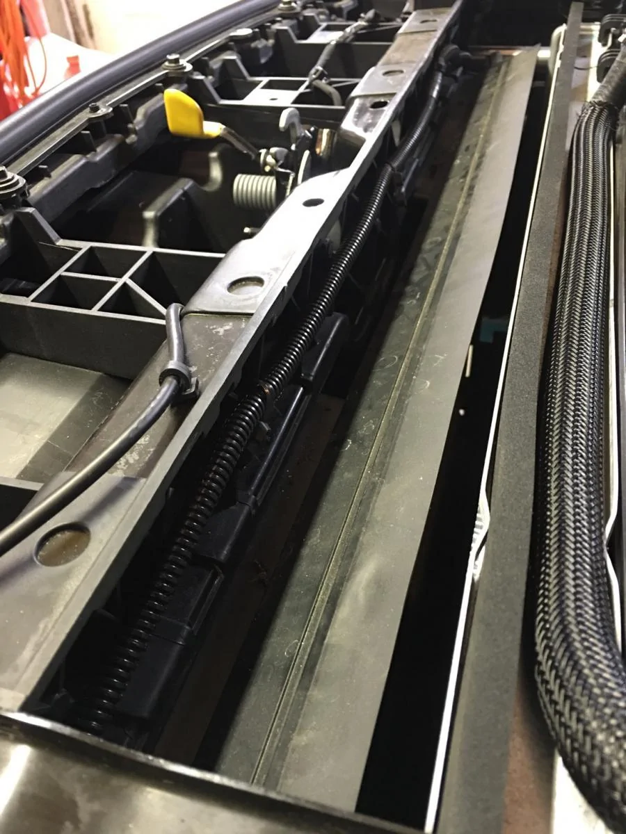

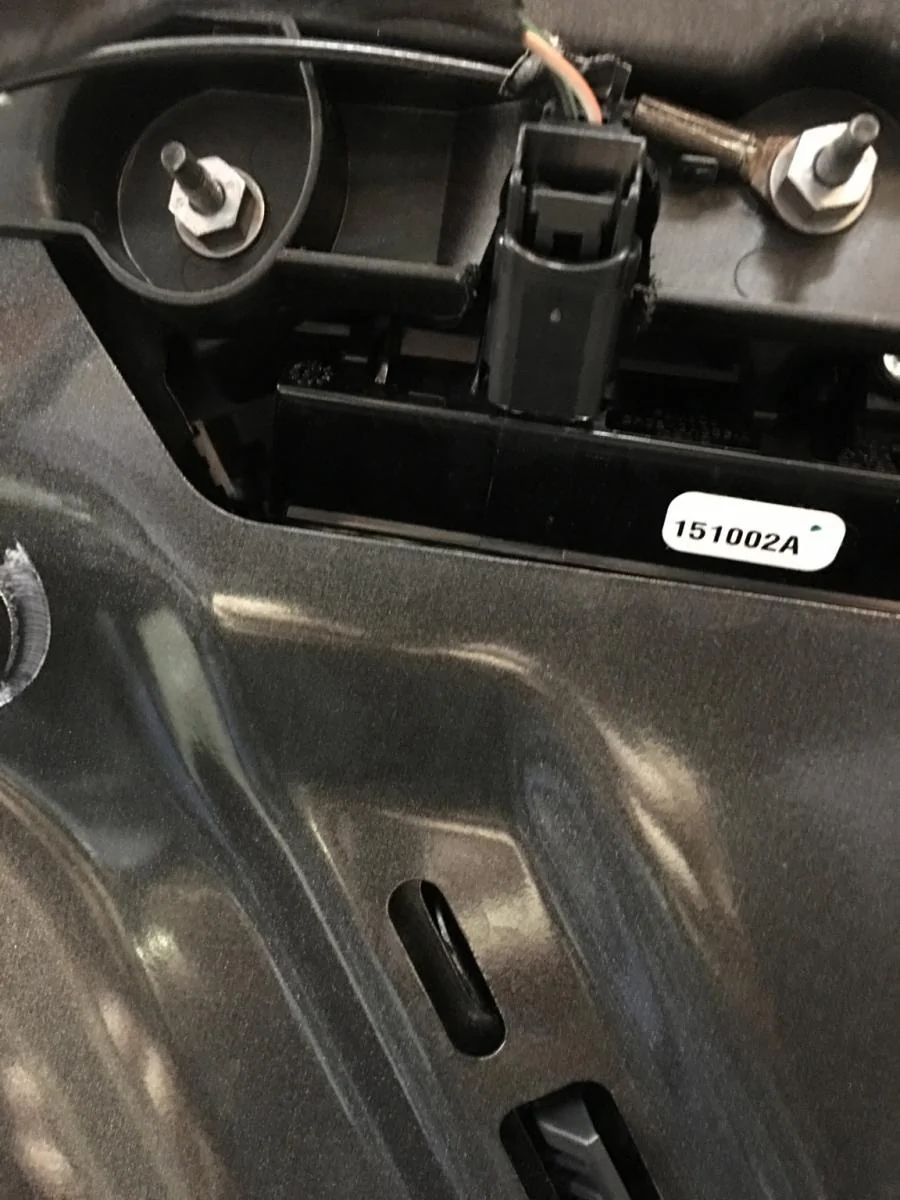

First I swapped my 2015 magnetic heat extractors for the 2016 which is self explanatory. The only modification needed was to notch out the center of the plastic mounting brace that is used to "sandwich" the assembly to the hood and has the two 9mm nuts holding it in place. Just had to make room for the plug assembly that is now needed to connect the blinkers.

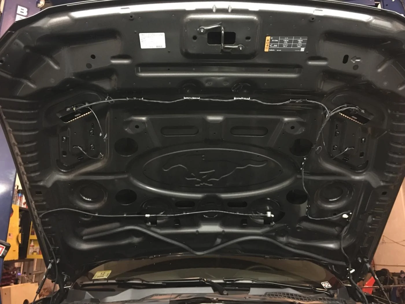

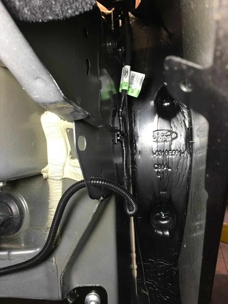

Then I snapped in the 2106 OEM under hood wiring harness. This comes completely assembled and has the snap on clips already attached exactly where they need to be to attach to the hood.

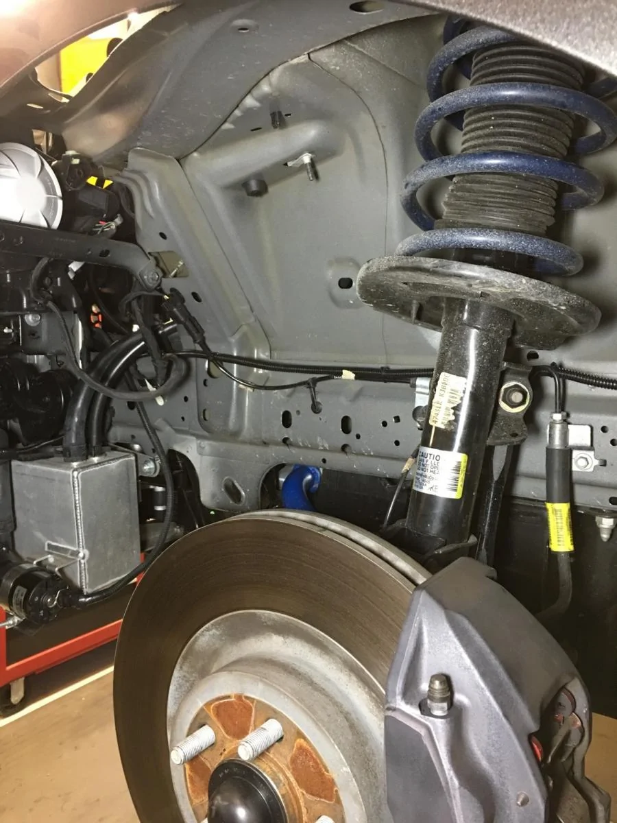

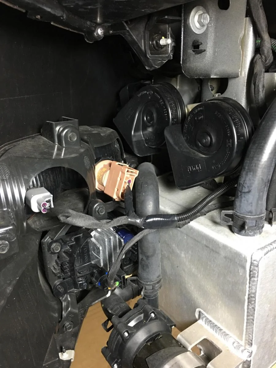

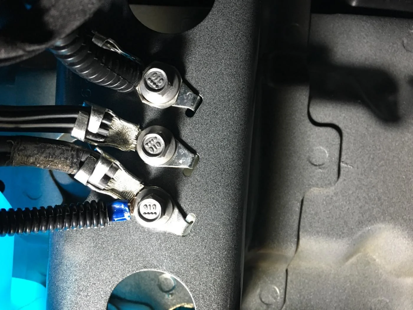

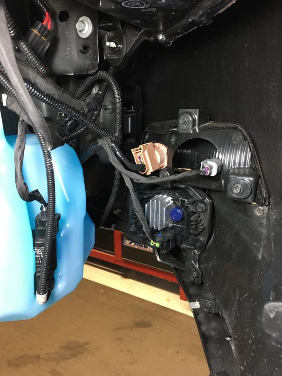

I then took a length of speaker wire and attached the ground to one of the three ground bolts on the passengers side of the radiator support behind the passenger headlight and used the other side of the wire to tap into the blinker signal wire from the blinker plug on the passenger blinker.

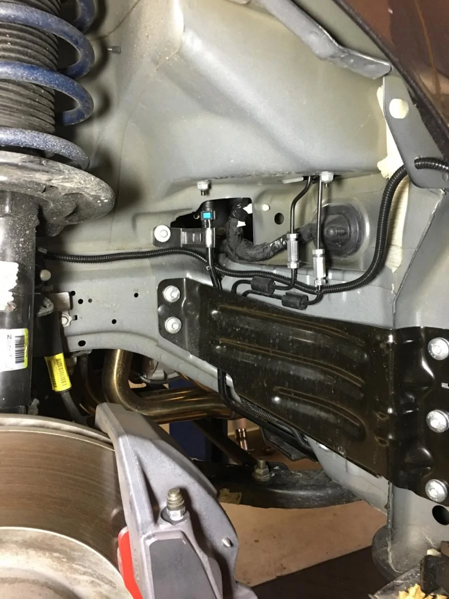

I ran my new harness under the radiator support and then along the drivers side wheel well to the area just behind the driver side 5.0 emblem. This is where the factory under hood harness ends.

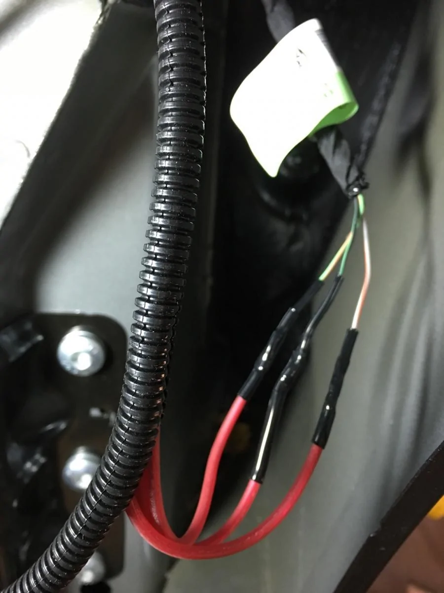

Then I used a single wire from the drivers side blinker plug and added it to the loom assembly I ran from the passengers side.
I clipped the plug off the factory under hood harness and connected my new self made harness to it.

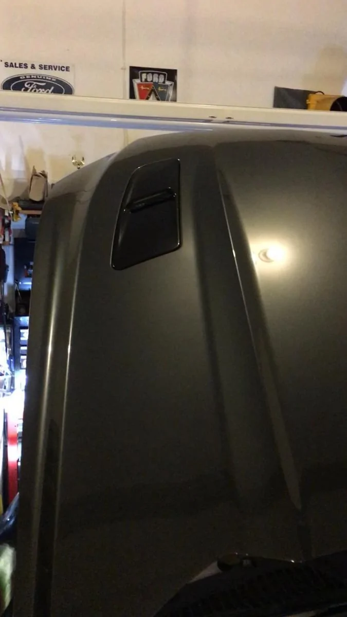

And that's all there is to it. For a total of $183.25 I now have the OEM hood extractor/blinkers like the 2016 models have.
