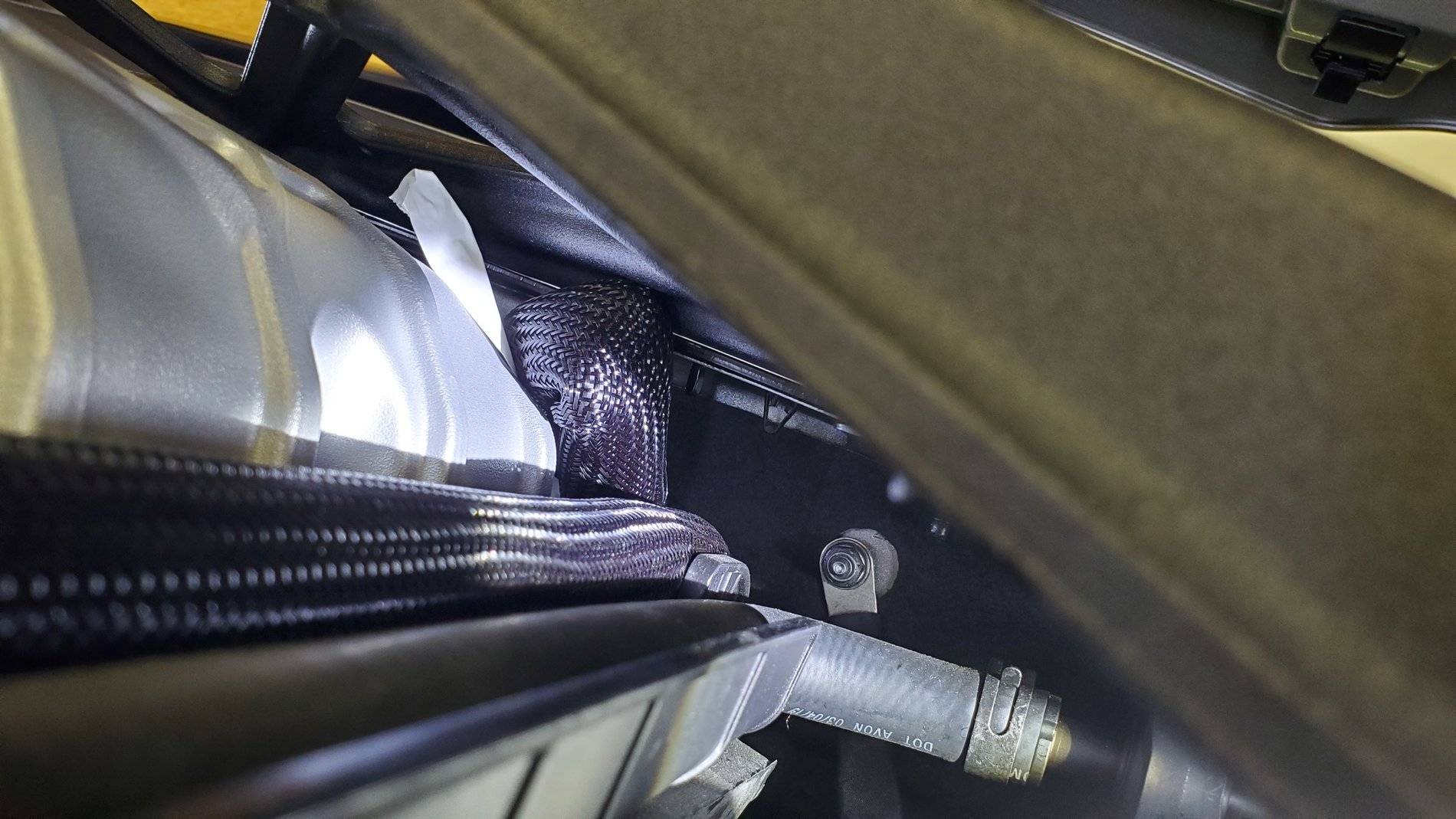

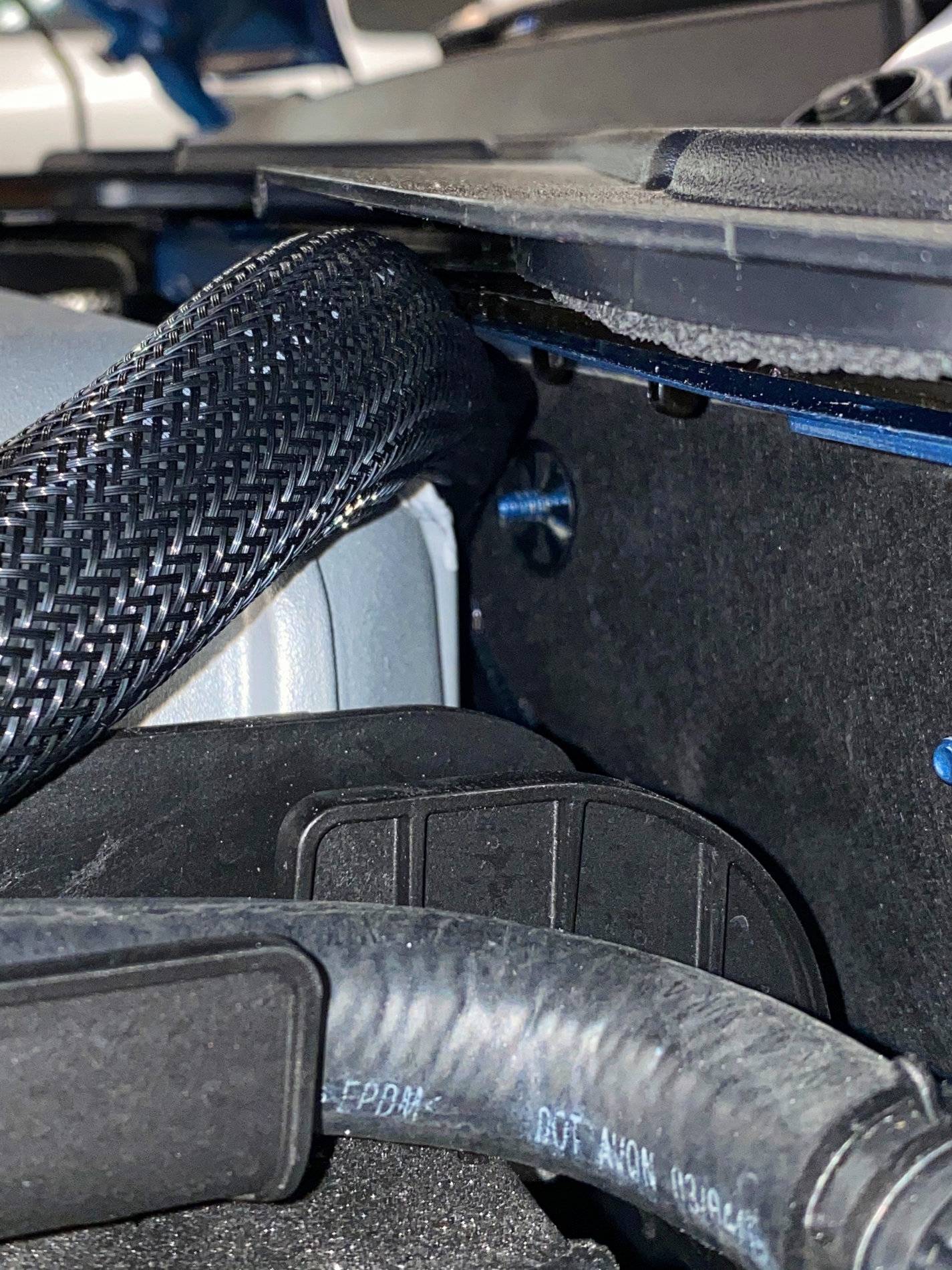

1. open the engine hood and check the right cooler hose to see its not pinched in the back, you would know this because it wont be in the channel.

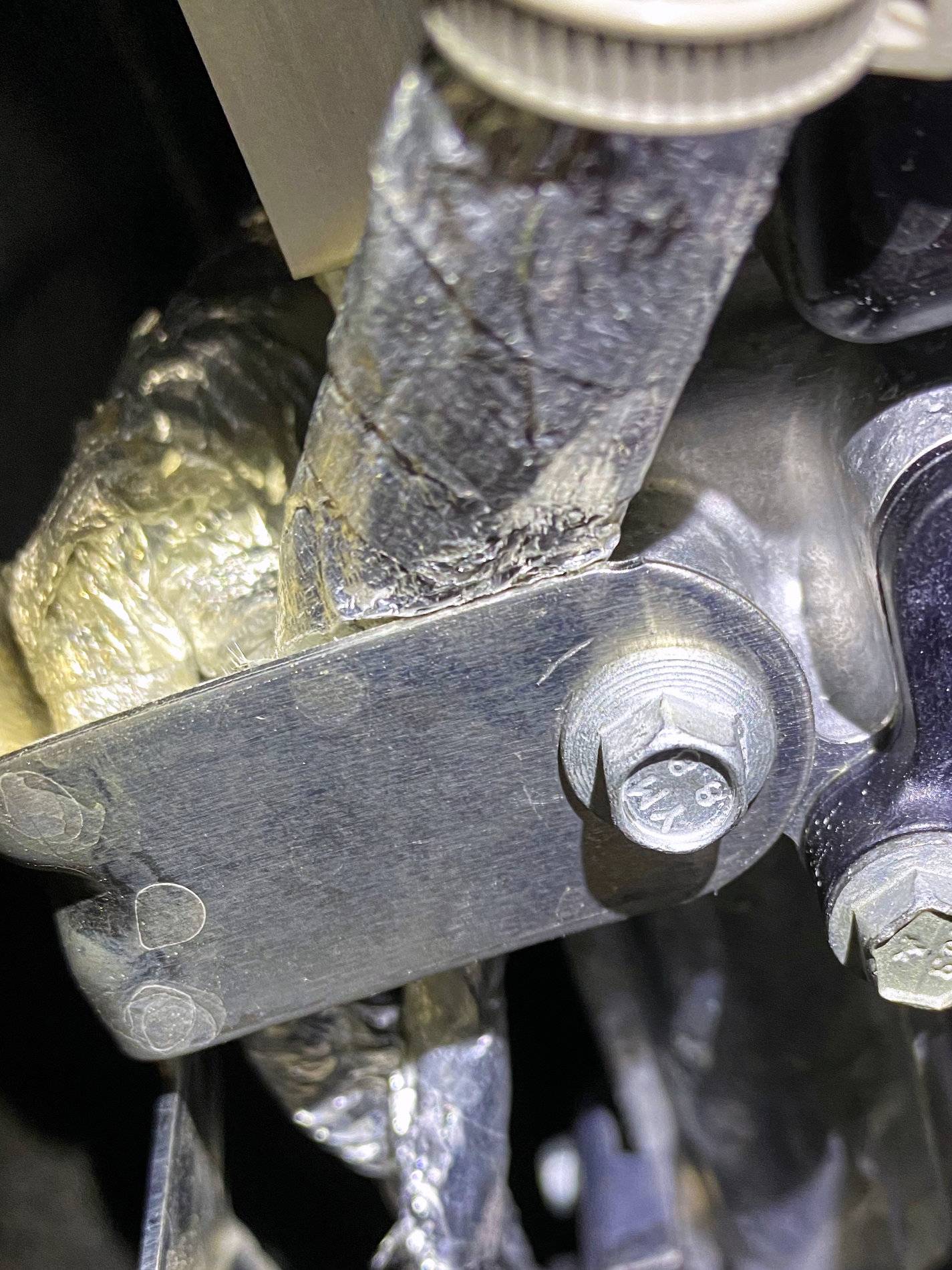

2. Under the car check a hose next to the tranny some cars have it too close and pinched on the bracket.

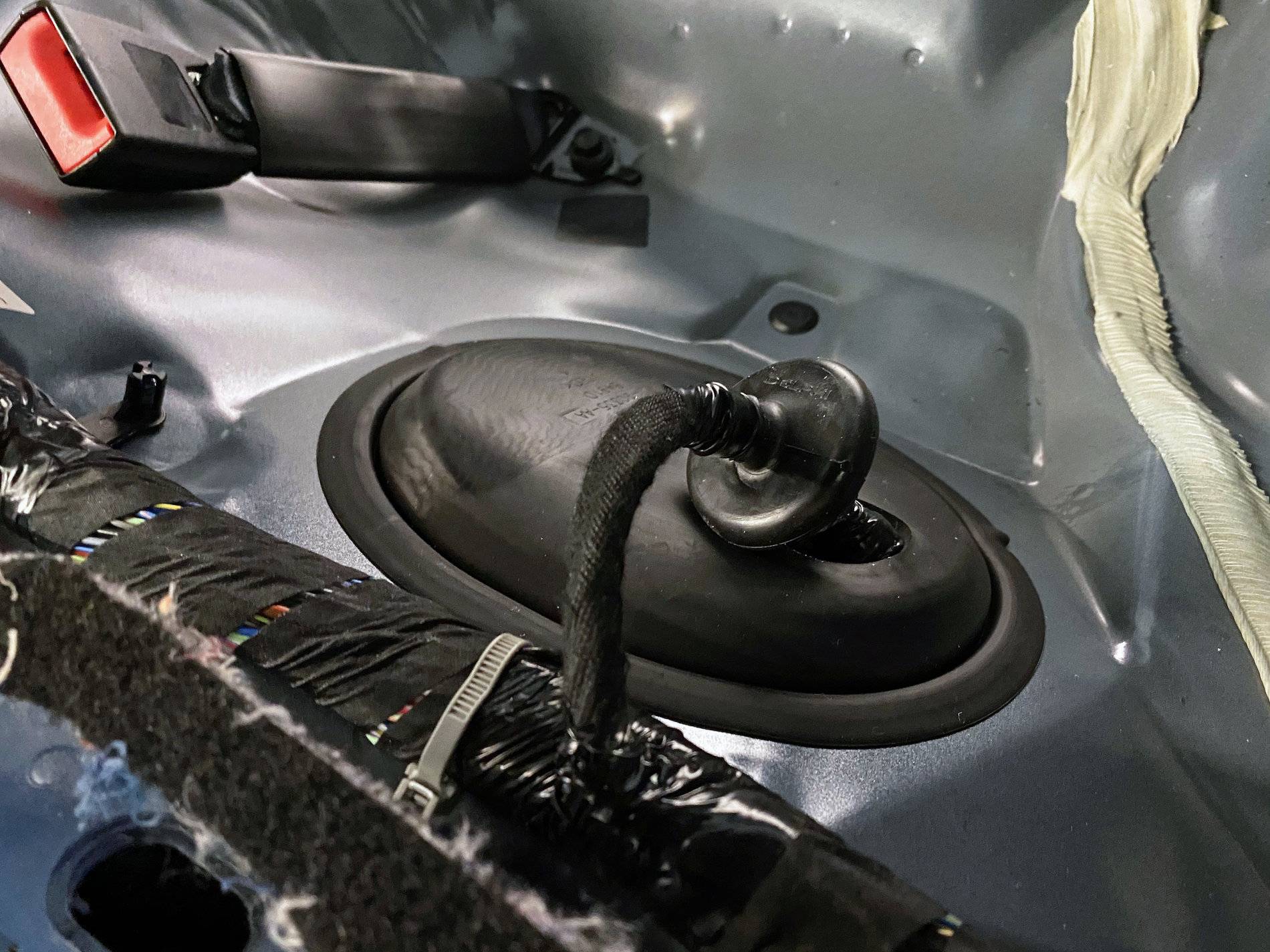

3. Under the backseat or cover if you get a CFTP make sure the fuel line grommet is seated properly.
4. Check all covered areas (Such as around the hood pins) for incomplete paint job (ask me how I know)
Attached are the pictures of the first 3:
