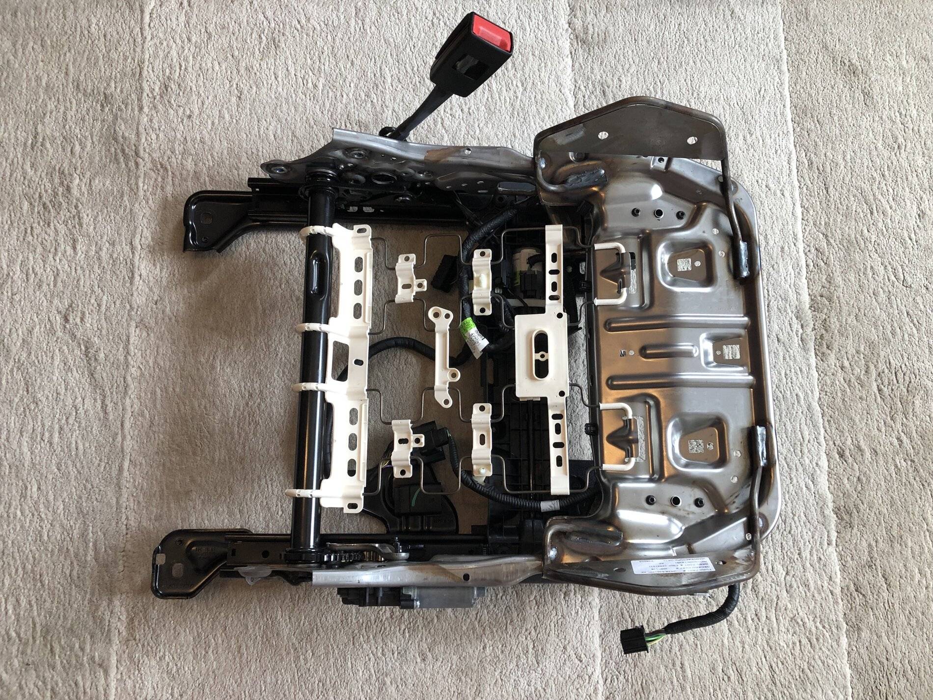

I can’t tell you if it’s fixable, but I can tell you it’s a little tricky to get to the mechanism … :frown:
