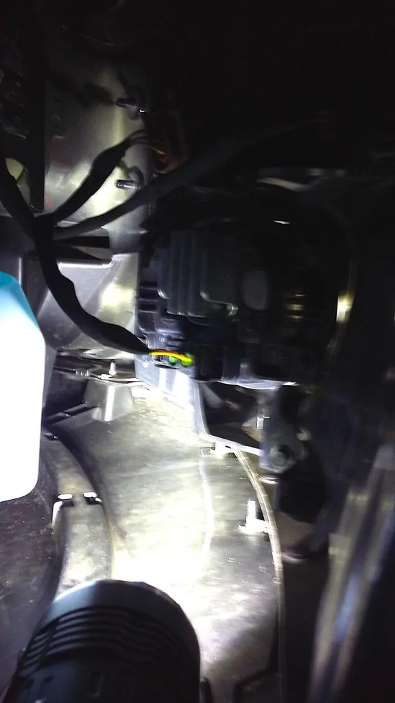

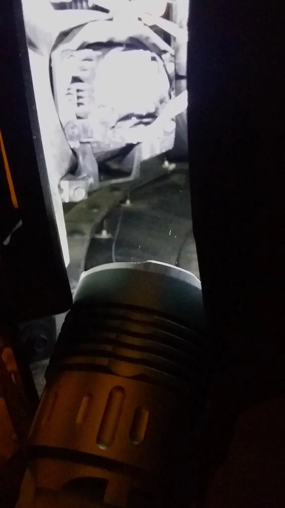

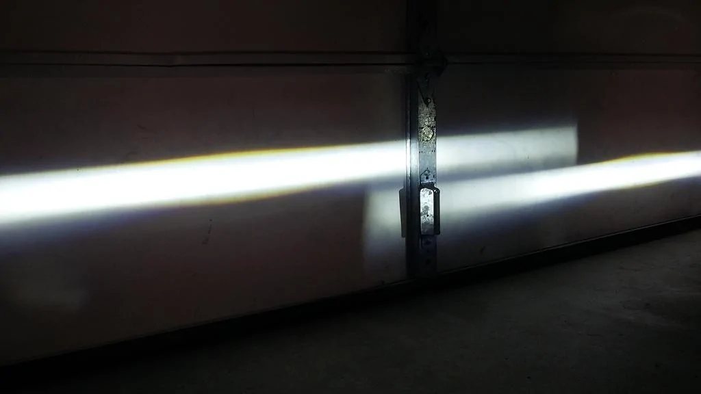

Ok.. It was not a full waste of time, I think it took longer getting the six pushpins back in correctly, there is no thumb will you need a small flat tip screwdriver, maybe slightly smaller than a quarter inch, I can't see the actual adjusting screw but a small flat tip screwdriver worked. .... Here is the difference on the garage door should be a little more at night actually on the road.

have you tried them at night, how was the new aim? Still too low, not high enough, too high? I need to do this to mine...

I just got home from work and driving them at night... They are a little high, but they are not the brightest foglights so I think it's perfect, if you go to brighter aftermarket bulbs you're going to piss off oncoming drivers I'm sure, just raise them up to the maximum ,you will probably be OK with traffic. ... But it's definitely a nice difference.
