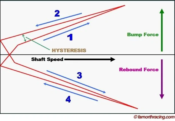

There is also the matter of shock force not returning to zero even when velocity instantaneously becomes zero. Or even not following the same path "back" that it took to go "up wherever".
Norm
Interesting. Add also these are twin tube (slower reacting) and very likely in a situation on my car beyond their designed valving. Can't wait to get rid of them.
