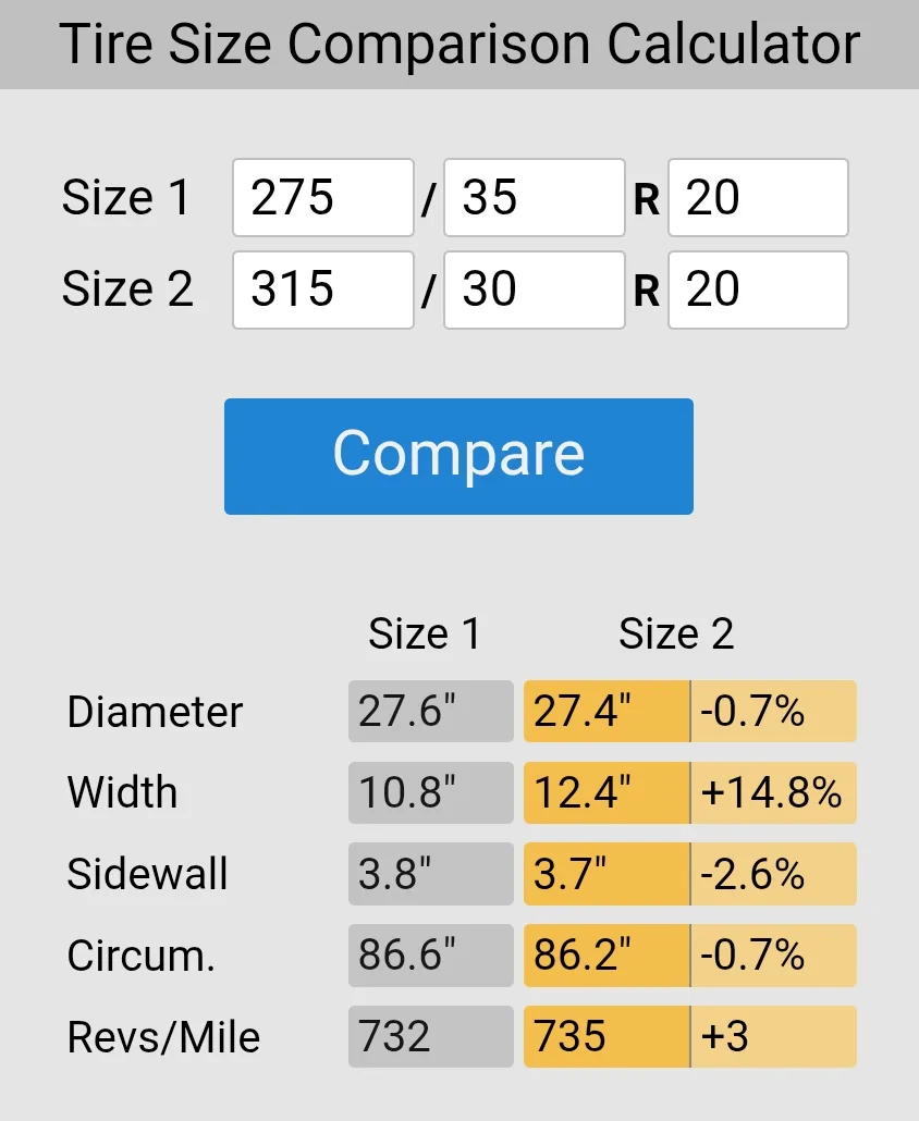

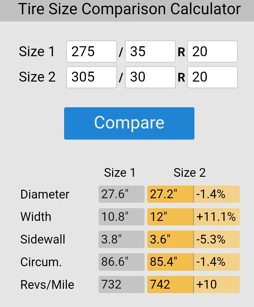

Those sizes should be fine. I've known people similarly lowered with 285/35r20 in front with no rubbing. Many seem to run 305/35r20, a much taller tire, in the rear without issues.
Here are some details. The diameter and sidewall would be slightly larger for the front tires, but I don't know if the difference would be noticeable. A 315/30 would get closer.
