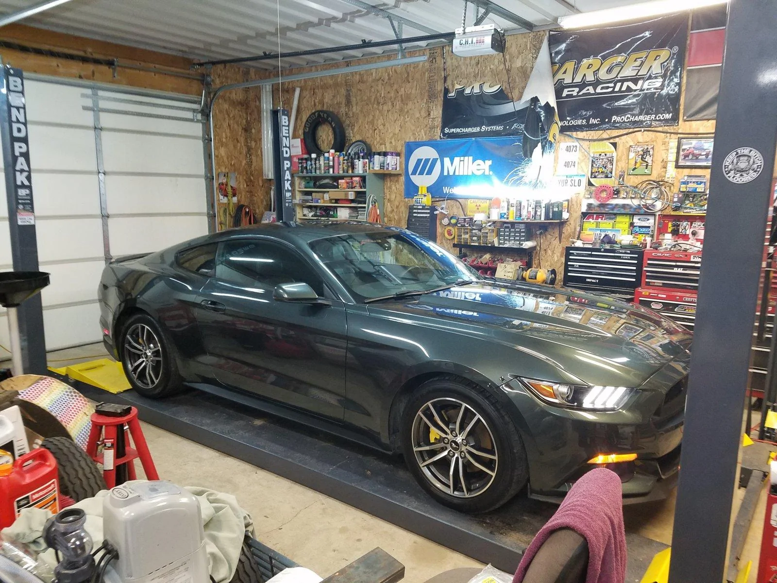

So im new to the 550 platform but not Mustangs. Long story longer i bought a repo 15 Ecoboost. It runs but smokes alot. I trailered it home and pulled the JLT cai off and oil dripped out. I then removed the intake manifold and it had ill bet 3/4 quart of oil or better in it. Looking in at the valves, they have oil baked onto them. Cylinder head has oil sitting in it on the cylinder that the valves are closed. I ordered a UPR catch can set up. Am i going down the right road here? I cannot believe this thing even runs. Anyway, any advice on making this thing right would be greatly appreciated. Been reading alot on here, great site!
