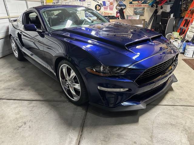

I bought my car new 6 years ago, since it was a California Special I've added a lot of 'cosmetic' items to it over time.
I waited 15 weeks to get my Cervini Ram Air hood since I had them paint top, bottom and vents matching Kona Blue.

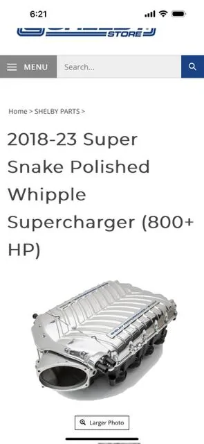

Now that the car looks MEAN, I need to back it up. I live close to American Shelby and they offer a Super Snake 800+hp whipple and since I'm an old guy who likes chrome, they offer a chromed whipple.
Now my question(s) to members here who already have a whipple on their 6Gs
What else should be done to car?
My car is the 10spd & 3.15 rear gears, currently has 25,800 miles and is only a weekend driver.
American Shelby wants me to upgrade rear diff w/3.55s, half shafts
Also trans cooler and upgrade brakes.
please give me honest advice, I do know I'll be paying top dollar at Shelby but they do these conversions daily.
