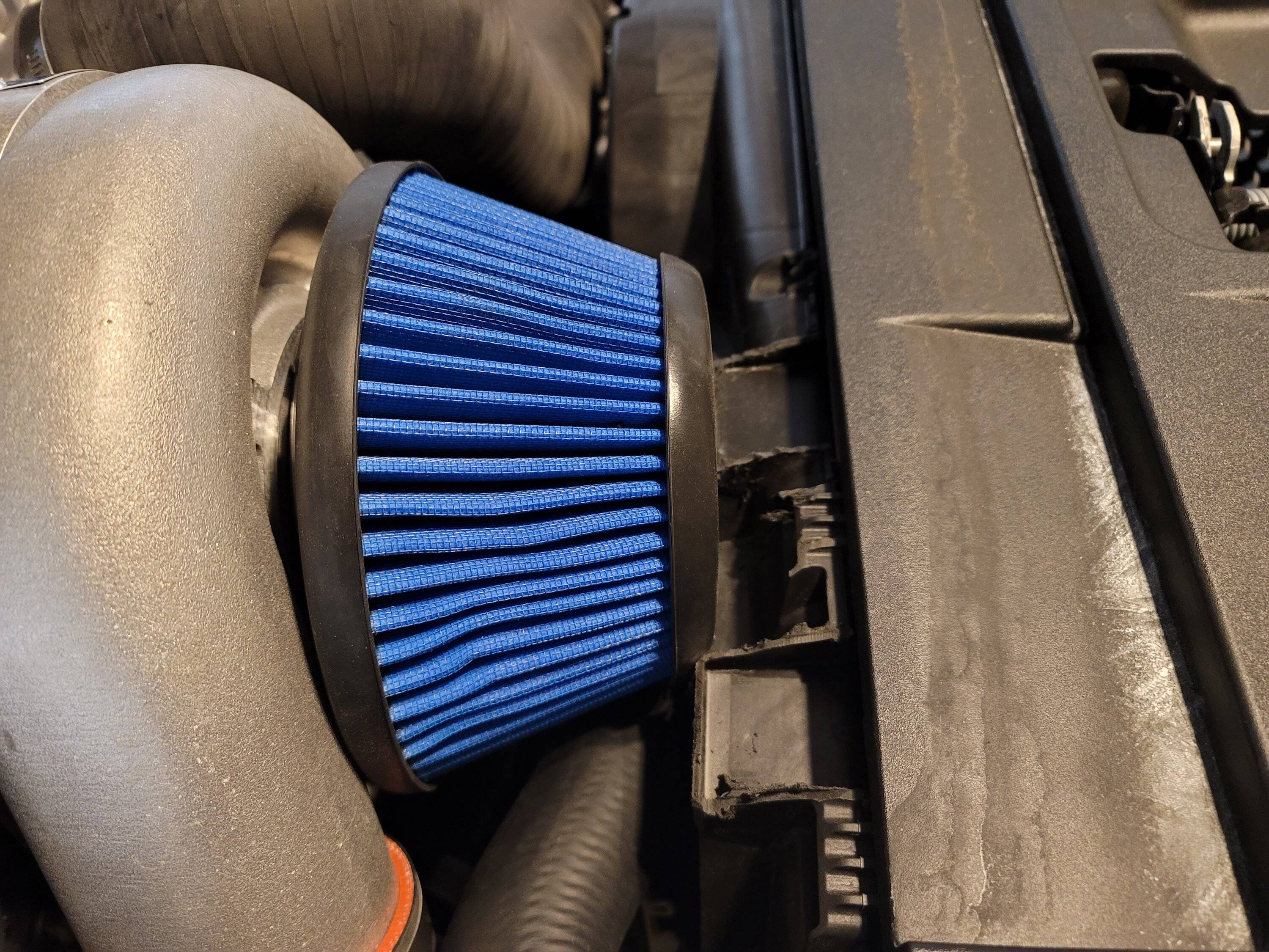

I'm eliminating the tube and running a burger filter on the blower.

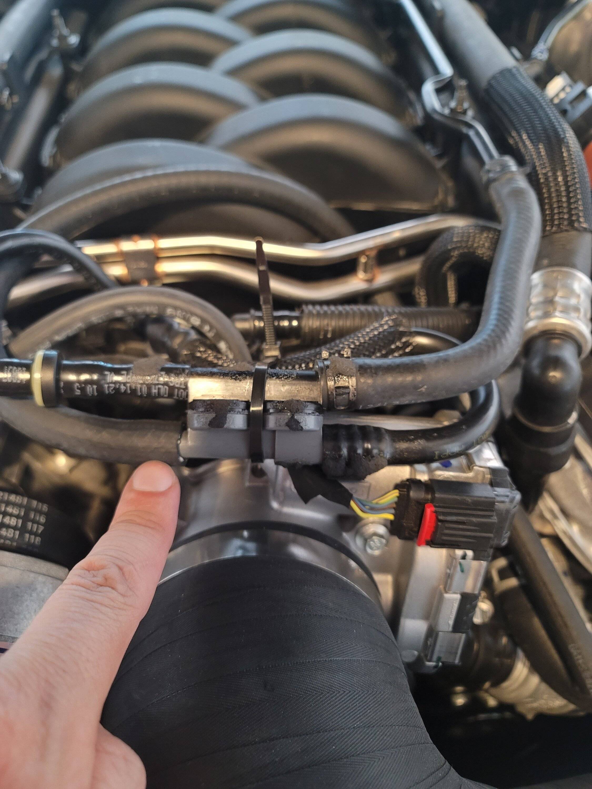

I'll be putting a breather on the driver side valve cover, but what do I need to do with this line that also goes to the intake? I left the passengers side as instructed in the kit.

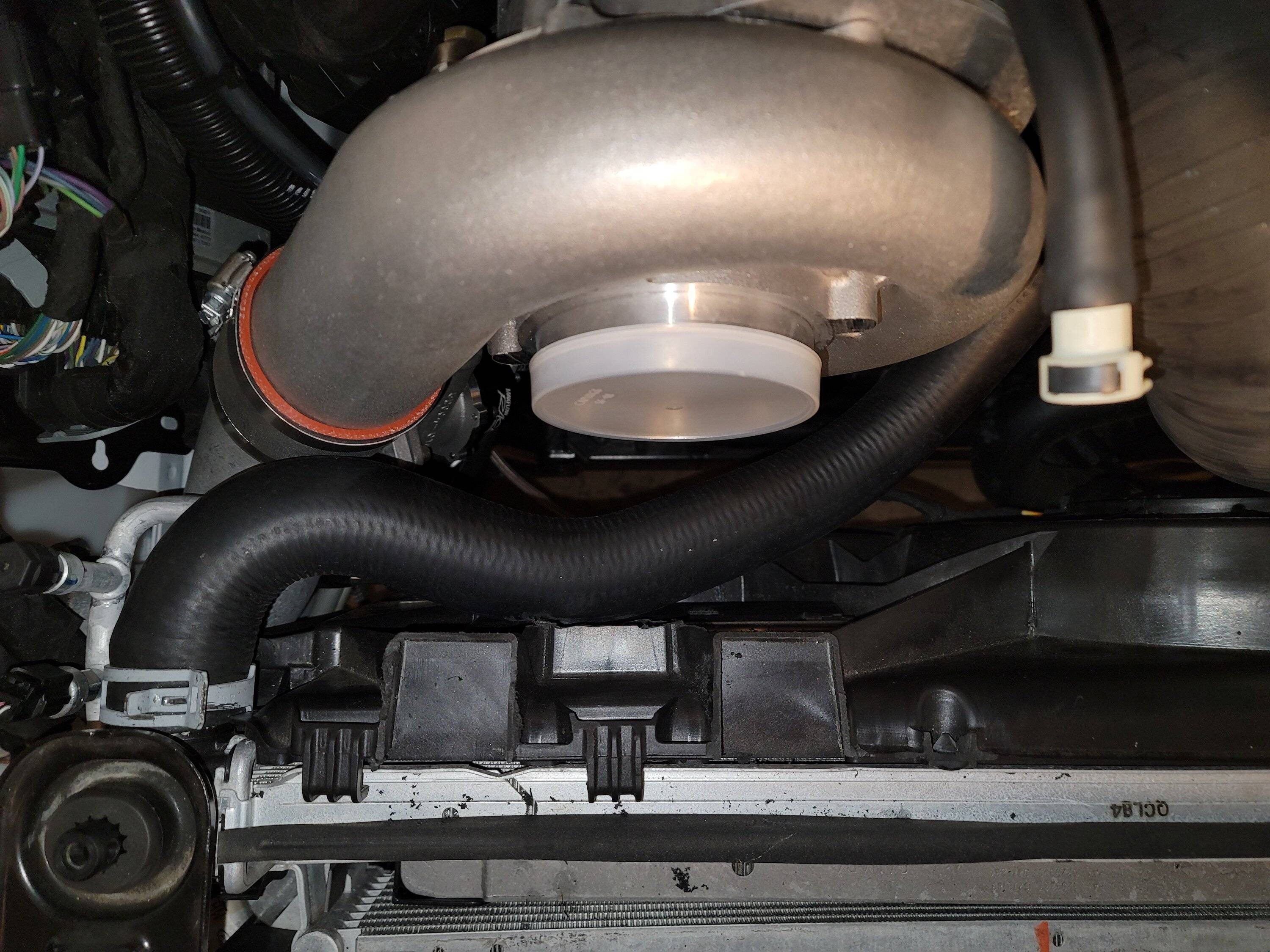

I found threads with some info but looking for more. Also attaching some pics to show what I cut out and how it fit as I've seen people asking that question a lot. Hope it helps someone.
I would recommend the shorter burger filter even though this fit. The spectre filter fit and looked great, but after reading some horror stories I decided not to even try it.

If that is the line that is behind the throttle body that went to the intake tube, put a cap on it.
I am running a spectre filter on my paxton. Should I not be? I havent heard any horror stories but I haven't really looked it up
