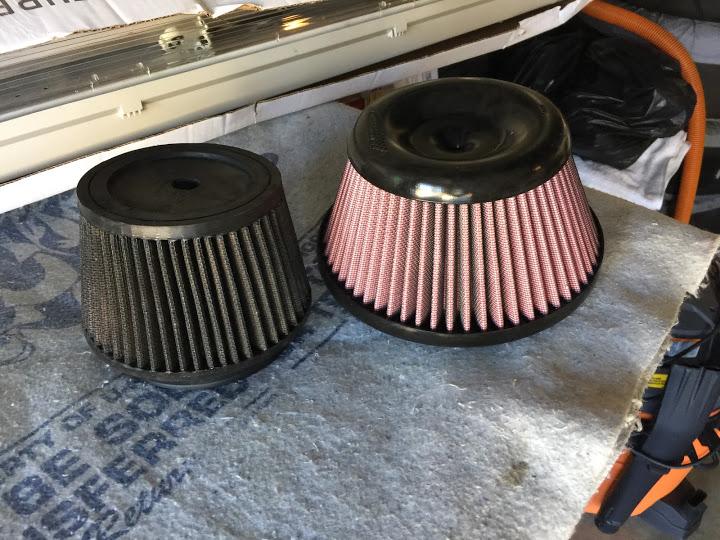

Anyone running an air filter directly on your Paxton/Vortech head units instead of using the JLT or stock airbox options?
I ordered a Vortech kit, for my 17 GT, from Beefcake recently and I was wondering if anyone has done this on their vehicles.
Any pros/cons to it?

Yup, I installed:
Spectre Performance 8161 Universal Clamp-On Air Filter
Be prepared to chop off a good amount of the top radiator shroud for clearance.

Yes, you can pick up the Burger Motorsports filter, is has more surface area than the K&N most people use
I find this hard to believe considering the size of the filter that comes with the JLT and other intakes.
Not a lot of room in front of the blower inlet to run a large filter.
who said anything about JLT? They use S&B filter, I said K&N most people use when they delete the snorkel, you know, the RU-2510 filter.
Most blower setups seem to eliminate the entire factory airbox - that is what I was talking about.
It might have more area than the panel filter, but not any of the typical cones(made by K&N or whomever) seen in most blown engine bays.

I think it will lose power with that small filter over JLT plus you can’t hook line to driver valve cover
comes dow to pressure drop across the filter vs pressure drop across the snorkel+JLT filter. That's why you want as large a filter as you can fit, so you have less pressure drop, but like I mentioned, always take it off when you race and it won't matter one way or the other
