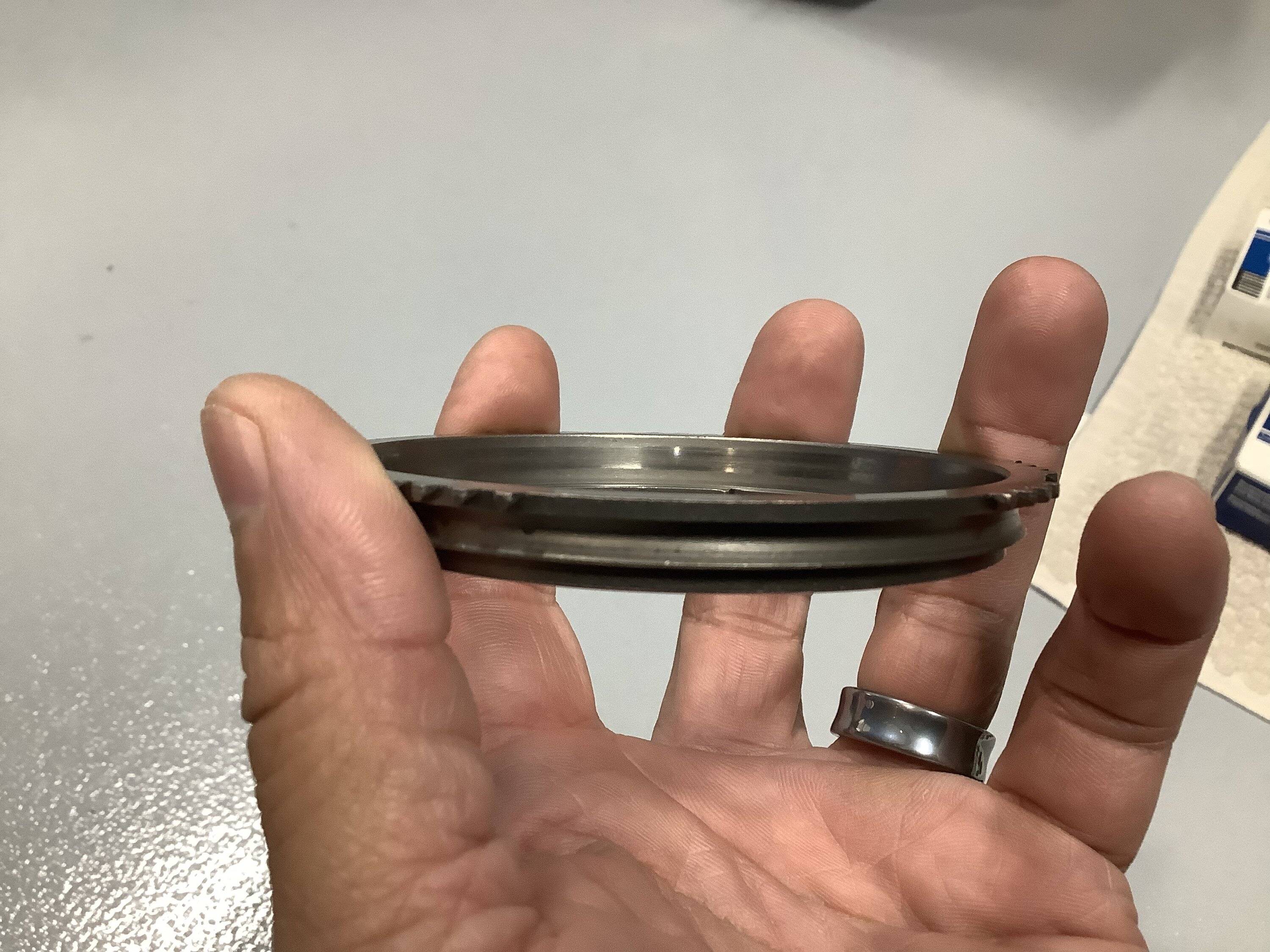

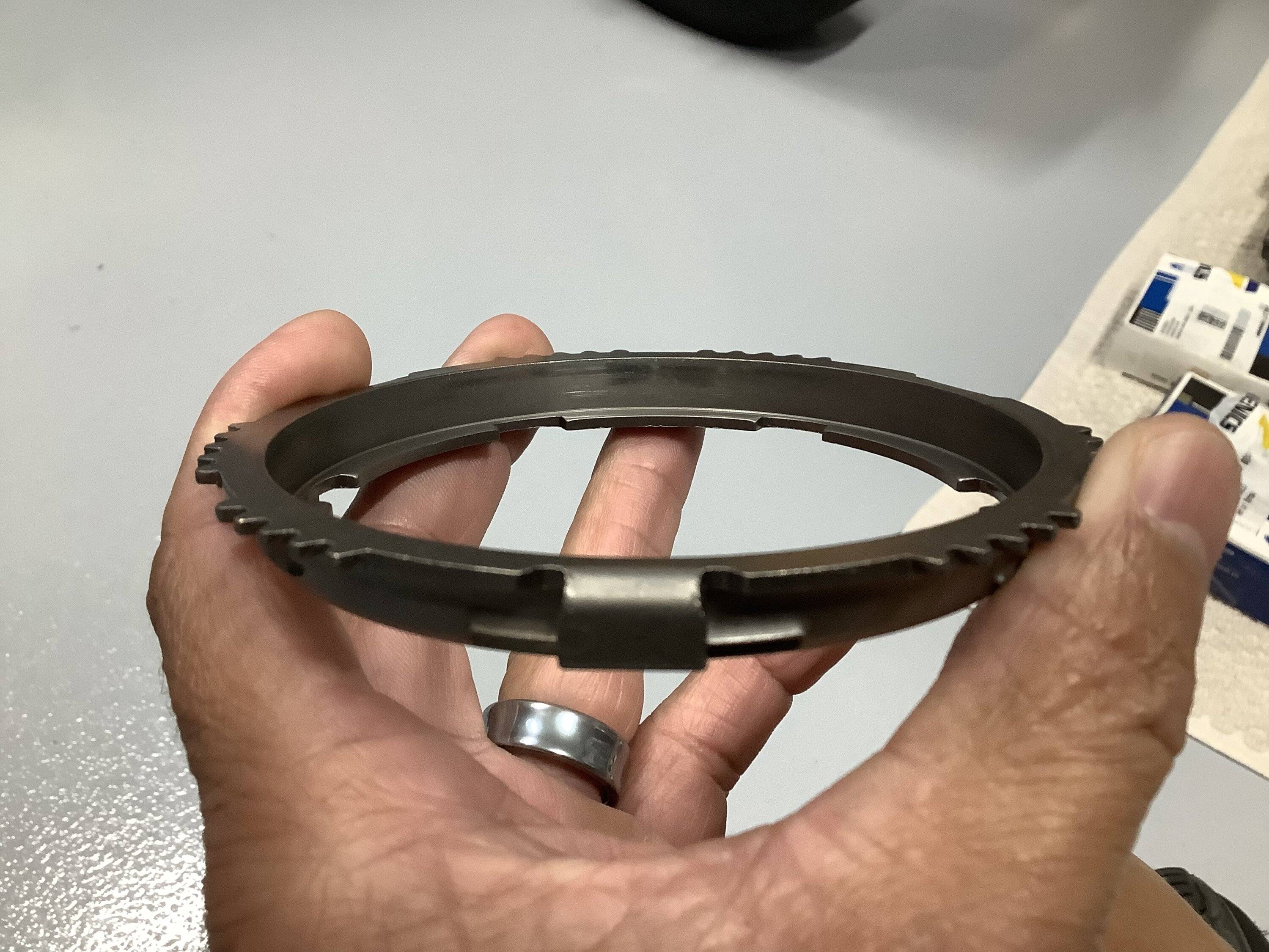

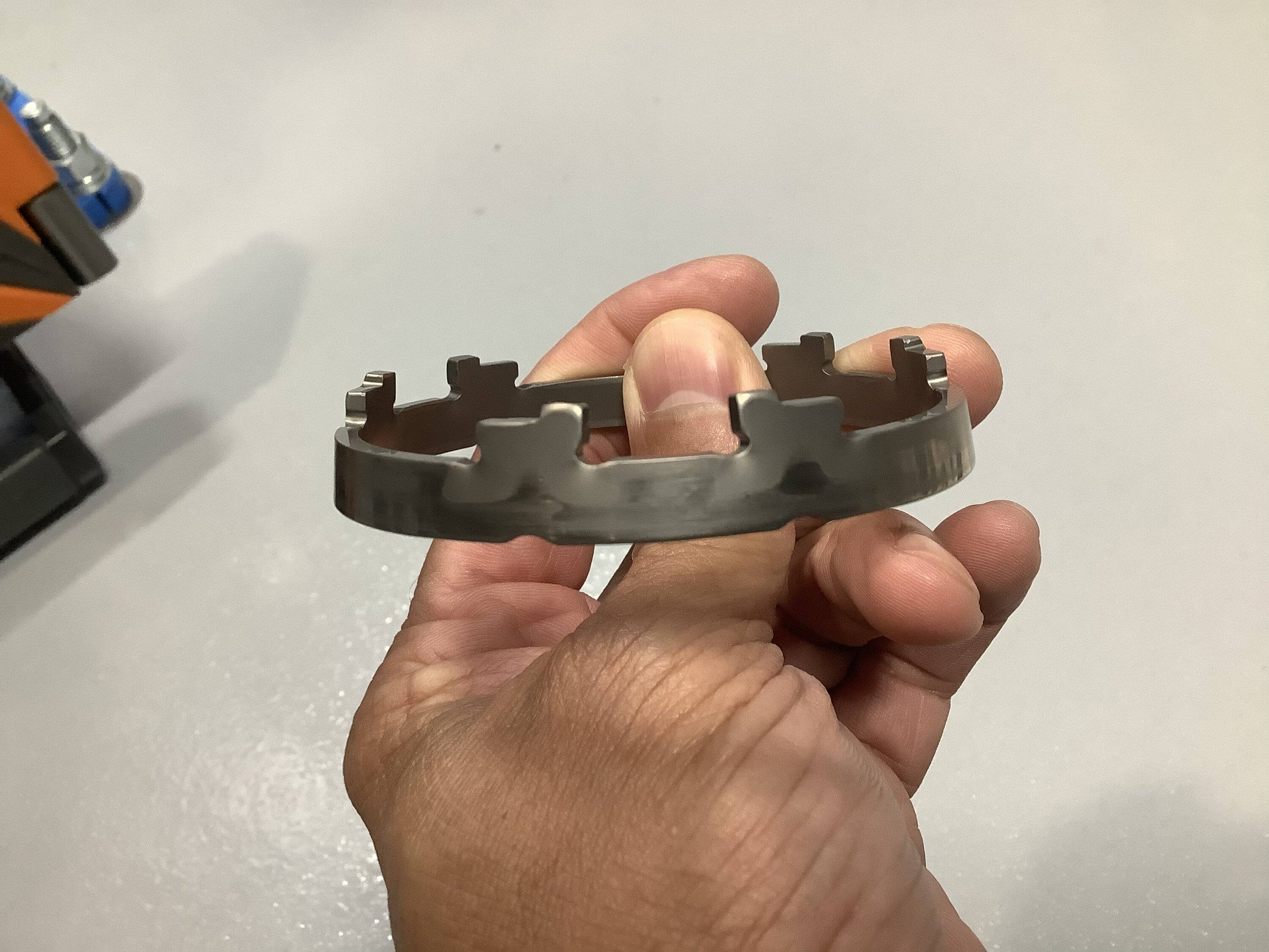

How many miles were on your tranny when the synchro let go? I know the GT350 tranny is different than the MT82-D4, but when I took mine apart to rebuild with 6K miles on it, I noticed that the coating (including the carbon lining) was wearing off on some of synchro rings. The teeth on the synchros looked fine though.
