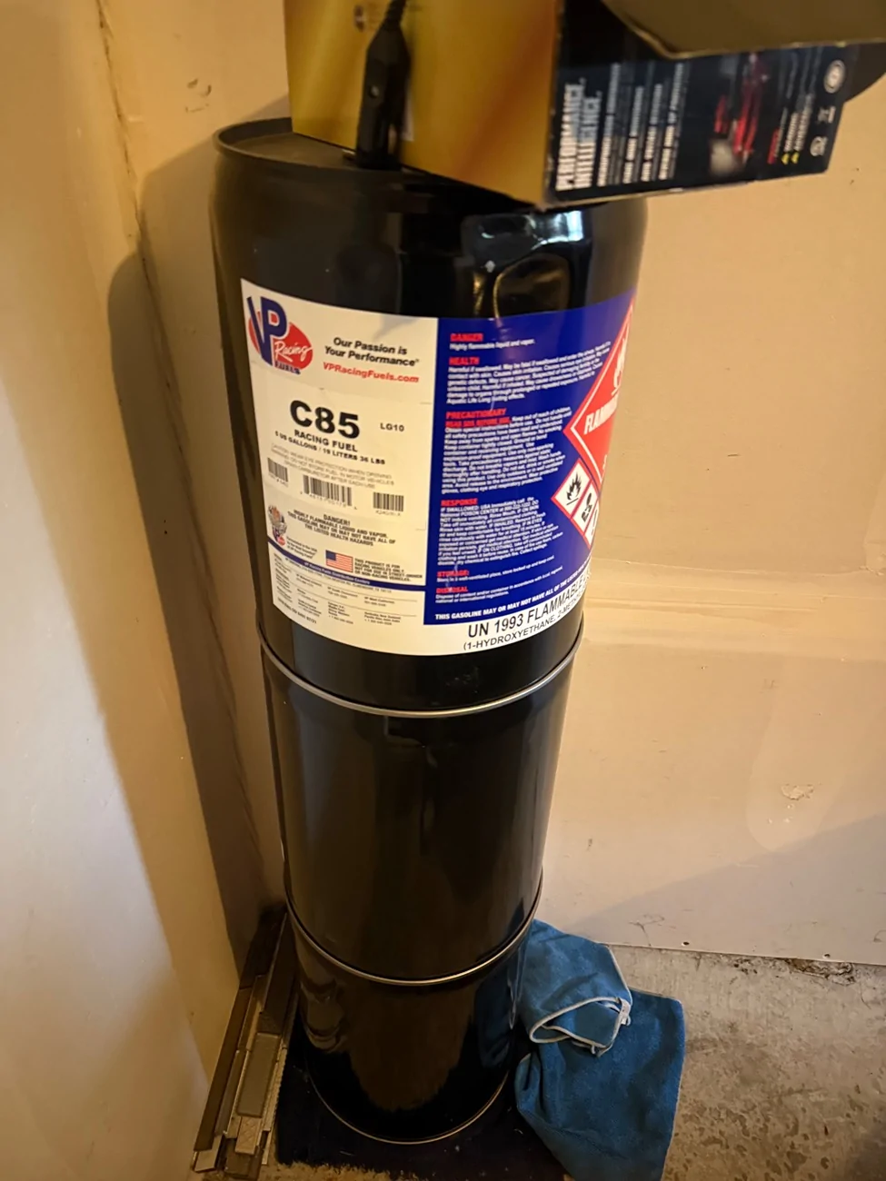

I wonder if it would be worth testing a sample of the e85 you've been using.
