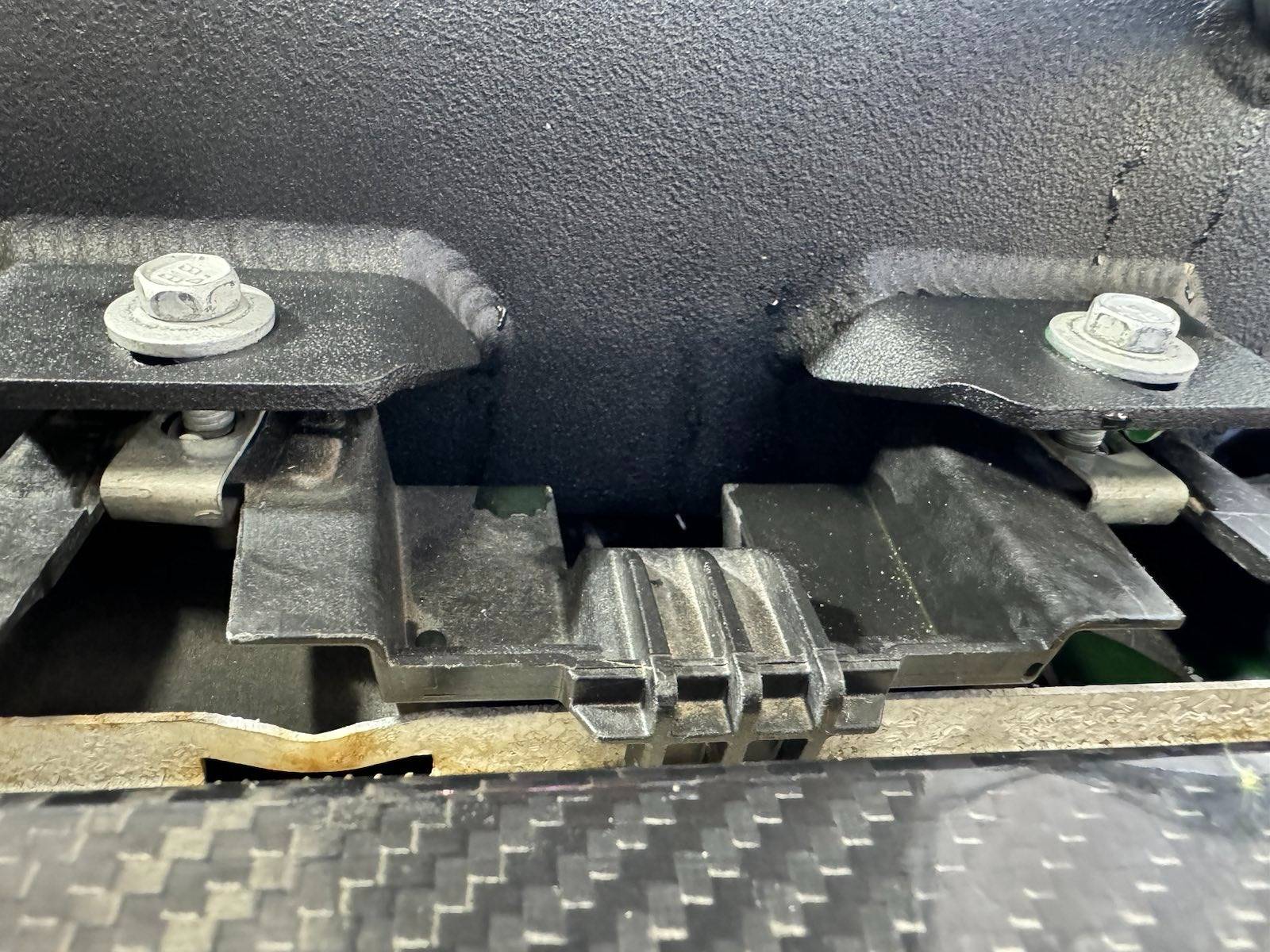

Good Morning,

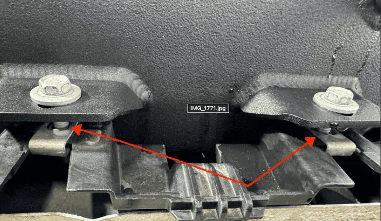

I received my Fat House Coolant Tanks after preordering November. These combined with the Red anodized caps look great. The fitment on the Radiator tank is a little strange and i have reached out to see if they meant for us to put spacers in between the bolts or of it was meant to "hover". Overall i am very happy with the build quality. Just though i would share.

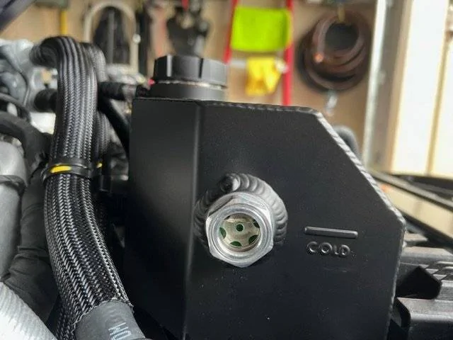

I don't like that the entire container is opaque though. One transparent measurement line to quickly check the fluid level on the side of the container would have been nice.

I think you need to use shorter bolts. The thickness of the tank flange is less than the thickness of the factory plastic flange and therefore the ends of the bolts are hitting the radiator shroud and causing the tank to rise as you tighten the bolts.
You could also use spacers to correct the problem, but visually they will be noticeable.
You know the tab at the back? it is longer than the stock tank and hits a stop, not allowing the tank to go down more. If i use shorter bolts the tank would sit lower in the front than the back. The same happens when I tighten the bolts down and pull the tank down but then it is stressing where the tab is in the plastic radiator holder.
As a FYI no instructions were sent with these so i may have not installed it per their recommendations, still waiting to hear from them.
Sounds like you either shorten the rear tab and use shorter front bolts, or do nothing and use spacers.
They should be sending directions as it's obvious this is not a plug-n-play replacement tank. They should also be supplying hardware in my opinion, but who am I?
Good luck, keep us posted.

I would use spacers, it is not rocket science. :bow:
It is not..... but...
Having done many different things with my car over the past four years, I discovered the most important thing to keep in mind is the height at the top of the cap.
When I initially installed a polished aluminum SA tank and their aluminum caps covers, the cap would hit the bottom of the rain tray.
When I switched to the black tank and the replacement aluminum caps that came with the SE package, it still was too close to use the rain tray. This was the case with also shaving some plastic tabs off of the radiator shroud.
SA now has a relocation bracket that allows their tank to fit without shaving the shroud. My point being is that although it's not rocket science, there is a good possibility there could be fitment issues if not paying attention to all the factors involved.
Not knowing if this new tank and cap sits higher, I might be inclined to shave the tab in the rear and use shorter front bolts.

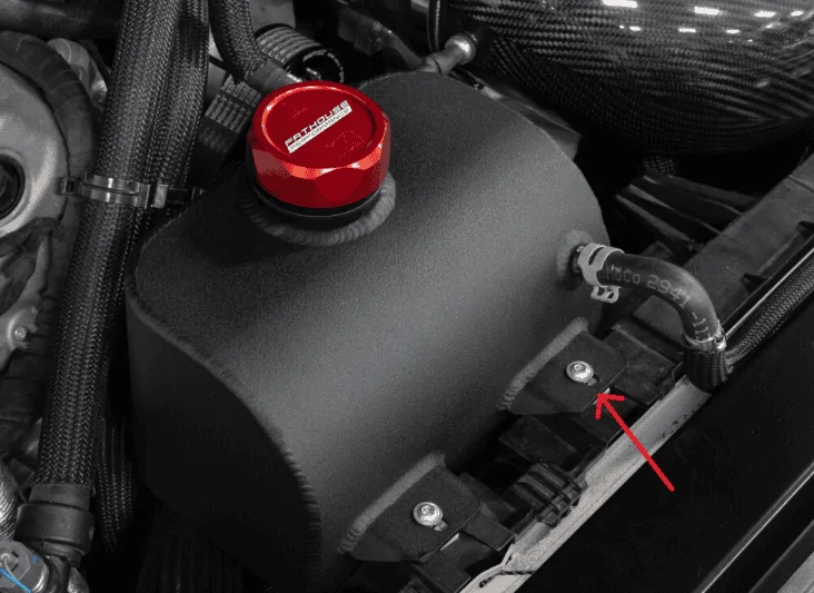

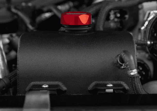

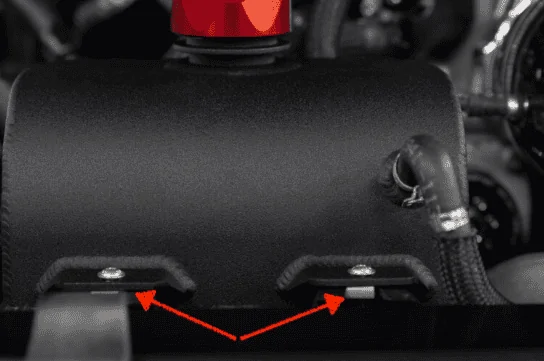

The website shows different bolts installed, not the OEM ones
Good catch, the lid is definitely very close to the vents in the hood and the rain tray would for sure hit.

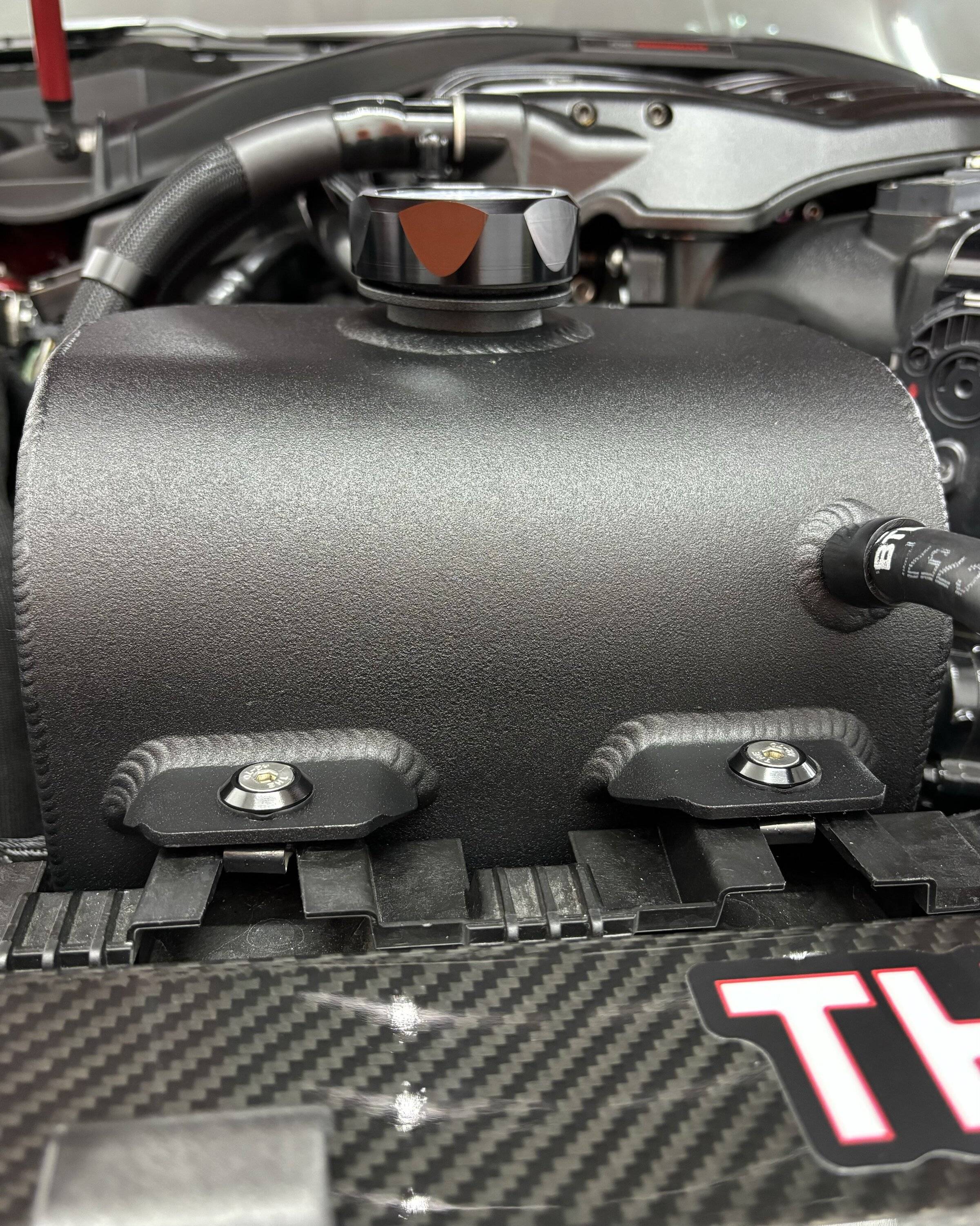

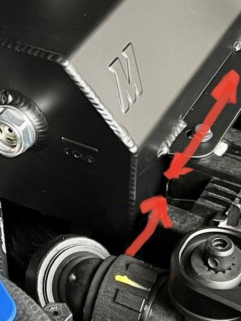

This tank is sitting lower, no threads are showing. I will assume that these screws are the only mount points, like OEM.
My GUESS, is your tank is not sitting low enough, a hose, wiring something interfering, under or on the backside.
The lower hose (BIG) is it fully seated?

Its really not a huge deal, even adding spacers would work. Well as long as its not seating too high to hit the hood. Even without bolts that thing aint going no where.

The radiator gussets below that need to be cut in order for that to fit correctly. Those are designed to fit all mustang models, except for the GT500, so you will either need to use spacers or make cut-outs in the gussets that the tank is sitting on.

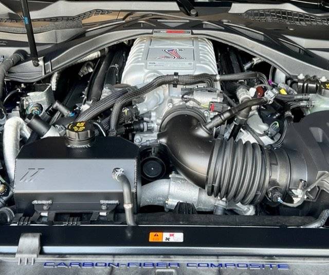

I do not know about the Fat House Coolant Tank. But I believe the majority of 15-23 Coolant Tanks are made to fit all Mustangs, not the 2020-2022 GT500. Specifically the fan shroud. I recently installed the Mishimoto Tank. To make it fit you must trim some fan shroud gussets that sit directly below the tank. Otherwise it will not sit flush.

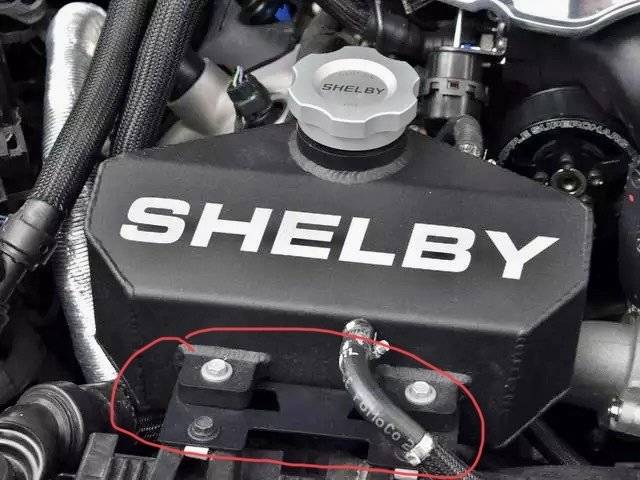

* you can see how Shelby mounted their tank on a 2020-2022 Shelby KR. Note the spacer pushing the tank back, likely to clear the gussets underneath.

There is a note on the Fathouse website
“2020+ GT500 requires slight trimming of the fan shroud for installation of the engine coolant reservoir”
It’s easy just score the gussets and they snap right off with pliers
