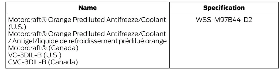

Just changed my overflow tank and noticed it was low with coolant. Anybody know what ford uses/recommends? It’s green/yellowish for what it’s worth, thank you

Yours probably came stock with Yellow.

so weird, in my owners manual it says to use orange but it’s definitely not orange

Free upgrade I guess, haha. Are you the original owner? It's possible someone did a flush for the new stuff. I did that with my '18 GT. I looked around online and I actually couldn't find any examples of 350's coming with the yellow stock. Even the 2020's . 27 seconds into this video you can see the resivour:
Here ya go, I had posted the charts a while back. First post in this thread has the original Ford Coolant charts and the most updated charts are on Page 2.
https://www.mustang6g.com/forums/threads/ford-motorcraft-coolant-spec-info.139849/
It can be confusing because for whatever reasons unknown to us, Ford changed coolant types I think 2x during the S550 production cycle…
