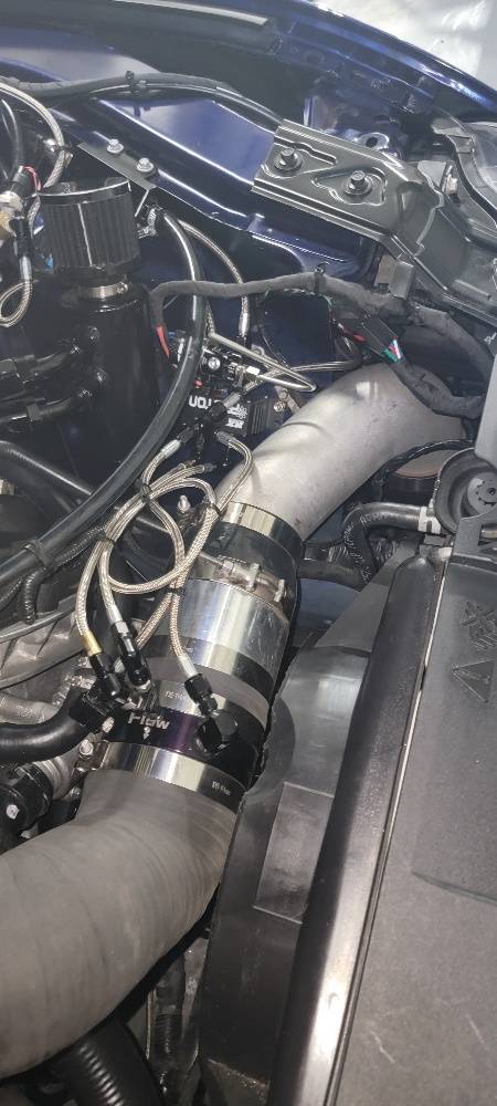

I could put some isolators behind it though
Ok reason for the pic is cause there's a KS close to the #5 cylinder that could be picking up frequencies that could mimic a 'knock' scenario with the nitrous engaged. the further you can isolate the system, the better off it'll be.
I'll add something behind the mount, also need to add the parameters to my log file for individual cylinders.

Hmm.. interesting setup. I'd prefer much closer to the TB. That'd IMO take care of the lean spike.
Well, I didn't know any better I guess. I called nitrous express and told them what I was thinking and they said it would work. The reason it is so far from the TB is that is the water meth ring, which is moved back in order to mix for IAT cooling (wish it was further back). I figured I'd just plumb it all in the same spot. First FI car and first nitrous car as well for me.
I think he's mainly using it for the charge cooling effect versus power, so the further away he injects it from the throttle body, the more time it has to cool the intake charge.
I don't disagree that the fuel could fall out of suspension in route to the intake manifold, but I think Nitrous Express could make a recommendation on the best location to inject based on his goals.
Correct, mainly for charge temp, however I'll take all the power I can get. Based on the logs, I don't think I am lean at all. If anything rich, if I am understanding it correctly. I am seeing commanded lambda of .65, doesn't that indicate it is pulling fuel?
