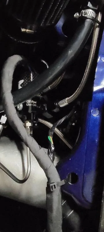

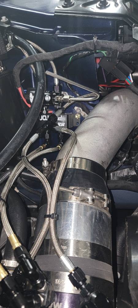

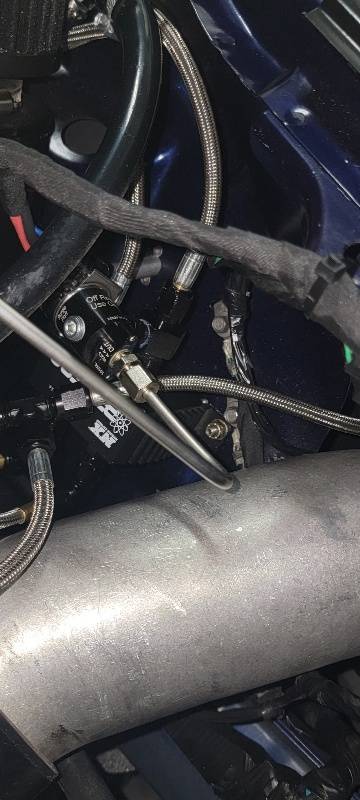

let see a nice clear pic of where the solenoid is mounted.

andrewtac
Feb 24, 2021
1,194
625
TX
mark
F250. 2020 GT 400A
I could put some isolators behind it though
