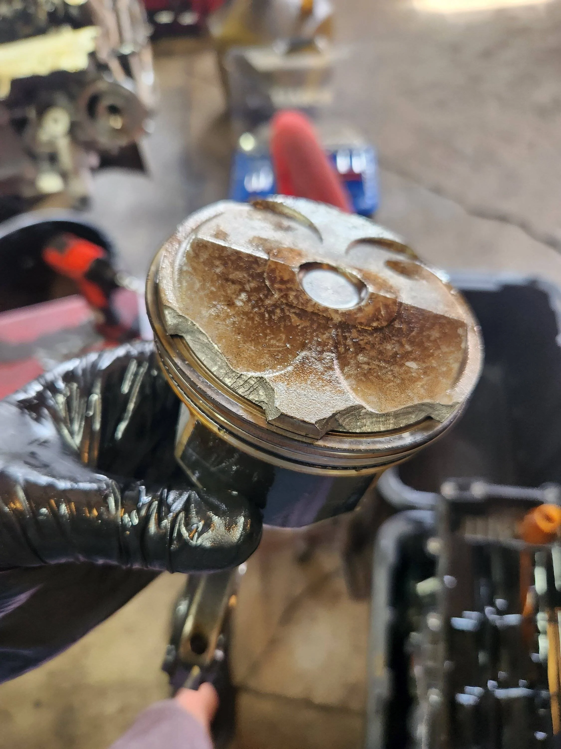

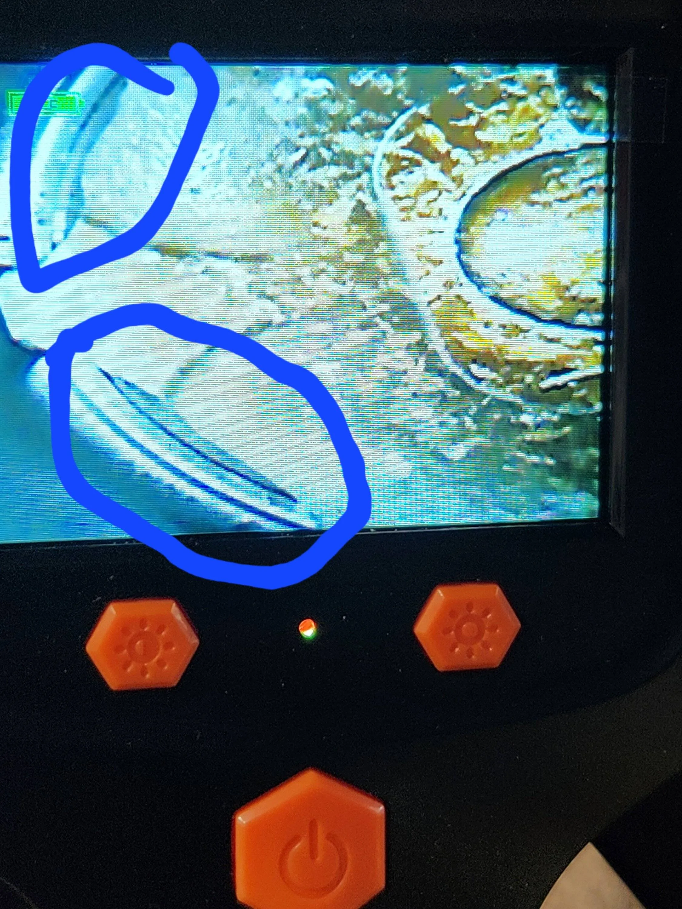

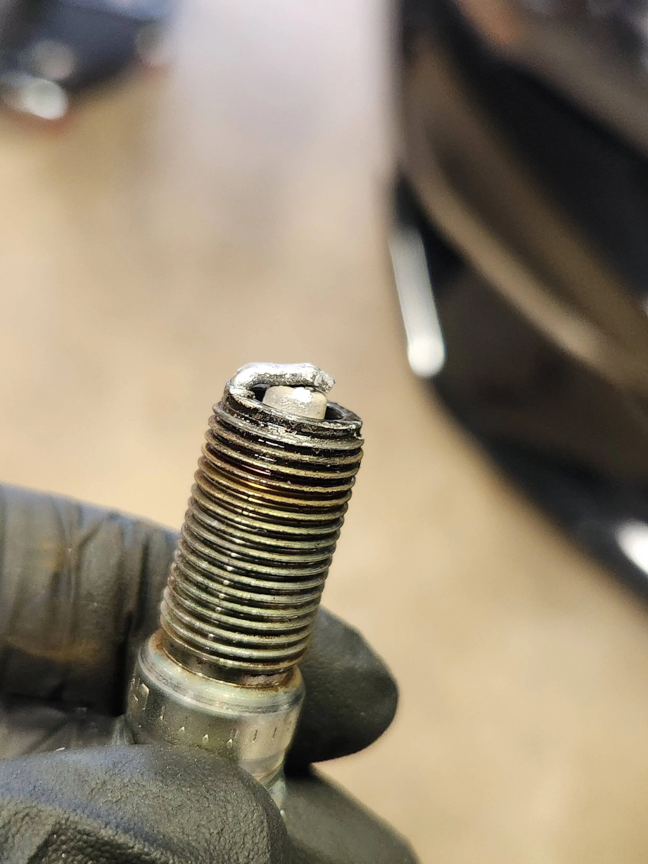

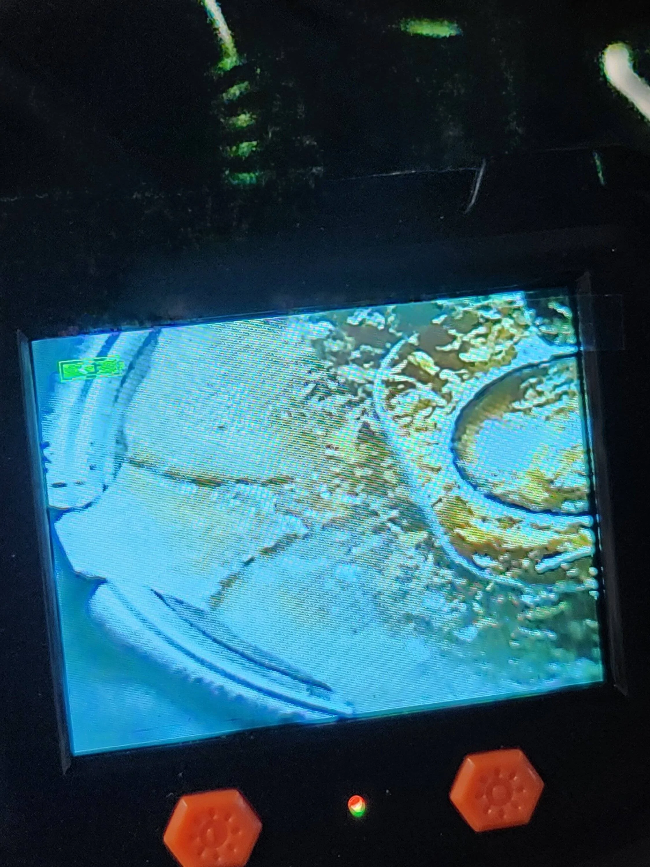

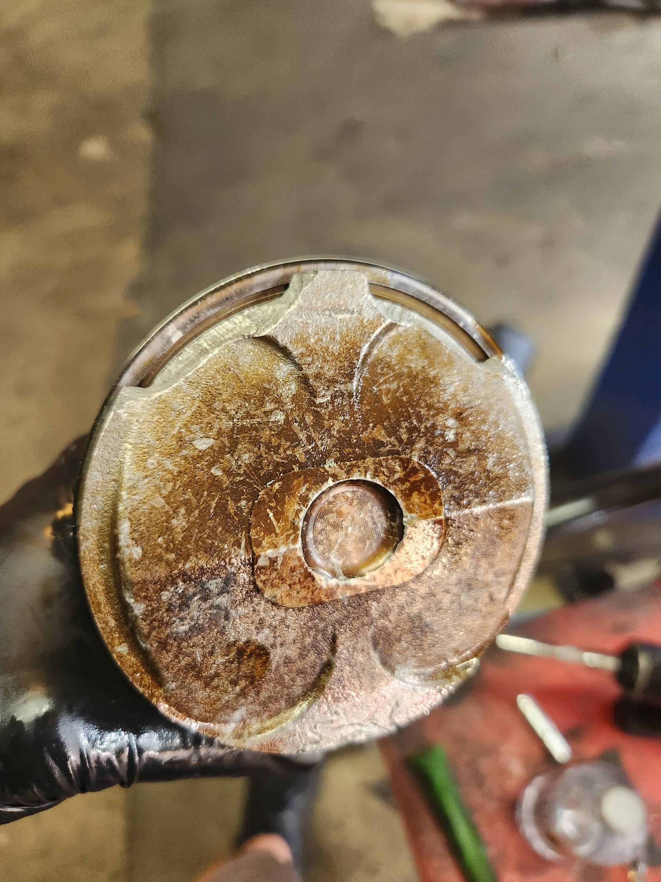

Pull a plug and look at it. If you have a boroscope, run it down in there and look around. Harbor Freight has a decent one for not much money. They sell some cheap ones on Amazon that hook to your phone. If you broke a ring land, the plug will look like the following pics and the top of the piston will be missing some chunks.
