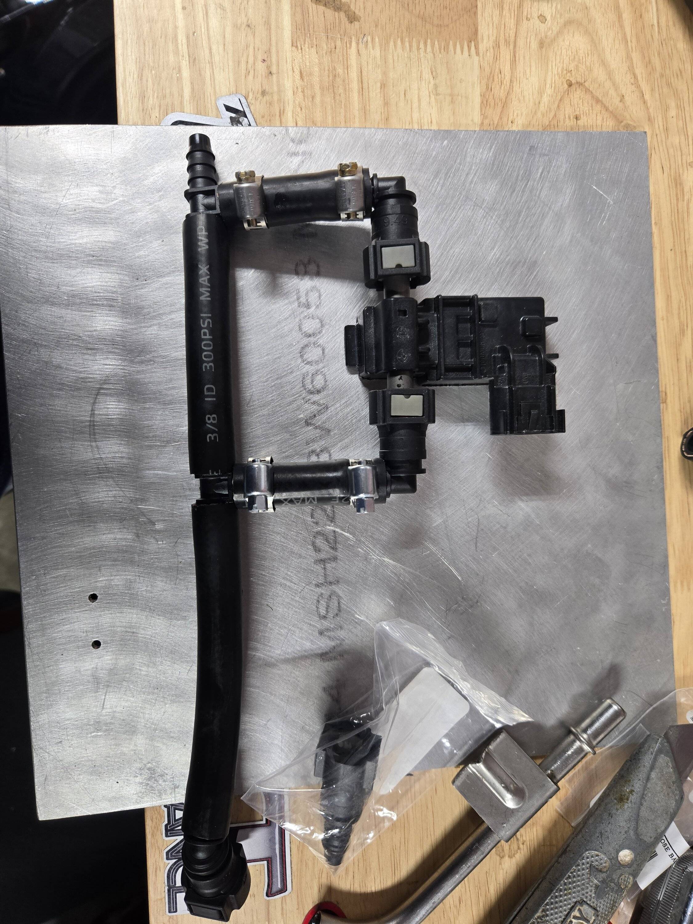

Looking for a bit of help. In the process of installing an ethanol fuel sensor. Read in the instructions that it's recommended to install on the return side of the fuel line. I'm still n/a & I'm assuming I don't use enough fuel even at wot for this to be an issue.
Would I be ok in just installing it in place of the fuel line right before the fuel rails? Or would I have to make a bypass?

I am NA. I just used the kit from Fuel It. Works just fine on the inlet side on a tuned Mach 1.

Right on, I was about to nount it just straight as well. Thanks
