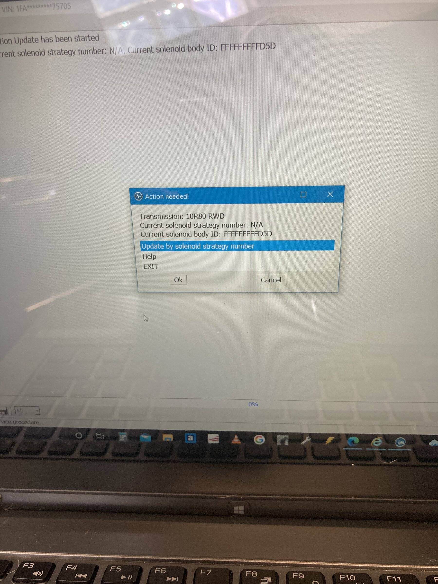

Open Forscan and connect to this Module

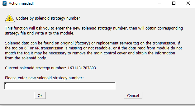

Select "Update by solenoid strategy number" and press OK
Enter Solenoid strategy number and press OK, It will ask you to download the info and press YES to complete the process. (Where to find the Solenoid strategy number below)

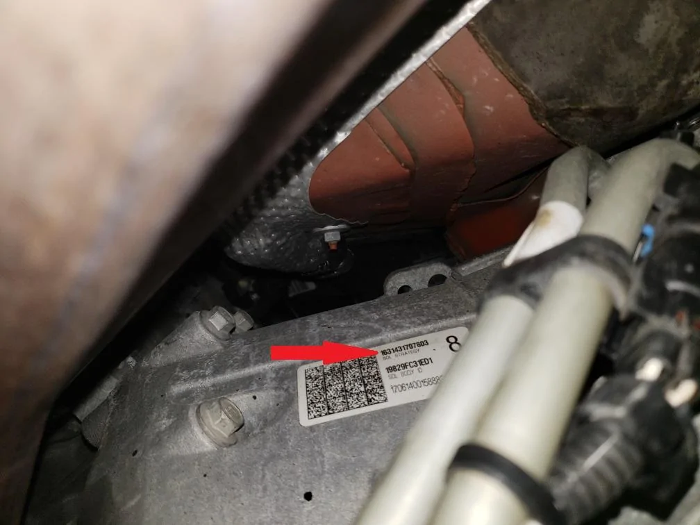

To find the Solenoid Strategy Number,
There is a white label with numbers on it attached the the driver side of the transmission. The number you need is show below.

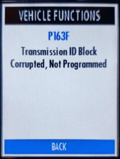

had this same thing happen to me code P163 .when flashing my E85tune w/ HPtuners on my2020 mustang Gt 10r80. This thread saved me some huge headache and money. thanks RoushStang…. Fixed with forscan. Strange thing is this same tune that worked perfect last summer, all I did was have a 93 octane tuned flashed over the winter for storage. Here is a picture

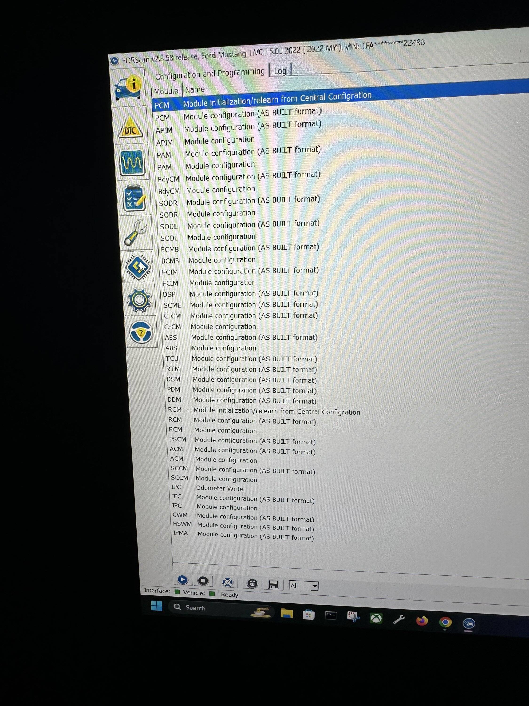

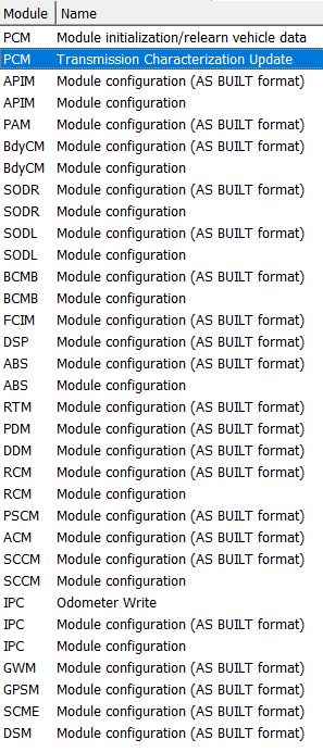

Bump. Ok what happens if you dont have the transmission solenoid characterization option?? I have a 22 GT and a fully licensed version of forscan and I dont have that option anywhere. Latest version of forscan too.
