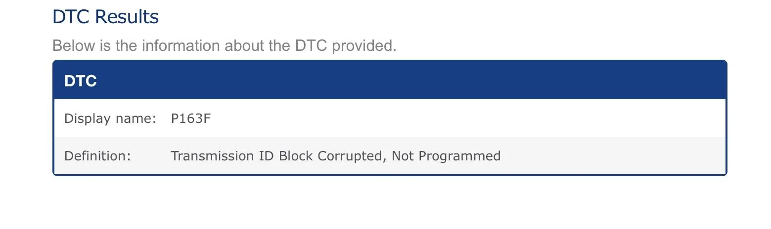

I apologize for missing the opportunity to help out a few forum members with this issue.
My issues were resolved by Brian at Finish Line Performance in Milford, Ohio. He had to manually input all of the calibrations for the stock transmission calibrations (for each gear) into the ECU. He said that if I would have taken my vehicle to a Ford dealer, they more than likely wouldn’t have been able to help me.
After the stock calibrations were loaded, Alex from Lund sent me new tunes and tune revisions - discarded the original tunes in case a file was corrupt.
Thankfully, I haven’t had the issue since. I’m definitely a little nervous every time I load a different tune.

Old thread, but Just an FYI this is the official Ford DTC explanation if a Ford Service Center were to start diagnosis:
