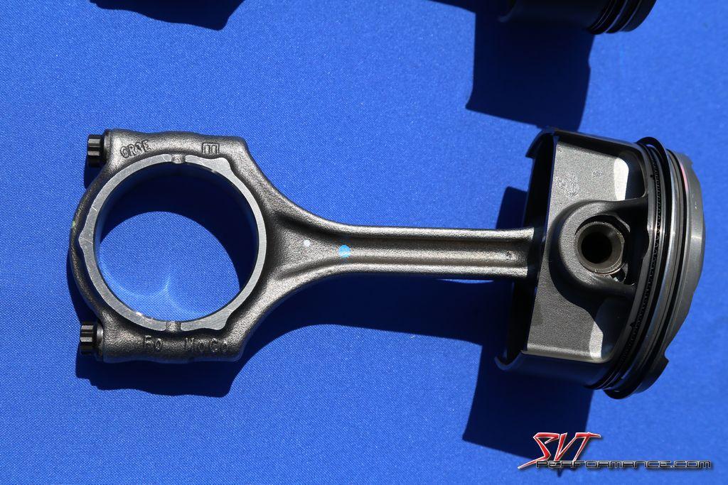

It could be piston slap. Some Coyote and Boss engines do it a little until they are warmed up. Good reason to let it warm up a few minutes before you drive it.
I'd have to hear it. Where in South Florida are you? I'm in Tampa area.
Ahem. :). This happens to be audible when cold (on my boss motor, which shares a similar piston design) but all cars with forged pistons experience a bit of growth. The alloy on these expands a little less than some so the pistons are installed pretty tight...but they still do it. It definitely doesn't mean it's worn out. Now, if you start hearing it even after the engine is warm, that will turn into a problem.

I was driving around the other day and thought I should mention something. The Voodoo engine has relatively small, light weight pistons in order to keep the rotating mass low. With the Voodoo engine design you should be careful not to lug the engine. Also, the car is geared very high, so 6th gear should really only be used at 70 mph and above and on very flat highways. 6th should never be used to accelerate.
What this means is don't open the throttle a lot at low RPM, especially in higher gears (4-6) and when the engine isn't warm. If you hear a rumbling sound, that is indicative of lugging the engine. This is not good at all for the engine and should always be avoided.
You really want to be at least at 2,500 RPM and preferably over 3,000 RPM when you step on it even in 1st through 3rd gears.
Maybe too late for some of you who are hearing piston slap now, but I hope for newer owners this might help some of you.
I agree on make an extra effort to make sure you're in the right gear on this motor and not ride out a gear at a low RPM because you don't want to downshift.
Are you suggesting that lugging the engine might have caused some piston slap for some people? The way I understand it, these pistons just need a little room to grown, considering their short skirts - and they just need to be warmed up.

Yes. I'm saying that this issue might have been exacerbated by lugging the engine, especially if it isn't warm. When the piston is cold it can rock in the bore more and if you floor it at low RPM in a high gear that's when you are more likely to do damage.
Once you've done it the engine is going to make more noise for the rest of its life.
