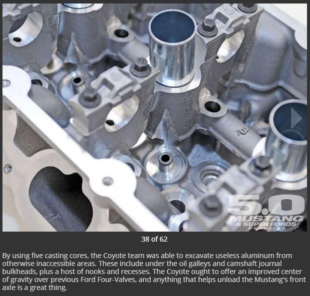

The main and rod bearings typically have a base coating of copper. The same goes for camshaft bearings, but some can have a copper outer coating.
The cam bearings in the Coyote are just plain aluminum ... just like most motorcycles use. No bearing inserts like on a crank or rod bearing.
