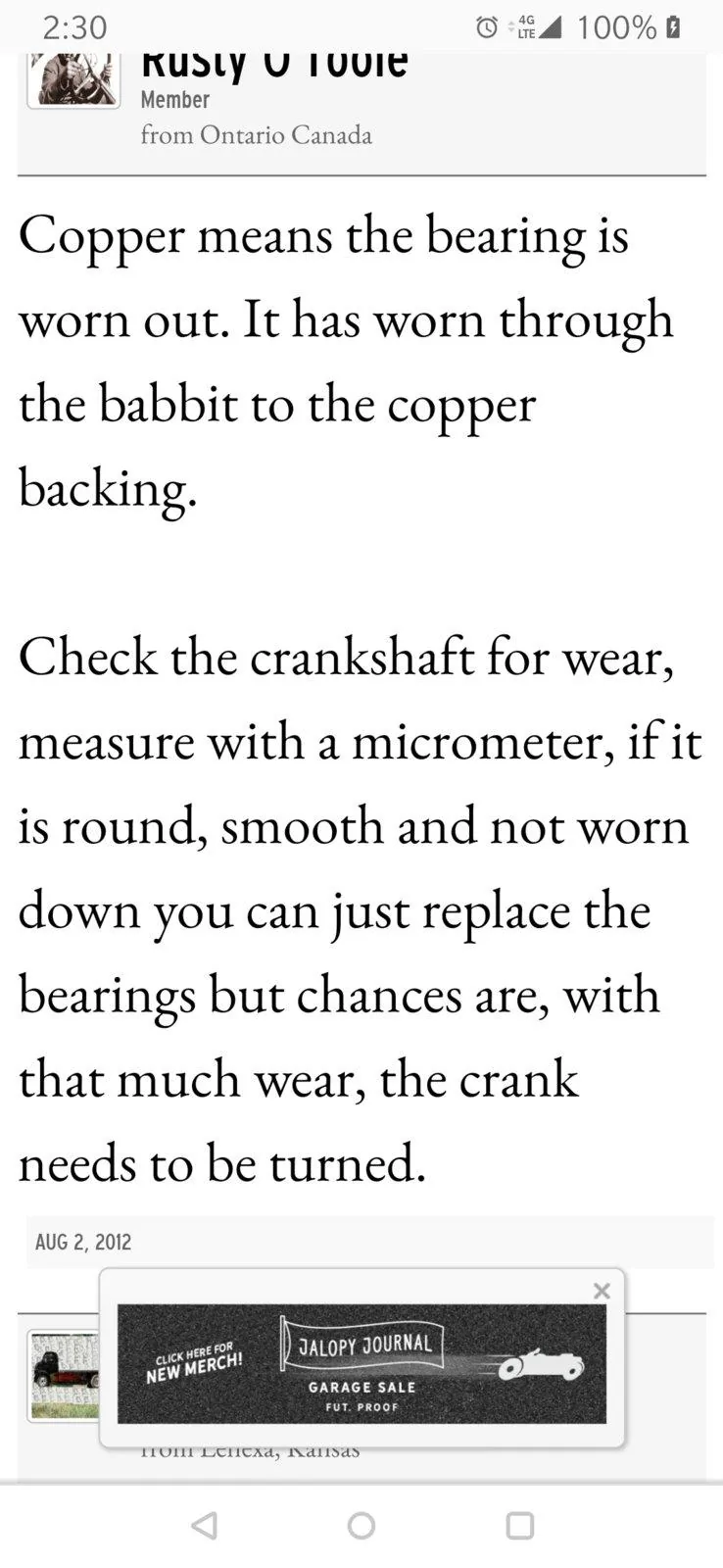

Curious .....What components in the motor are copper?

Certainly there are smarter folk on here that can elaborate on this but my understanding is the main and rod bearings would be the primary source.

In the notes from Black Stone:
There was a little extra copper, but
this seems to be just the second oil change for your Mustang, so wear-in can account for that. Copper
should wash and eventually look like universal averages
