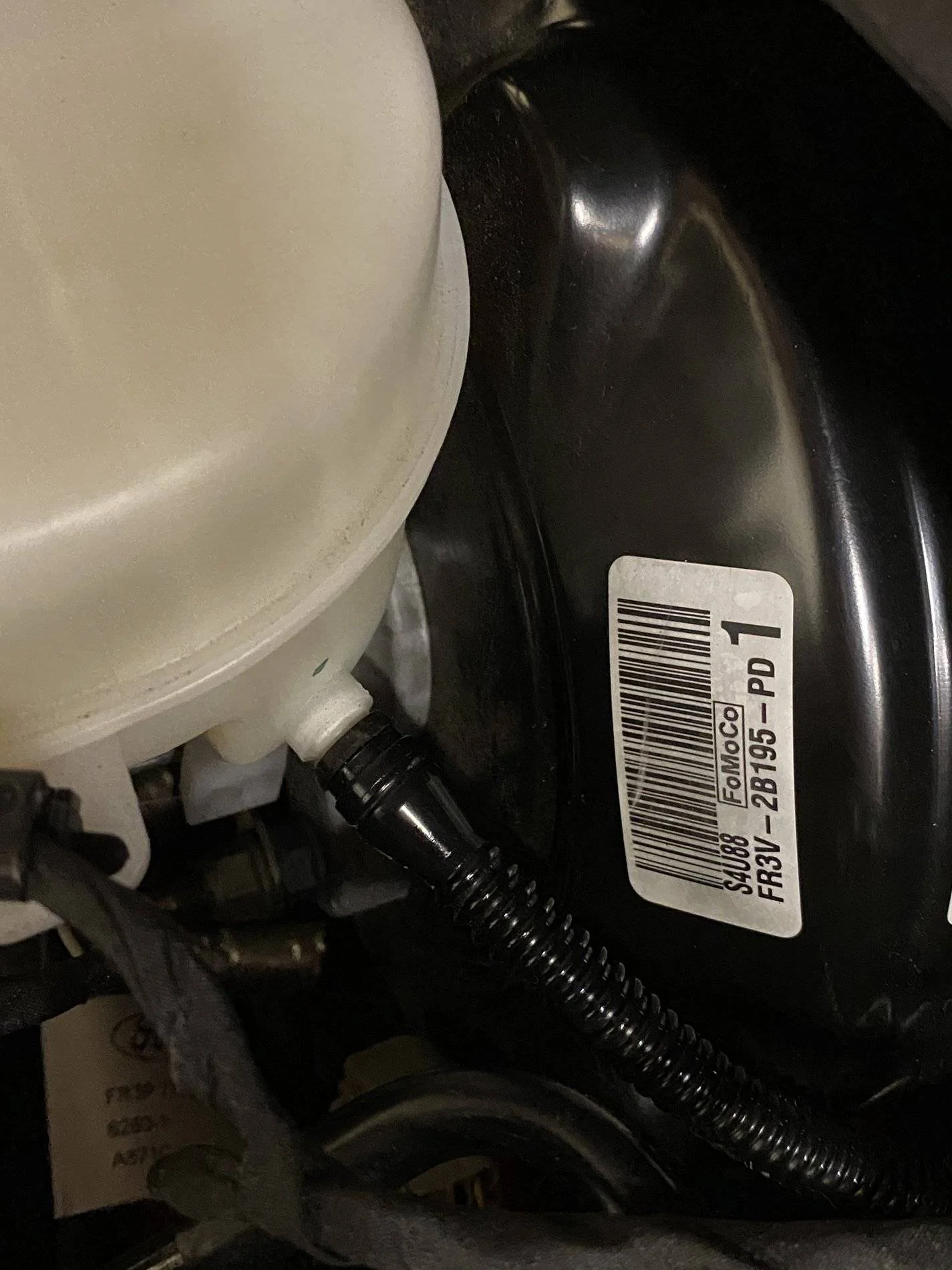

Rubyred17
Nov 10, 2018
54
318
204
Kentucky
Dan
2017 GT350
Is this the hose you are referring to? My 2017 hose was way back on the connection before I pushed it forward. How does it retain itself on there?

johnny1
Oct 30, 2016
769
372
Had new a 16 GT350 and 17 GT350
Not sure if there is a lip on the end of reservoir tip thats supposed to hold it or not but both my cars had some sort of a bit of glue substance that was brown around where hose goes on tip. But thats the brake reservoir hose I was referring to to check also.
