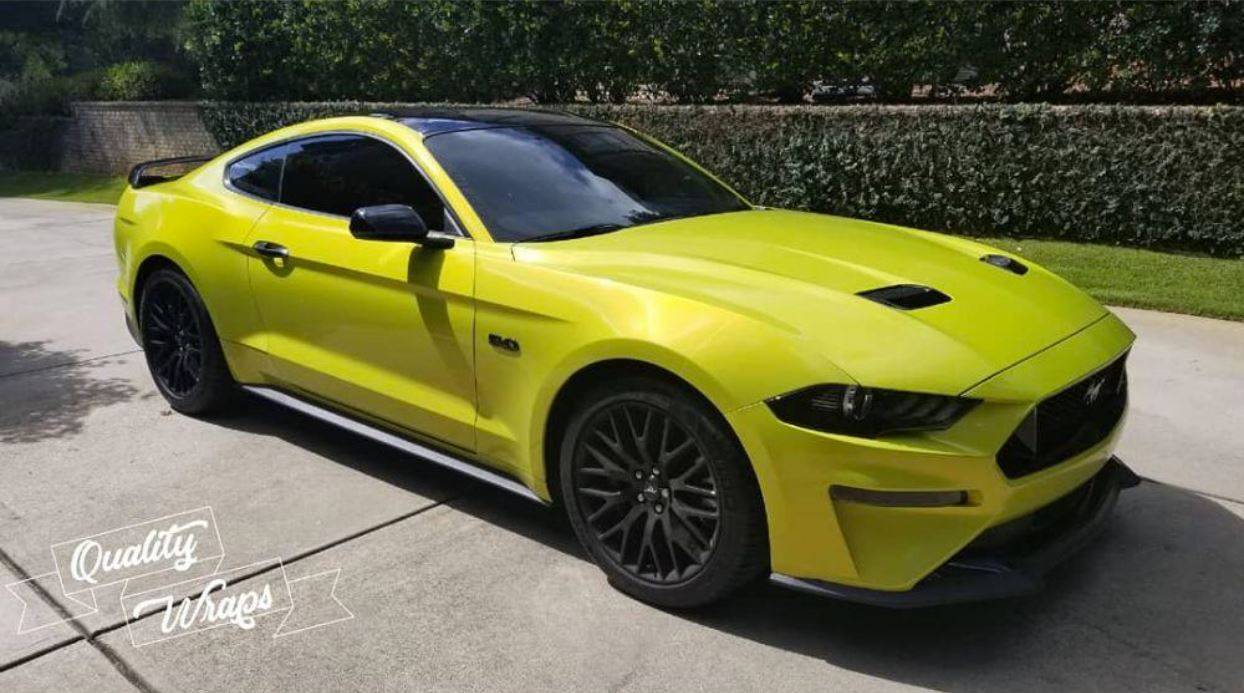

sorry to hear this man. My 2019 R has just over 500 miles. I hadn't heard about these valve issues until recently, I was only on the lookout for the oil issues. Now I need to keep an eye out for this too !!!
I hope you get the best possible outcome out of this. The yellow pinstripes looked bad ass.
The color is Solar Flash; it shifts from yellows to greens depending on lighting angle. Gives it sort of a toxic look that is pretty neat under natural lighting.
Internet sourced pic of a fully wrapped GT.
