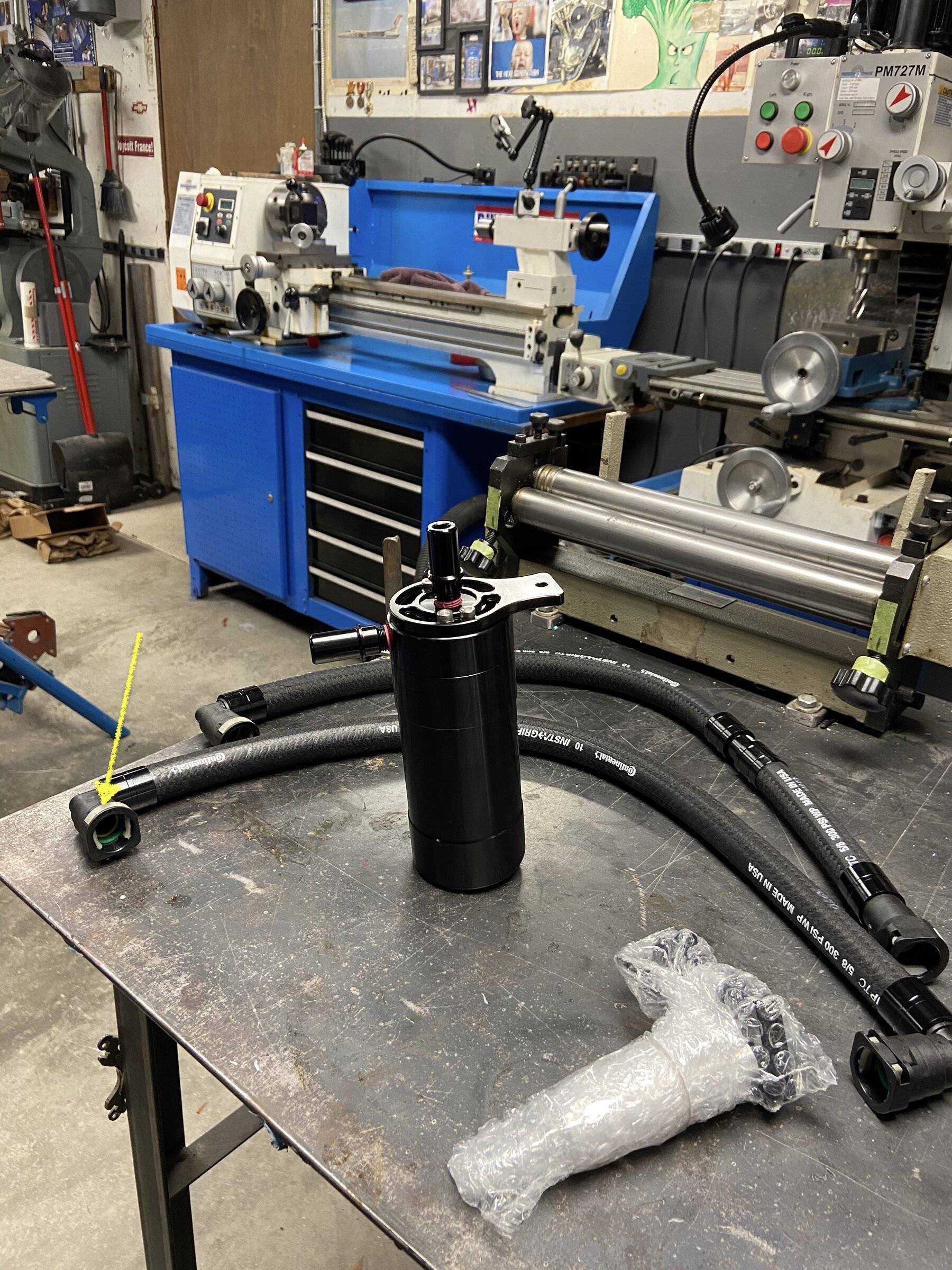

Not sure if this will help you, it is what the assembly looks like. It is a tight fit,

I have the Ford Performance cans. I open the top and soak it up with shop towels.
I just unclipped mine from the 2 connectors and poured it out like a tea pot.

How do you unclip the connectors?
push & hold in, that spreads the clip unlocking it.
