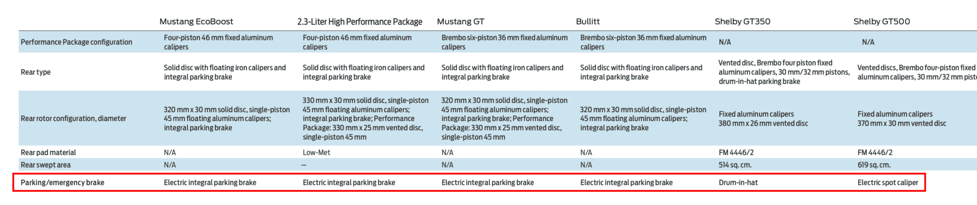

I was looking at the 2020 Mustang's technical specifications here, and something jumped out at me:
What gives? I hope they didn't put an electric handbrake in the 2020 model. Please tell me they didn't. :frown:

all the regular 2020's (not 350/500)that I've looked have the regular e-brake handle(with the idiot light in the cluster).
Only the GT500's have the electric e-brake button on the console.
the idiot light on the cluster may be the "electric" part they are describing in your screen shot

looks like a second caliper on the rear solely for handbrake duties - they list a 4 pot rear caliper as well so not the 350 style drum in rear disc brake - like 90percent of most normal cars and not the stupid integral handbrake rear brake caliper in the rest of the s550 range.

It's not apparent in my screenshot, but the specifications are for the American version. I can tell, because the GT is listed as 460 HP, and the Bullit as 480 HP, whereas in Europe they are 450 HP and 460 HP respectively.
