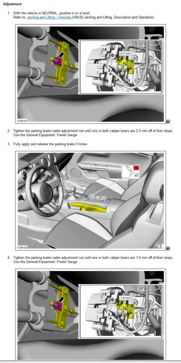

My parking brake lever is sitting higher than it should, very close to where it triggers the parking brake light to come on. I've bumped it lightly a few times and had the brake catch a bit while driving. Any way to adjust this without taking it in to the dealer? If it's a huge pain in the ass I won't worry about it.

Here ya go!
