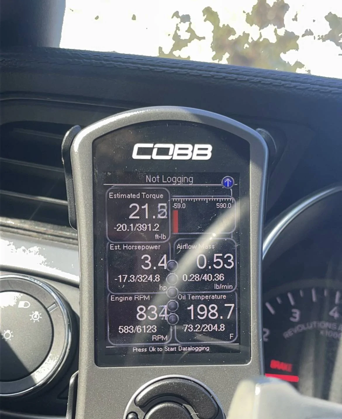

I have a 2020 Mustang Ecoboost with cobb stage 2 tune and a roush intake. I am getting around 360 torque and 320 hp. Is that what I am suppose to be making because sometimes i make more and sometimes i make less. I get the horsepower and torque numbers on the cobb v3. Also what mode is the fastest, I have a premium with sport, sport+, track, and drag. Stage 1 also got 417 torque and 326 hp. The pic below was today im on stage 2. Also how accurate is the estimated torque and horsepower on the cobb v3.

Do you understand the definition of "estimated"?
And how have you already worn the finish off the rotary knob for the lights, and the surrounding trim?
Anyways......your power and torque will go up and down with many other variables. Real life isn't Gran Turismo, things aren't static.

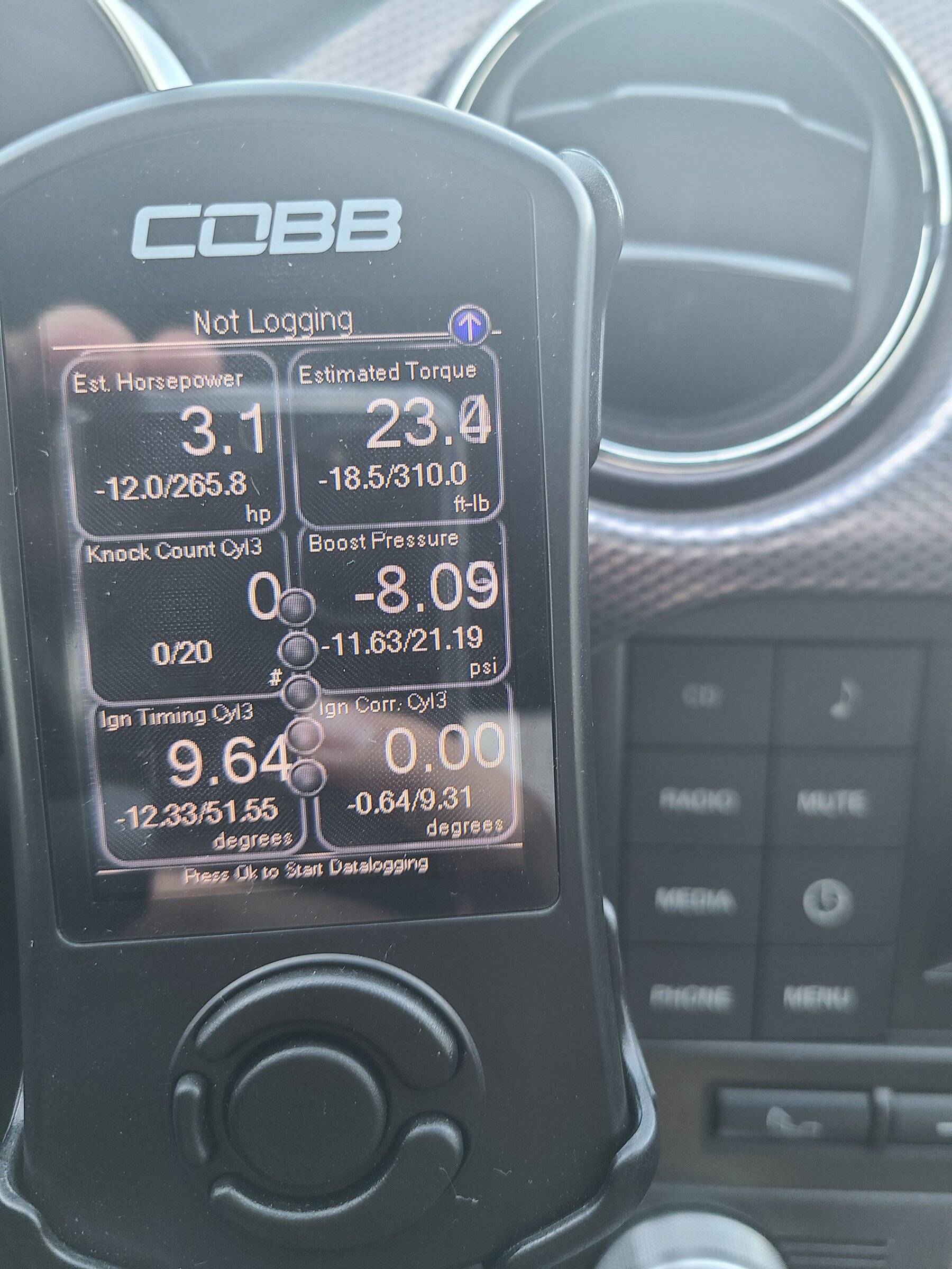

Was looking at some old pics i took and Seems pretty good to me. On my 17 with CAI and upgraded intercooler I was pushing 265 HP and 310 torque in first gear and that was only my 4th revision I believe with PD tuning.
its just the lighting
