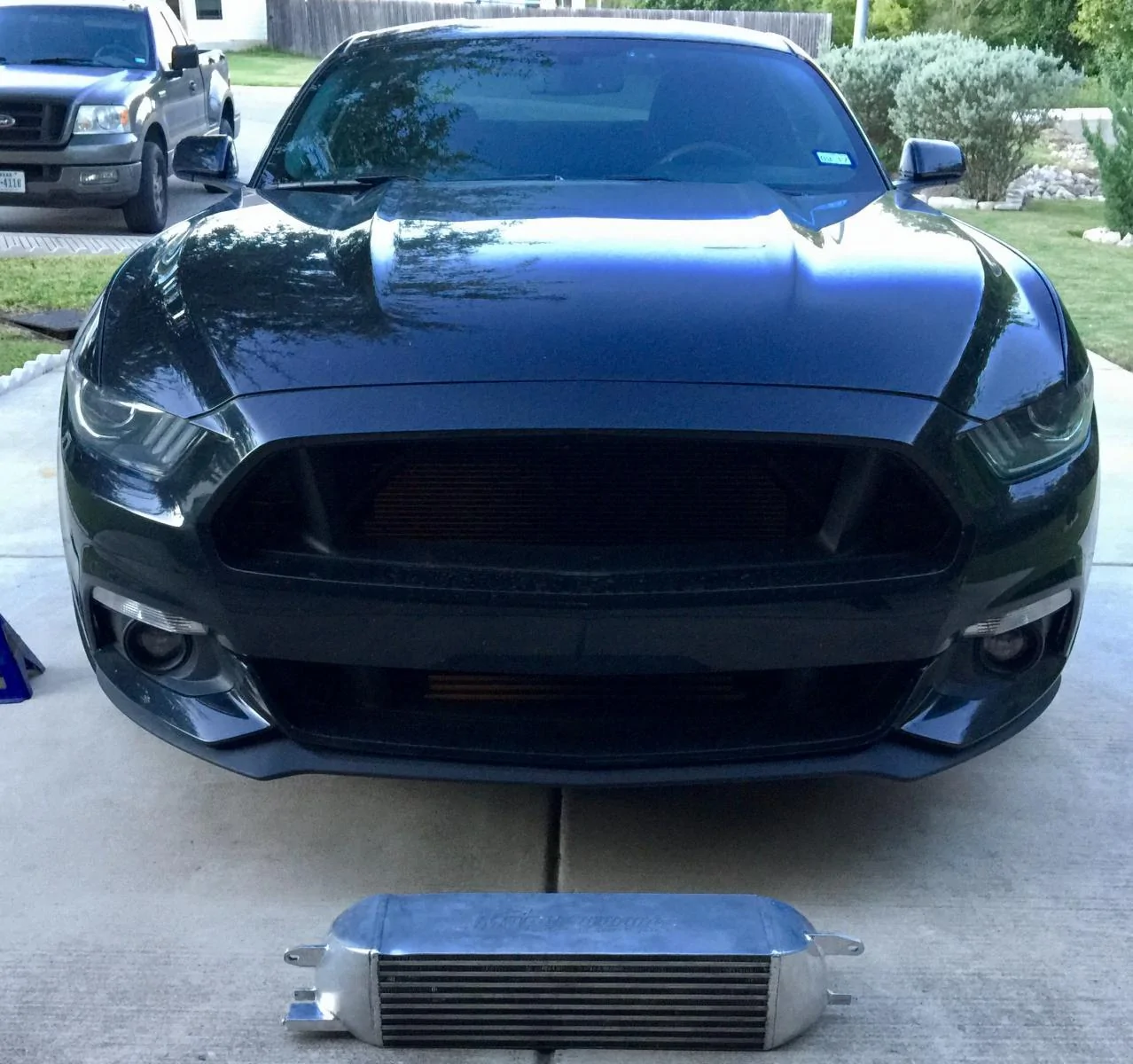

Just installed a MAP intercooler couple days ago! This should've been my first mod. Temps are super consistent now and never go over 118-128 degrees 91-99 ambient temps. San Antonio is humid as hell also. I really tried to heat soak it but temps stayed the same.
Over the course of three days street/highway driving
Stock intercooler:
91-99 ambient
115-158 charge temps!!!
MAP intercooler
91-99 ambient
102-128 charge temps!

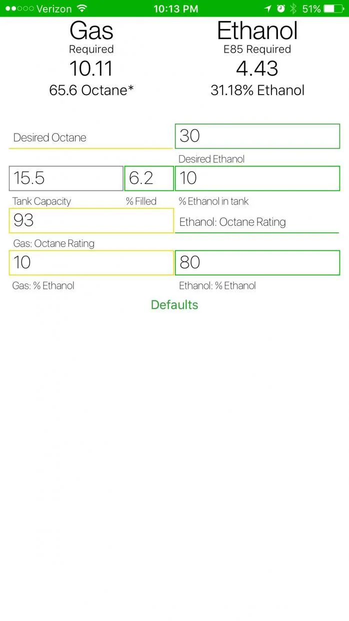

I'm really impressed how much this made my butt dyno feel. I just sent my first log for E30 but to be honest I'm not sure I'm using the calculator properly.
The part where it asks "%filled" is where I'm not sure I'm putting the right numbers.
(Tank size) X (Fuel level input) = number of gallons left in tank
But the app wants the percentage............wow well I just answered my own question while typing this out.
((Gallons left in tank) / (Tank size))X 100= percent of gas left in tank
If there's a quicker way please by all means chime in, I'm all ears.

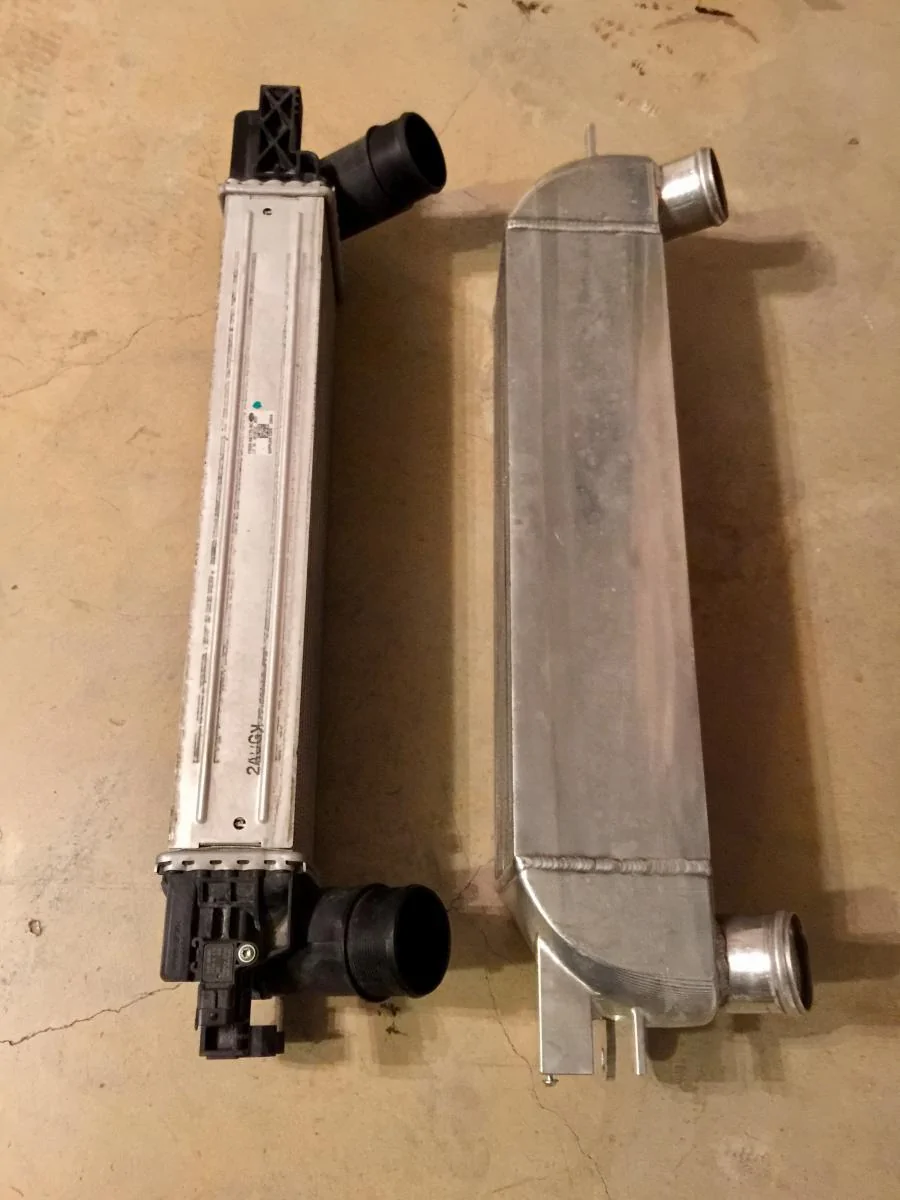

Size comparison and E85 calculator app screenshot

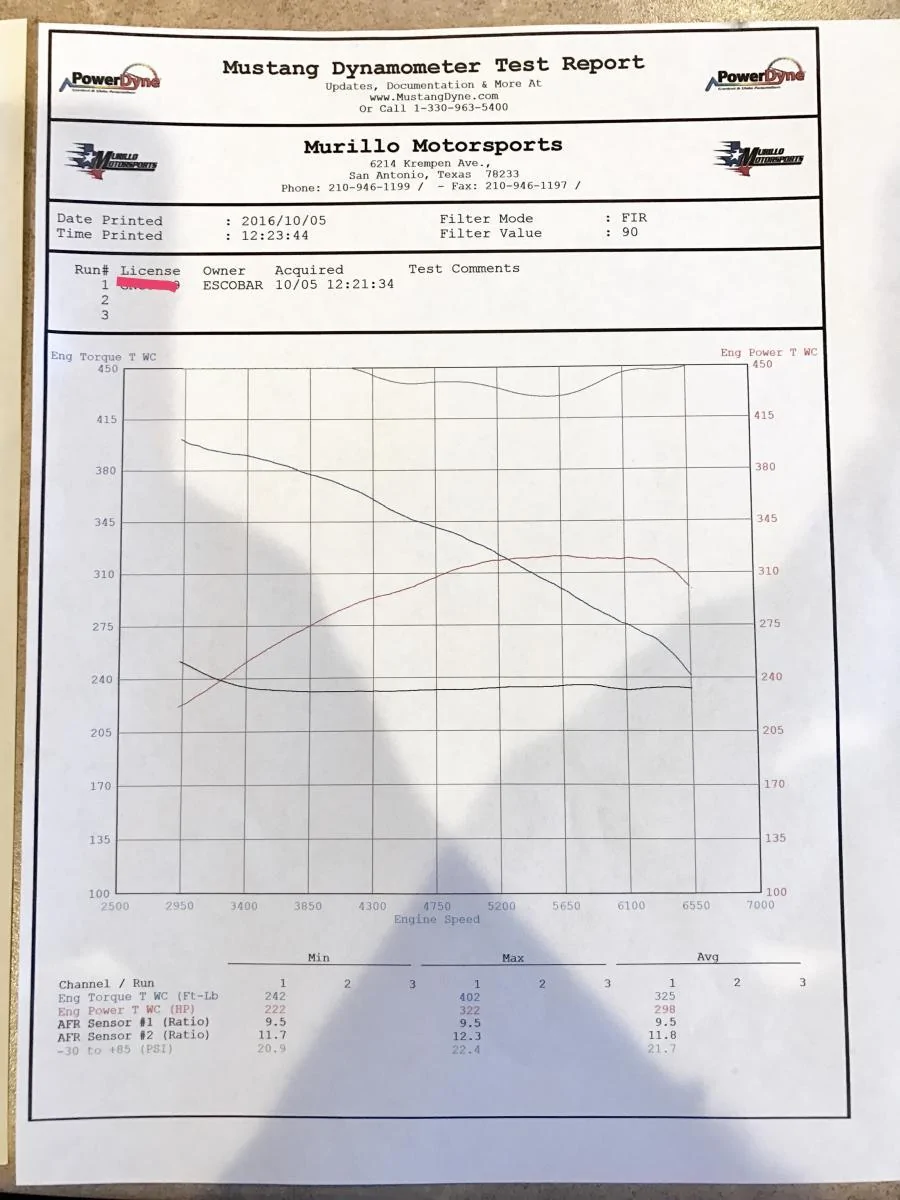

Dyno graph below:
91 ambient
133 charge temps

The easiest way I do it and I don't even use a calculator. Once your e85 is tested or you knkw it's good, when it's on empty, just use 4.1 or 4.2 gallons e85 then the rest 93, it's not complicated and you shouldn't need a calculator. I do it all the time, never one issue other than mashing the gas more now

The Fuel Level Input gives you the percentage already. So, no extra math is needed.

No, you need to use the correct percentage of E85 from the pump to achieve the E30 mix and not overtax the fuel system, and starting with a base gasoline octane rating of 87 would not give you enough octane after mixing with E85 to see the benefits of the specific tune.

Oh! Haha I knew I was doing something wrong, thanks for the input.

What he said.... E30 with 93 > with 91
Basically 91 e30 is only a bit over 94 octane. 93 e30 is a bit over 96 octane

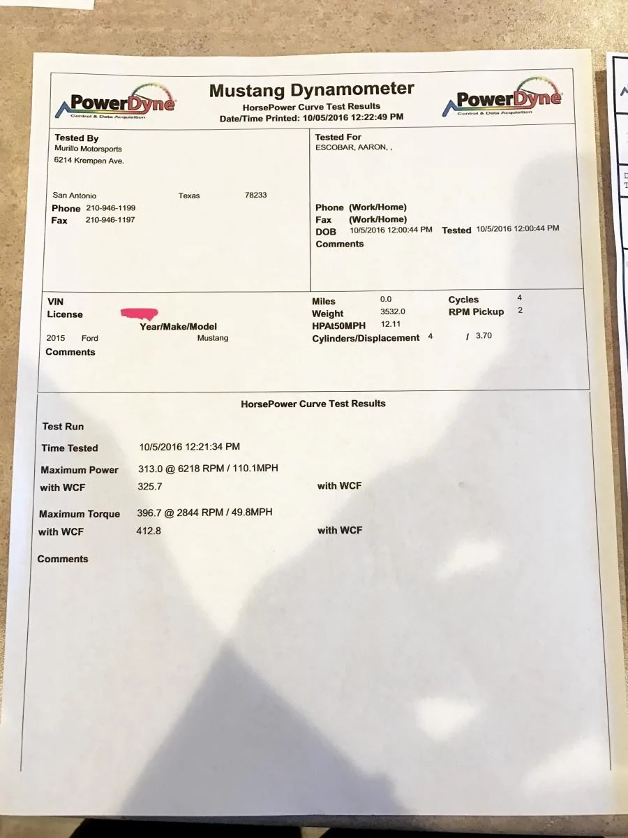

I went ahead and add pics of the dyno run today. It got hot outside quicker than expected about 91 so charge temps were really high but im real happy with the results.
