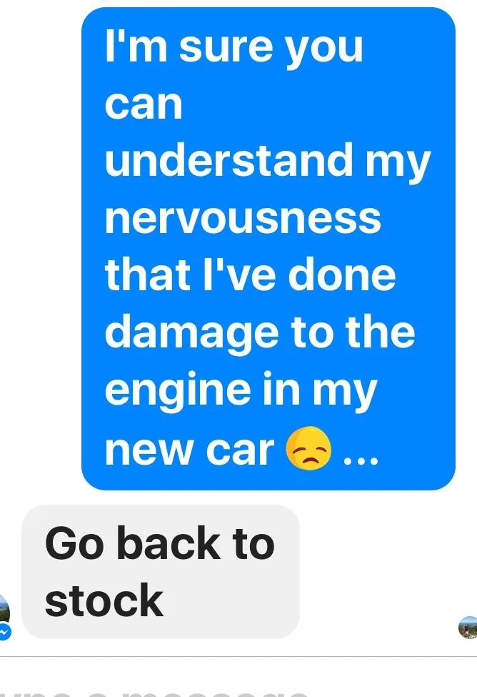

I would try and take it up with him personally first. Even further than you have before you come to the message boards. I don't mean that in a rude way, just give the guy a chance. Tell him your not comfortable with his response and u need help. Then if he doesn't get back, which I'm sure he will, then air out your grivience. Good luck. Oh I don't care what your charge temps read. Don't push e30 without proper supporting mods

Car has a cat-back exhaust, Roush CAI, and a tune that I am managing with SCT X4 tuner. I was running the 91 Tune (I'm in CA and 91 is the best we have) with no issues.. ran good. Decided to give the E30 tune a shot - put 4 gallons of E85 (minimum 70% according to label at pump) in the tank with 10 gallons of 91, and installed the E30 tune. Today on my 3rd day of driving it with the tune, I was going to work this morning (cool air, low 70's), and on one of my acceleration runs (I was data logging at the time so I could send it to the tuner to fine-tune it), it sputtered really bad and lost a lot of power .. I immediately let off the gas .. the check engine light was flashing/blinking at me .. after maybe 20-30 seconds, the light went off, and the engine smoothed back out. I completed the data log, and then checked to see if I could retrieve a code, but no luck.
On my way home from work (it was warmer - mid/high 90's), I got on the gas again at one point, and the same thing happened .. sputter at higher RPM (about 4800-5000 or so) and loss of power. Check engine light stayed on this time (I was not data logging) - code was P0301 - cylinder 1 misfire. engine smoothed out again after about 20 seconds.. got home, and per the tuner, I checked my plugs for proper gap - they were all at .028, where he said they should be. Sent him a copy of the data log file from the morning run and he couldn't conclude what happened... said he could turn the boost way down if I wanted. I let him know I was a little concerned about damaging the engine in my brand new car - his response was "put it back to stock".. I was hoping for a bit more assistance in figuring out what the issue was here... of course, I am nervous about damaging the engine in my 2 month old car, and I'm trusting my tuner to sell me a tune that will improve performance but not blow up my engine .. is that too much to ask?
I still have about 1/3 tank of E30 - is it ok to put it back to a stock tune with that in the tank? If the engine is about to blow, I want to have it on the stock tune if that happens.
You haven't mentioned which plugs you're running. On cool mornings with Ethanol blends in the tank, it's not unusual to experience a cylinder misfire on a cold start. Are you running the factory plug, factory heat range or something else? Also, it does sound like your mixture maybe a little off, you should be able to see this in your STFT and LTFT's. However, a 31% blend shouldn't throw things too out of whack if your tuned for E30. That's well within the ECU's compensation abilities.
Just baby your car on the E30 tune until you can get the fuel level down to an 1/8th of a tank then refill with normal 91 and reflash with your 91 tune. If your plugs appeared to be in good shape, it's unlikely that you've damaged anything.
I would recommend talking with your tuner to make sure that you're set-up is compatible with running ethanol blends. You don't necessarily need an upgraded intercooler to take advantage of blended fuels. You just need to make sure that your tuner actually adjusts your tune based on the fuel you intend to run, and the existing modifications you have. Creating a custom tune for your set-up should be well within the capabilities of any qualified tuner if they review your datalogs and make's the necessary adjustments.
Invest in an ethanol tester to make sure your blends are truly at the intended percentage. A little diligence here will go a long way.

Thanks - yeah, I'm running stock plugs. My only mods are:
Roush CAI
MBRP cat back
Tune
Levels IC has been ordered
He knew this when I ordered the tune from him (because he asks for all mods) and never indicated that an E30 tune shouldn't be used yet...
The engine had definitely warmed up by the time I got on it - I don't ride it hard until it's up to normal operating temps (180+), so the misfire shouldn't have been related to it being cool.
And the plugs looked ok - coloring was even on all of them. I cleared the code this morning (check engine light was still on for the cylinder 1 misfire) and drove to the gym and back home - no issues, but then I never got on it either.. I'll baby it for the rest of the tank and fill up with 91 and put it back to the 91 tune tomorrow.
Thanks for all the help!!
