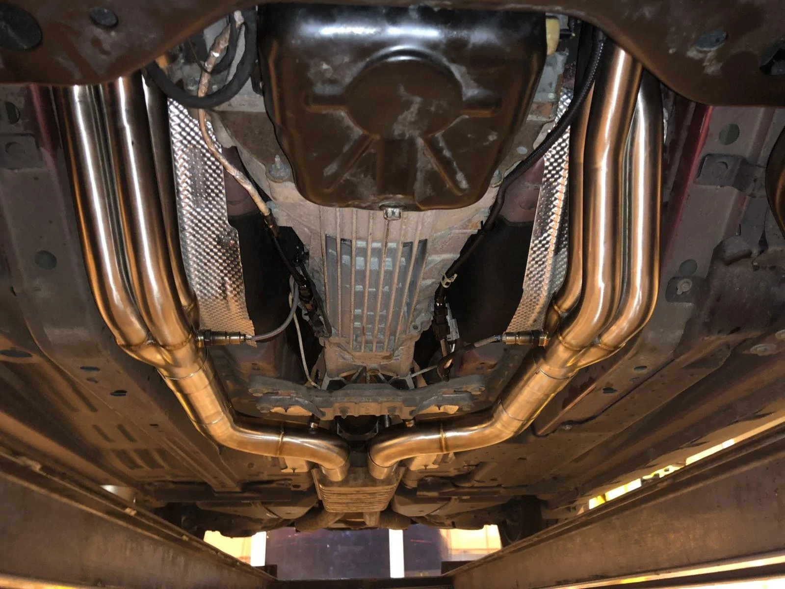

I have these installed on my 2017. Figment is great, has the power spike and all. They are the SW headers with the logo ground down. I have the bolted up to a Magnaflow street series 3” catback. I had exhaust shop cut out reducers and weld in 3” pipe to match the collectors. Sounds amazing no drone and some good power.

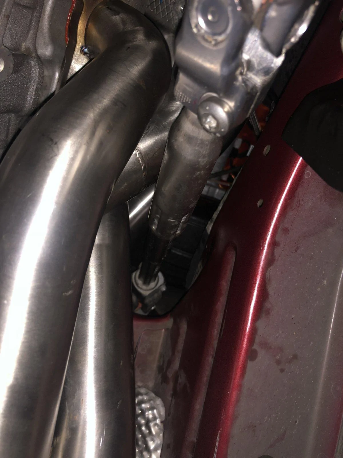

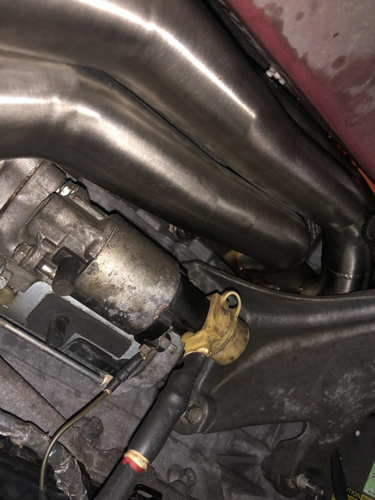

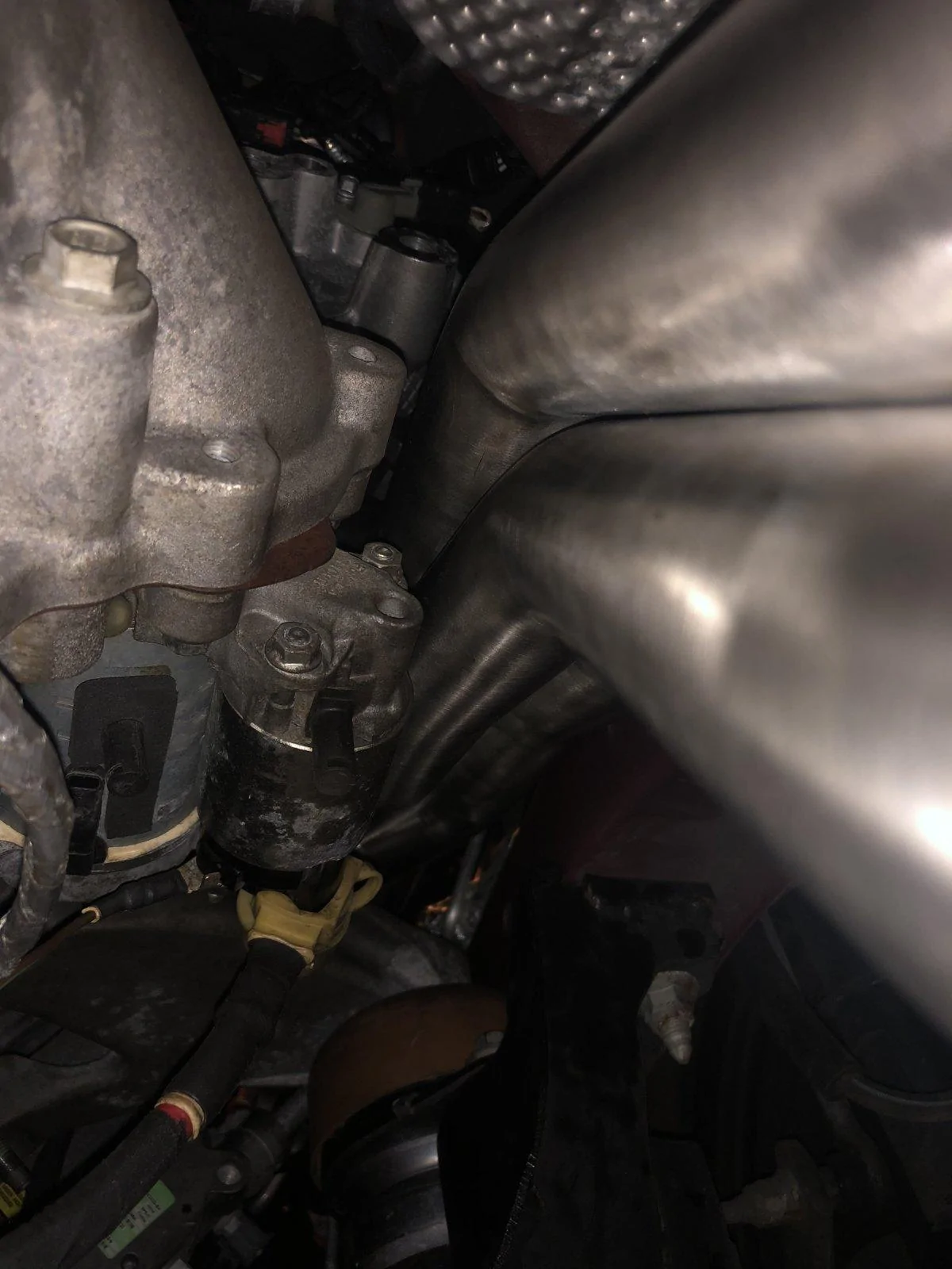

I finally installed the on my friend's mustang and they fit perfectly! No issues at all.

Were you able to use all the studs?
Yes. Driver's side didn't remove any studs. Passenger side-removed the bottom studs and reinstalled after the headers were mounted.
