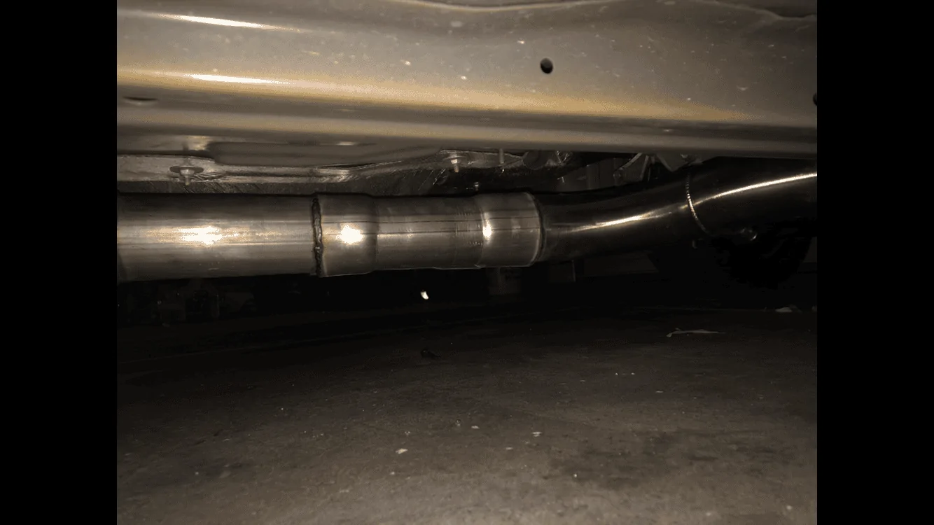

since My cat back is 3” except where it comes to 2.5, I decided to have an exhaust shop weld in a 3” piece across instead of having it bottle down to 2.5”

Go ahead and pick them up i installed them for a friend and they fit perfect, they’re better quality than the BBKs I used to have on my car and my friend has put almost 2k miles on them and they look really good only thing is u might have to fab something up to connect the mid pipes to the cat back nothing an extra 30$ can’t fix
