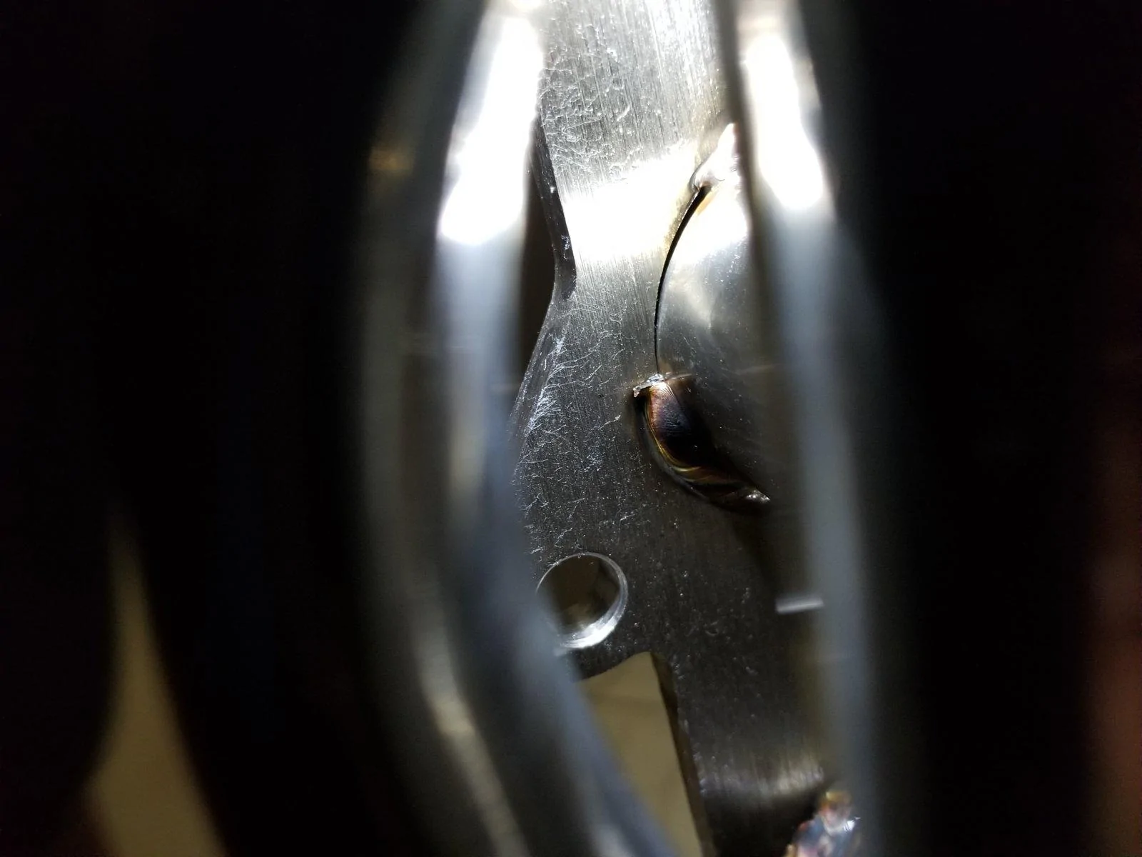

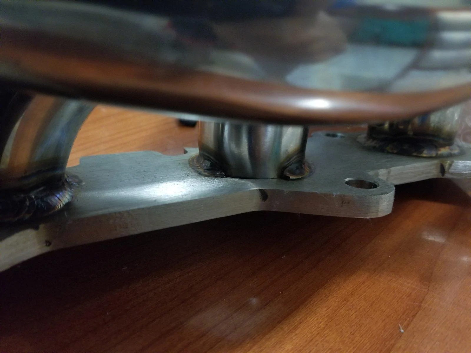

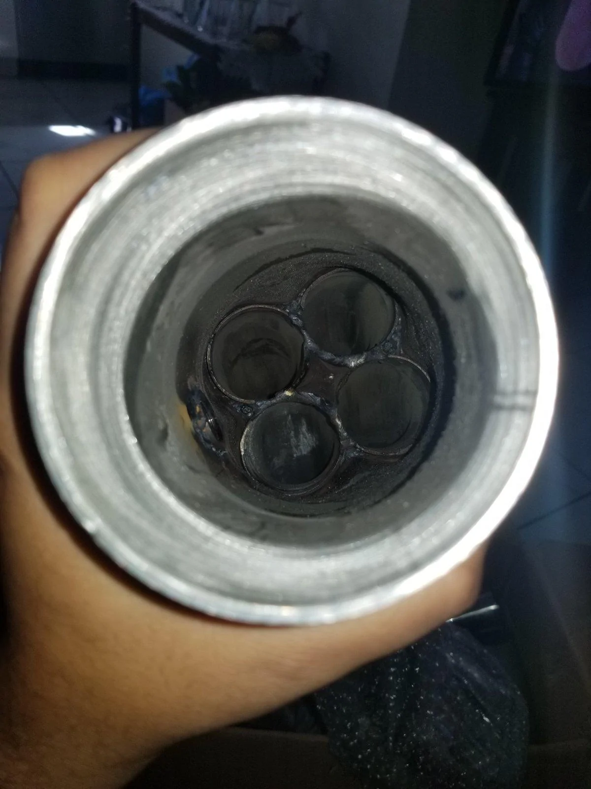

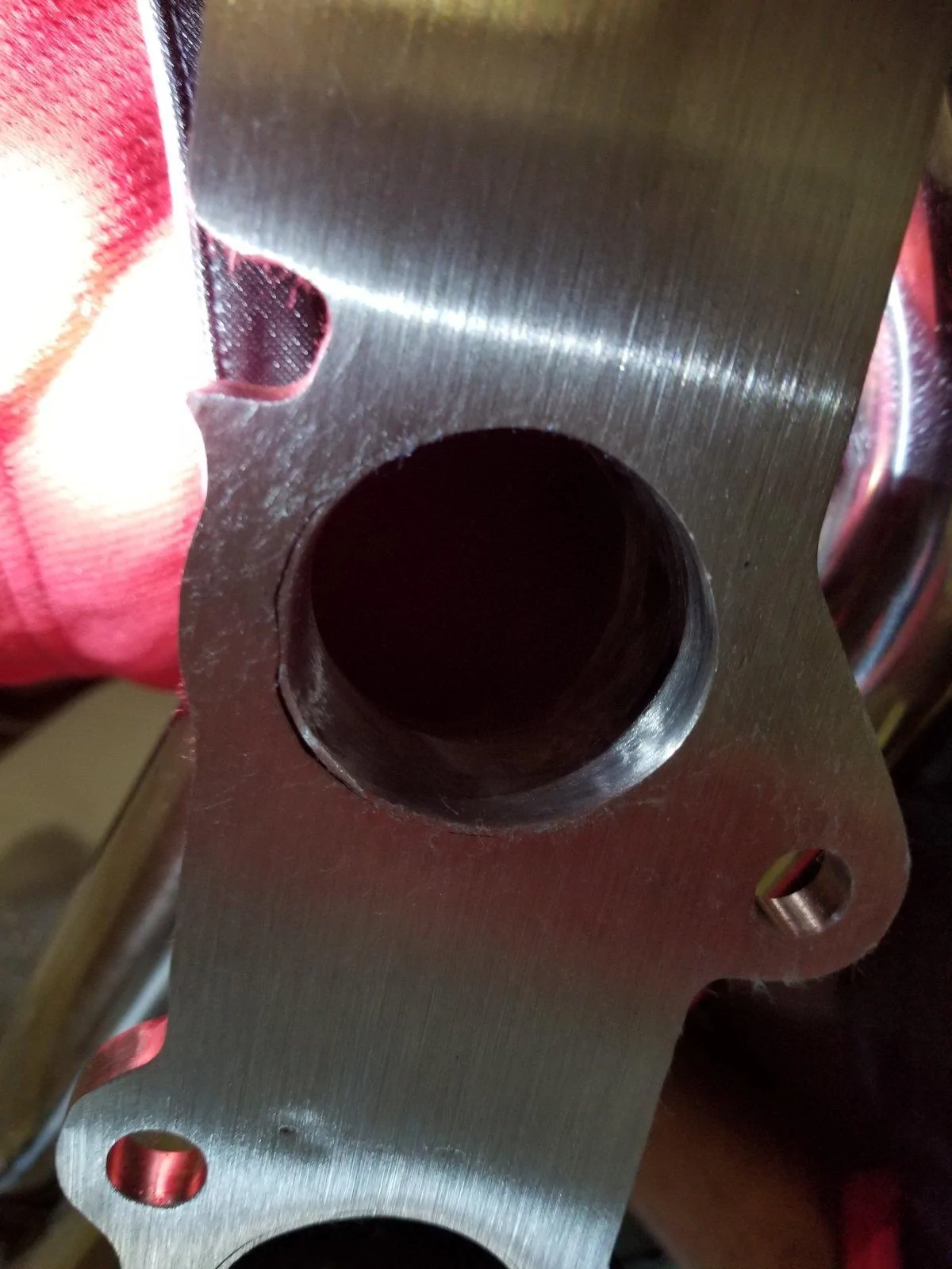

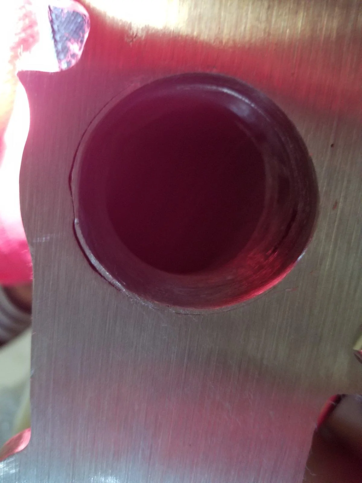

About three weeks ago i ordered a set of OBX headers from ebay due to the positive feedback iv seen about them. Received the headers very nicely packed however Fedex always finds a way to tear up boxes . Upon further inspection of all the welds i found a few spot that looked unfinished and the big shocker which was the headers flange to primary tube welds had unfinished welds on both sides. I tested for leaks using w40 and spraying directly into the unfinished welds and fluid could be seen coming out the opposite side. Asides from that the quality of the tubes were on point. It was really a shame that they had come this way. I decided to return these and went with a set of TSP just to get away from any possible issue that may come up during or after install because of the lack of quality control. Enjoy the pics :beer:
