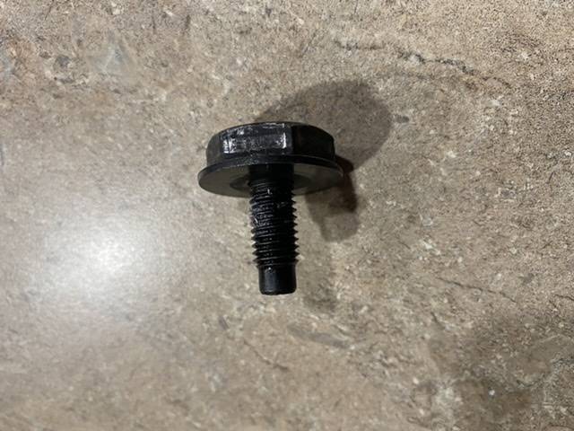

One thing I just learned is the bolt is TTY meaning one time use only. I didn’t see this mentioned anywhere else.
long story short the bolt came loose last night while driving. Steering wheel was completely loose and wobbly. Thankfully I was close to my house.
The bolt has thread locker from the factory and looks like it backed out and locker was almost gone. I bought a new bolt and waiting for delivery.

good to know. do you apply loctite to the new bolt or does it have something built-in?

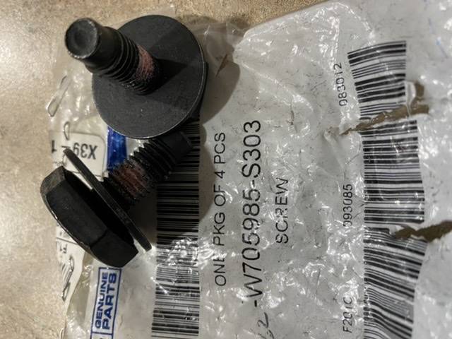

Bought a pack of bolts. Comes in a pack of 4. Bought these from eBay. Only $9 shipped or was $5 for 1 bolt. Comes with a tiny lock tight on the bolt. I added some more blue lock tight just in case. I don’t want my steering wheel coming loose again. And I have spare bolts just in case.

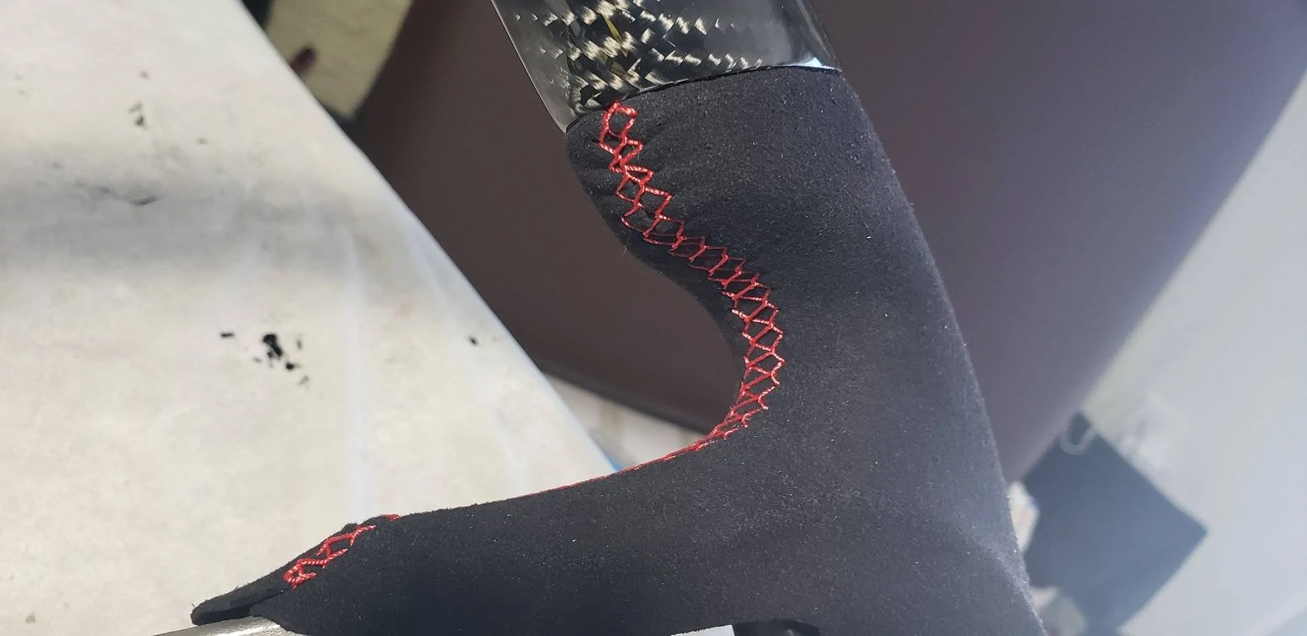

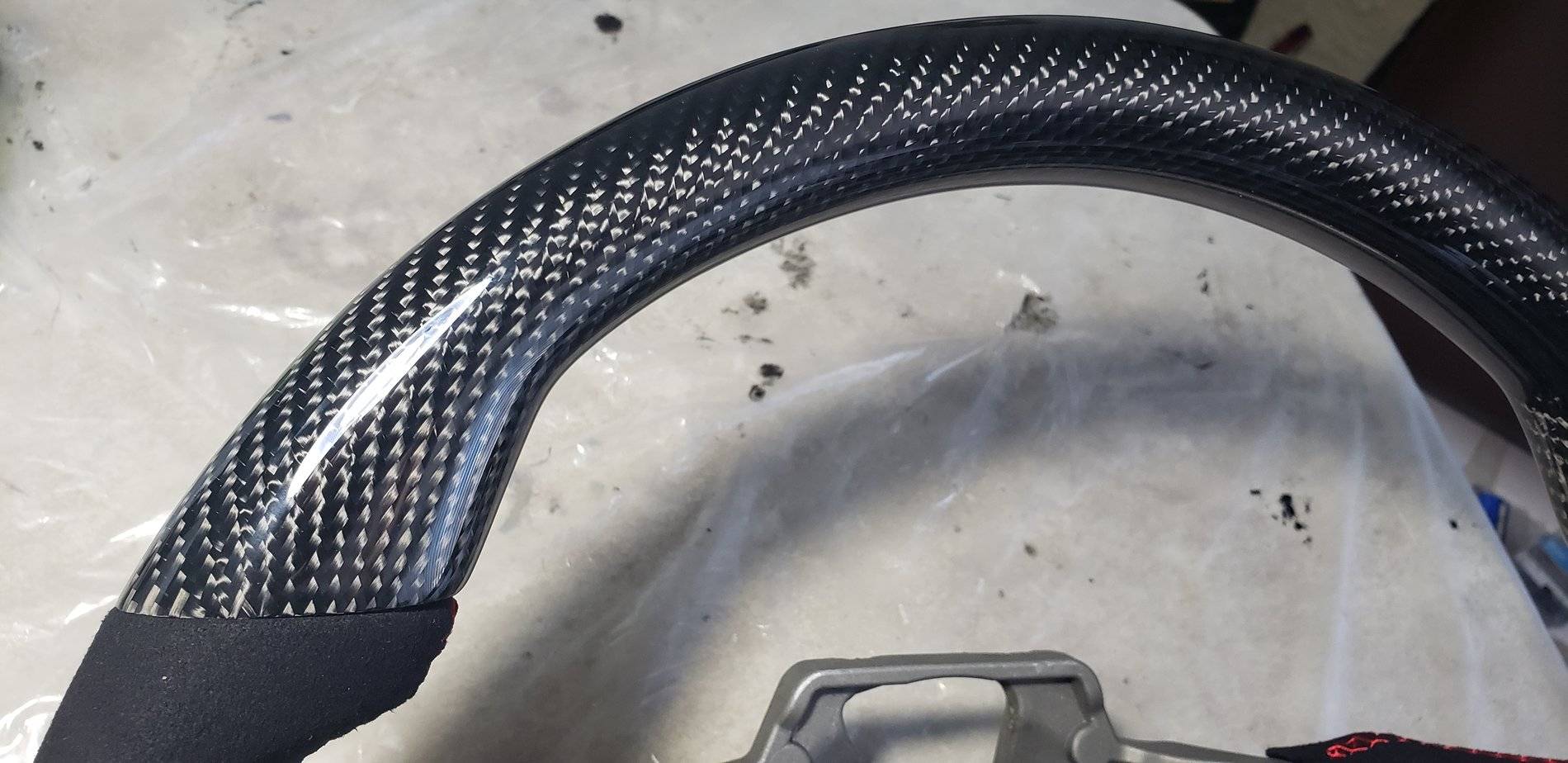

that does look really good. the CF weave looks great

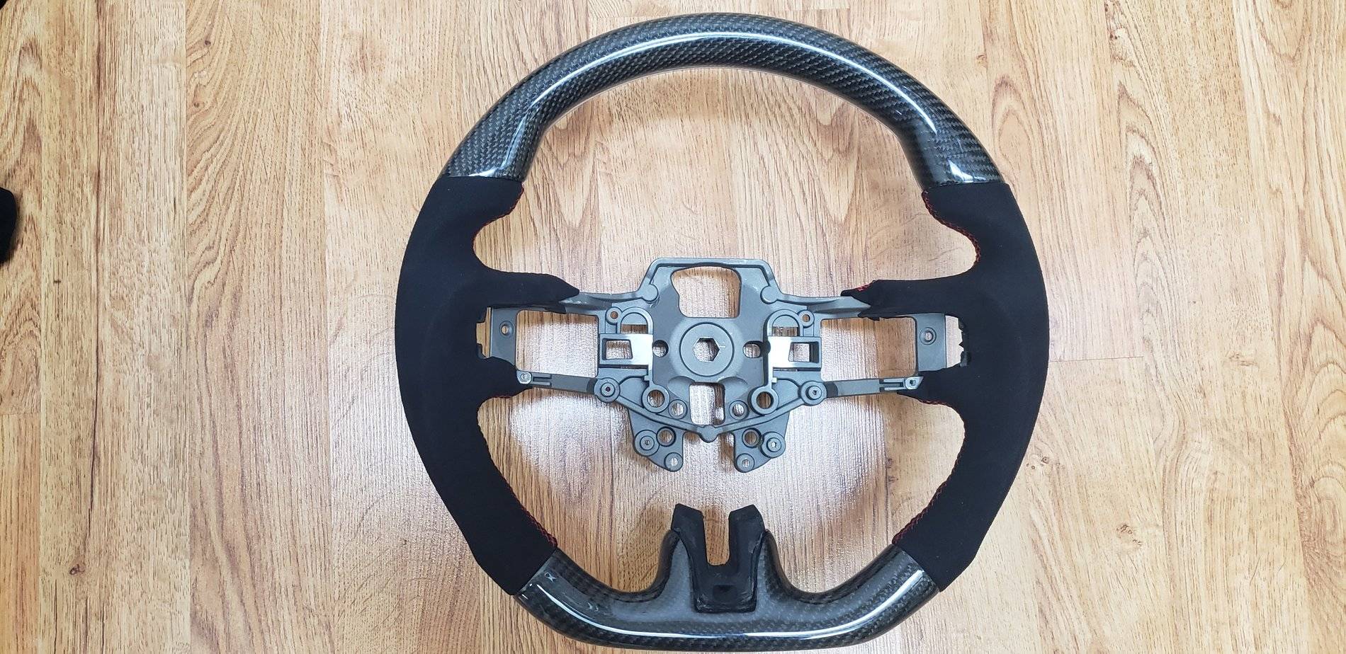

I have a really nice one I'm putting up FS soon. Made custom by a guy in SoCal. 100% OEM core. Carbon fiber and alcantera.
