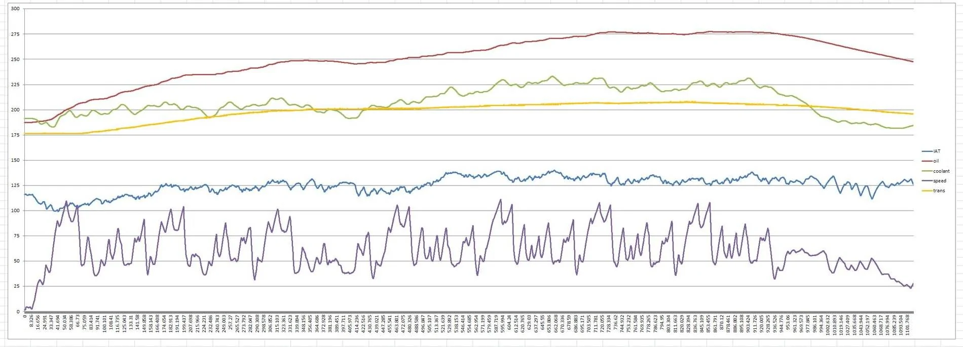

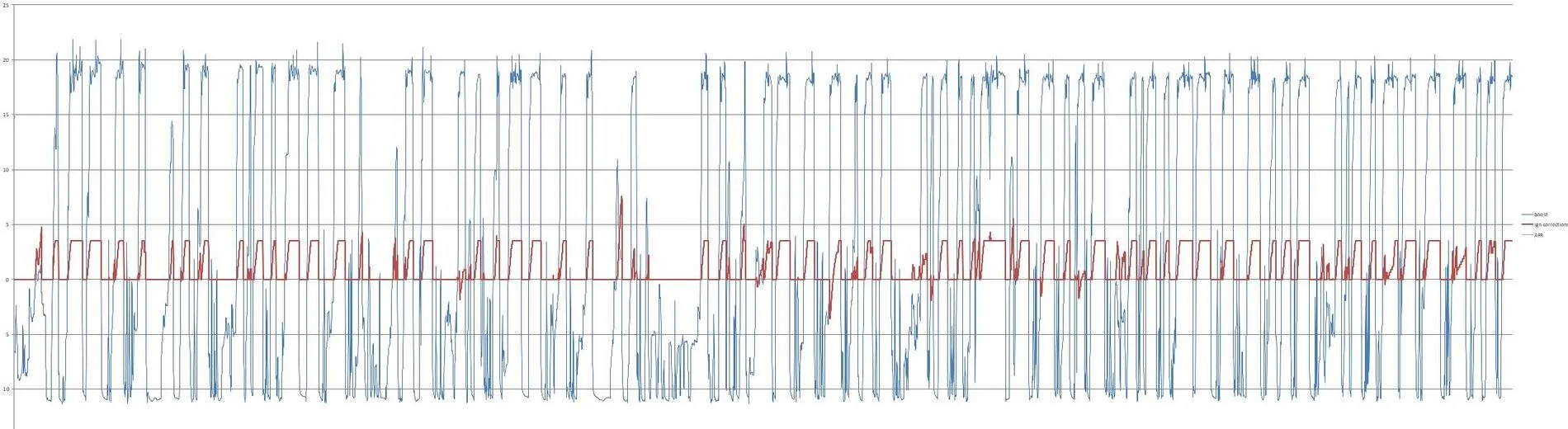

went to a track day yesterday and datalogged two 20 minute sessions on my accessport keeping track of temps, which 1 session contained over 15k datapoints. i was able to run cobb OTS stage 1 91 octane tune all three sessions on 93, normally i run stage 2 93. Air temp was 73. attached are boost/ign corrections , and another for temps. Never got any warning lights about temps, is that the nature of a slower ecoboost? Also the trans temp seemed pretty stable, but that is probably a result of running about 270hp, and my car came with a trans cooler. was running defrost to varying levels. 5W-50

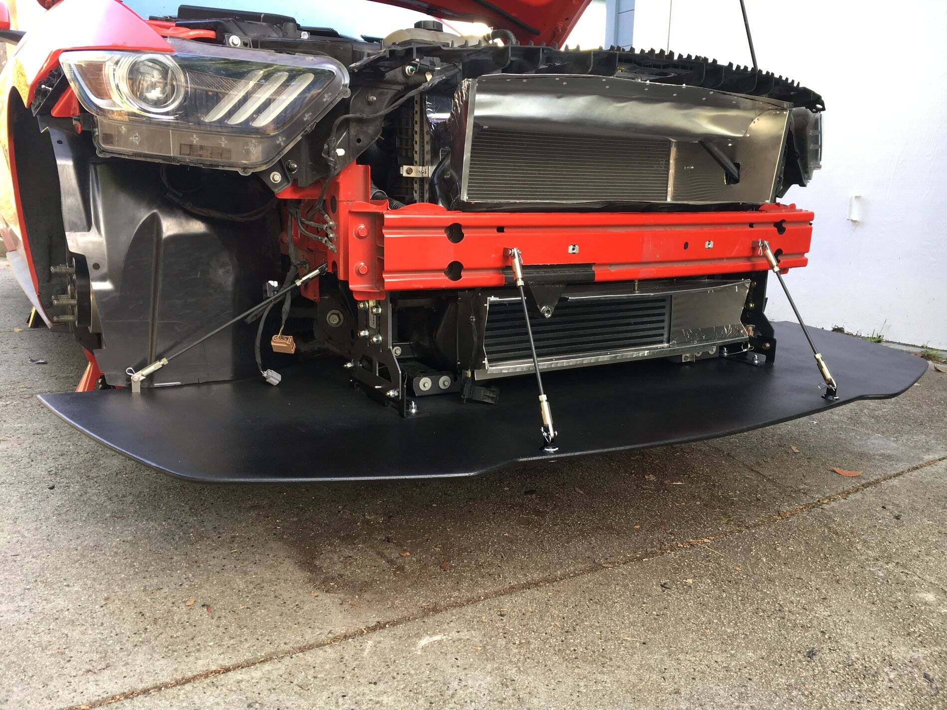

Is that total correction or one cylinder? With these motors so octane dependent and seeing some pretty big meg corrections I got to the point where I would add about 20% race gas just as a safety buffer while running my 91 tune. Cheap insurance. Doing this I would get usually max -2* corrections on a single cylinder.
Those oil and coolant temps are as high as you want to see and ideally both should be about 20* lower than that IMO.
I ducted my radiator and intercooler and it dropped my peak coolant and oil temps 20* and 15* respectively.
