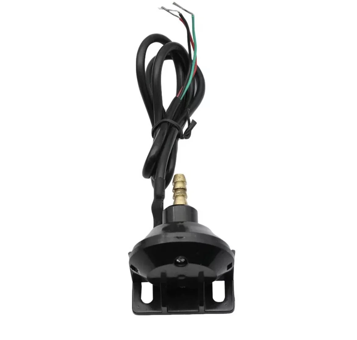

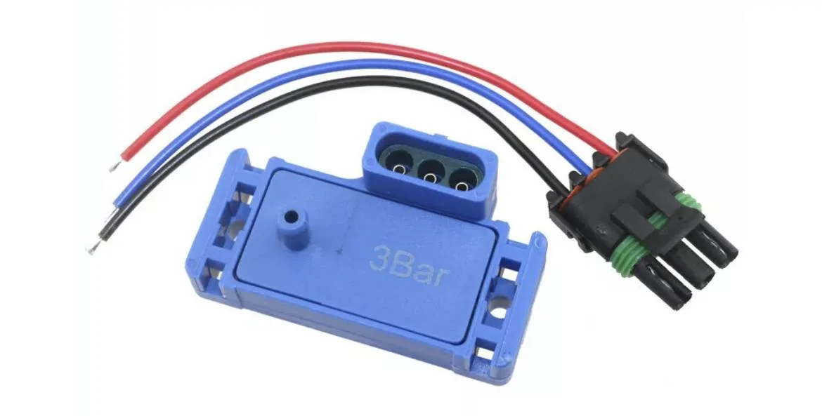

With an RTD and the pro features, is there a pressure sensor I can use to log boost? My gauge doesn't have an analog output (snow).
Jackson1320
Sep 26, 2019
3,057
1,228
California
Jaxson
2015 mustang gt
Pretty much any pressure sensor. there are these ones on eBay. a GM map sensor will work
